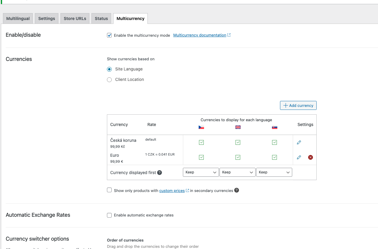

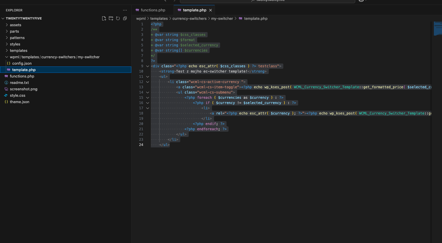

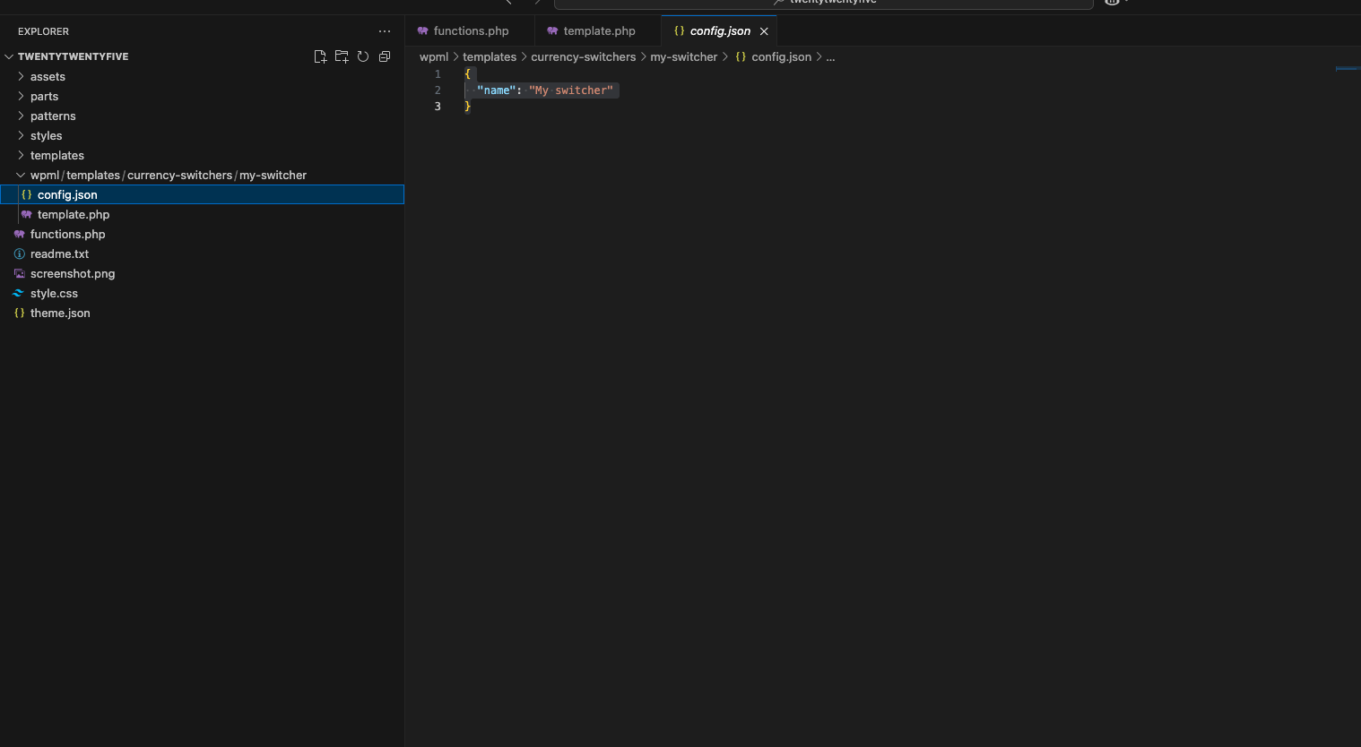

I am trying to implement a custom currency switcher template for a site under development. I followed all instructions from the documentation at https://wpml.org/documentation/related-projects/woocommerce-multilingual/designing-custom-currency-switchers-using-template-files/. I tested it in a custom theme and also in the Twenty Twenty-Five theme.
The currency switcher is not appearing and is probably not registered by WPML. I have checked multiple times every step in the documentation, and the multicurrency setting should be okay.
How I can make it working?

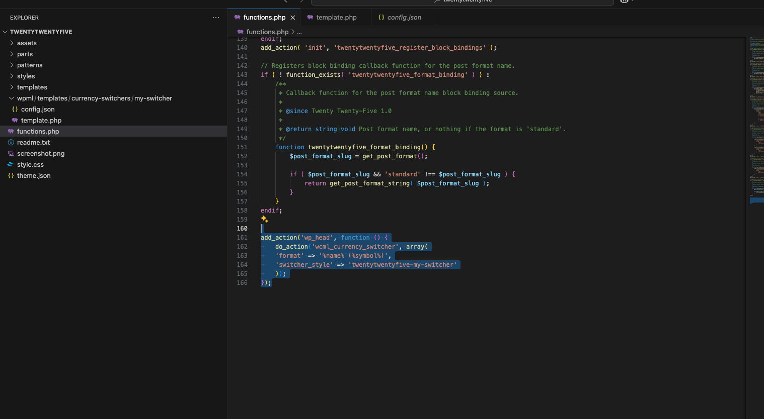

of course I tried also classic currency switcher.
do_action('wcml_currency_switcher', array(
'format' => '%code%',
'switcher_style' => 'wcml-horizontal-list'
This echoes currency switcher, that works.
I understand, but you have in a documentation possibility to use custom templates. Rather than just modifying CSS of pre-defined switcher I would like to add some classes there.
Thank you

If you only want to add extra HTML classes (or a wrapper) and don’t need a fully custom template folder, you can keep WPML’s built-in switcher and wrap it (or pass classes via the switcher_style parameter). No template files are required.
 * Place this where you want the switcher to appear
 * – e.g. in a template part or a shortcode callback.
echo '<div class="currency-switcher my-extra-class">';
do_action(
		'format'         => '%code%',          // shows only the code; change to %name%, etc.
		'switcher_style' => 'wcml-horizontal-list', // any of WPML's built-ins
echo '</div>';
Everything inside the wrapper keeps WPML’s JS behaviour because the output still contains the mandatory wcml_currency_switcher class that WPML prints automatically. You’re free to target .my-extra-class (or any additional class you add) in your CSS.
