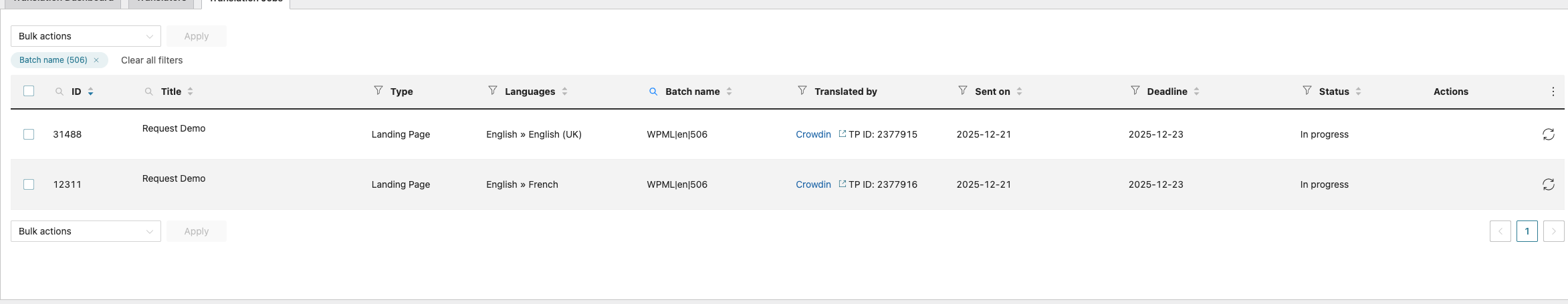

December 21, 2025 at 5:14 pm #17680732
shaharH
Here’s an example of a job where you can see that the string is included in the source.
In the meantime, we’ve built a custom solution: we add an “=” before every field that starts with “/”, and then remove it in Crowdin in order to avoid this issue.
December 22, 2025 at 4:41 pm #17682975
Marcel
Thank you for sharing the example of the jobs that are affected.
We investigated job 2377915 and reviewed the original XLIFF file that WPML sends to the Translation Proxy (TP). Based on the attached file, there is no text that starts with “/”.
To ensure we’re all looking at the same data, could you please check this hidden link and confirm whether the content you expect to be translated is actually present in the file?
