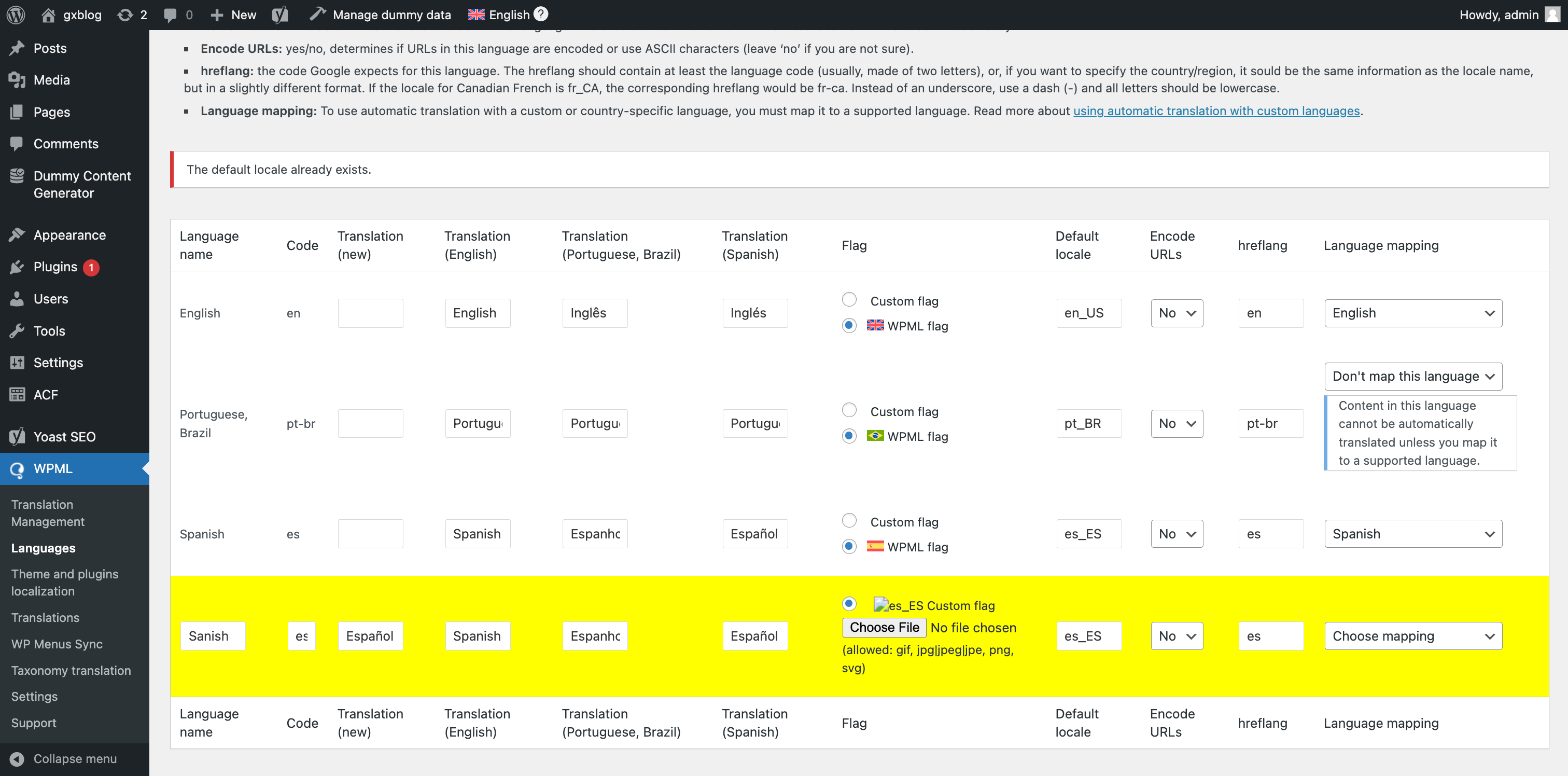

Sorry guys, but I have to question something again. I closed a ticket because I changed my mind, but now I am not sure if my decision is the best solution. I am going to be concise this time.
My old/actual site has this type of urls for translated content:
Note that the language code is /es_ES/ and not /es/
I don't want my actual urls to be lost or 404. What do you recomend?
1. Redirect all /es_ES/ to WPML /es/ or
2. Create new languages, that will use my actual/old site languages codes?
If you recommend me solution 1, how do you recommend me to do redirects? with htacces rules, or by using WordPress native redirect functions, such as redirect_guess_404_permalink()? source: hidden link
If you recommend me solution 2, what should I set on the default locale? Currently I get "The defaul locale already exists".
Question? Why is so difficult to change the code?
Nope.
Nope.
Is a developing site.
Thank you, and sorry for arising this question again. It is an important decision that will last many years!

I have carefully reviewed your request and believe you need to decide. However, I would like to provide you with some helpful information.
I understand that you are currently using the language code /es_ES/. With WPML, you can utilize a pre-defined language with the code /es/ or create a custom language.
To create a custom language, you must change the default locale for the pre-defined /es/ language to something else. Once done, you can use the locale es_ES for your custom language.
If you decide to use the language code /es/, it is recommended that you set up redirects. Unfortunately, the WPML GUI does not have any tools for this. You must use custom functions, such as adding them to the server side (e.g., the .htaccess file), or employ a redirection plugin.

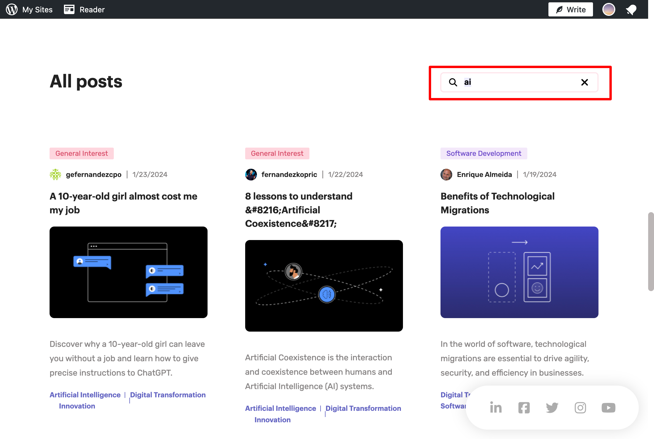

Andrey, one more important question that I just thought about. We are using WordPress API to fetch posts. I was told before buying this plugin that WPML works with translations over API calls. Does it work as well with custom languages? This is a fundamental feature on our blog.
If you would like to see how we use it, you can go to the homepage, search for "All posts" and search for anything:
you can try searching for "ai".
Thank you.

Thank you for your feedback regarding language codes. If the code /es_ES/ is working for you, it would be OK to leave it as is. However, the code /es/ looks more pleasing.
Ensuring you have set the correct Default locale and hreflang for your language is essential.
The default locale refers to the locale active for your language when loading GetText translations. This means that WordPress, plugins, and themes' standard translations will be loaded by locale, not just for the admin.
Hreflang refers to the code that Google expects for your language. The language tag should contain the same information as the locale name but formatted differently. For example, if the locale for Canadian French is fr_CA, the corresponding language tag would be fr-ca. Instead of an underscore, use a dash, and ensure all letters are lowercase.
If you choose the predefined language code /es/, you do not need to do anything about the default locale. However, if you are creating a custom language and want to use the locale es_ES for your custom language, you must first change it for predefined (for example, es_ESS) since it already exists. WPML does not allow the use of existing locales for custom languages.
For more information, please visit https://wpml.org/documentation/getting-started-guide/language-setup/editing-wpmls-languages-table/#language-configuration-fields-defined.

Andrey, thank you very much for your detailed response. After some trying , I decided that I am using default WPML languages, and using pre_redirect_guess_404_permalink() wordpress core filter, to redirect my users if they type an old url /es_ES/ to my new url /es/. This solution is more elegant and much more simple than creating three custom languages. Thank you very much for your time. I didn't marked this as resolved, because I wanted tell you this, and thank you for your time and patience.
