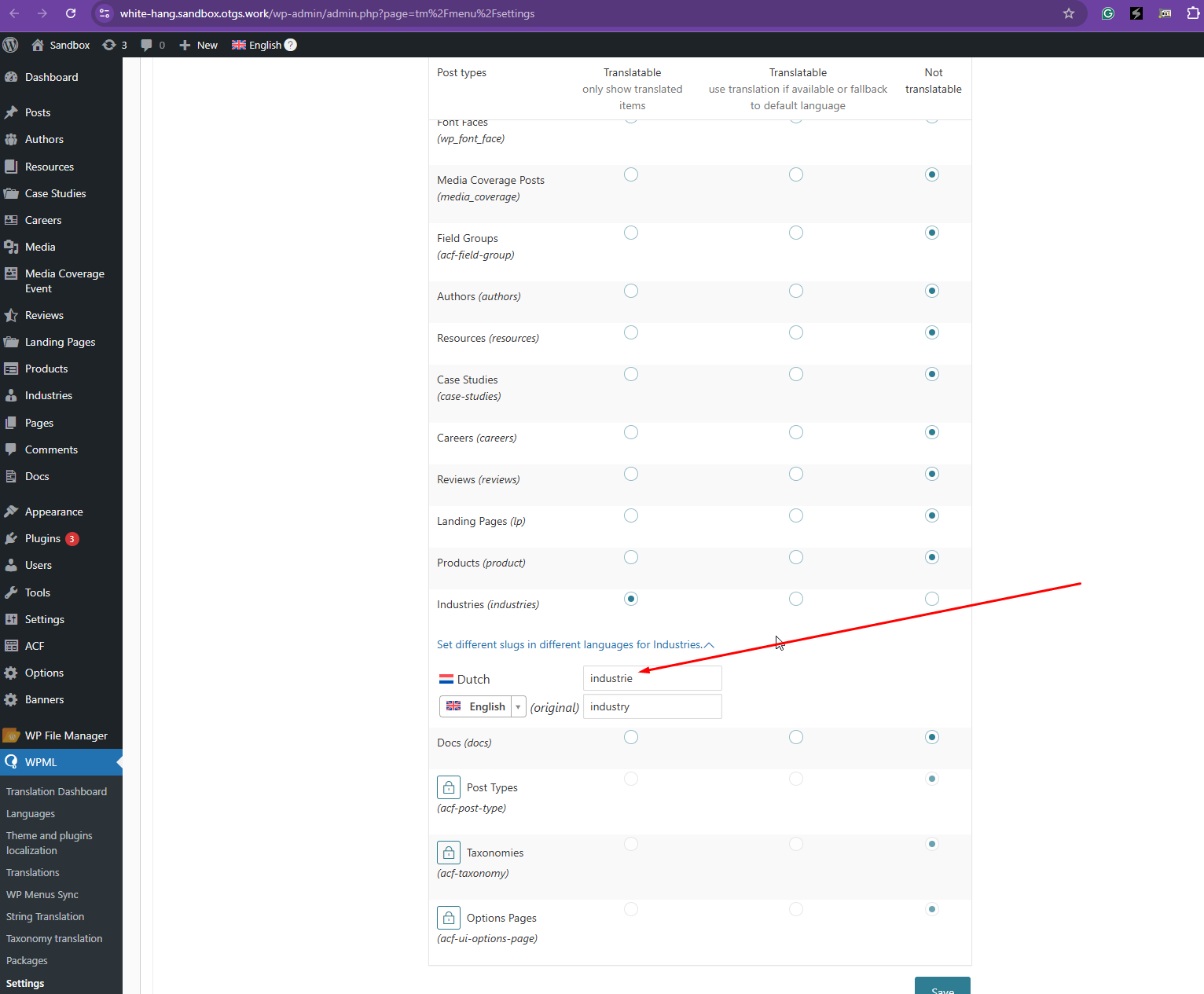

We've followed the guide here & looked for any other info available but our custom post type slugs for 'industry' aren't translating - they remain as 'industry' in all languages.
https://wpml.org/documentation/getting-started-guide/translating-page-slugs/
Are you able to assist? I cant see any mis-config with the current setup and we have another post type 'Resources' for which the translations for the slugs are working.

February 27, 2026 at 6:28 pm #17860960
Thanks for your patience. It seems to work fine on our sandbox site here hidden link .
Check out the Dutch language slug here hidden link and compare it with the primary language English hidden link
I'm able to translate it here in WPML > Settings > Post Types Translation as shown in the attached screenshot. Could you check and see if I've left out any configuration to replicate the issue?
