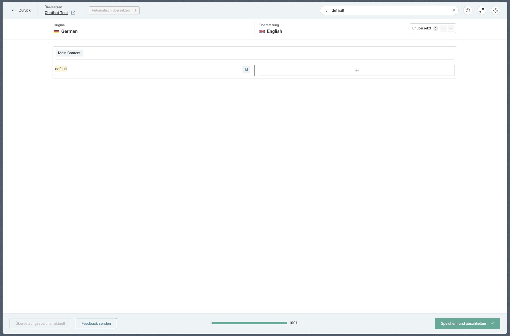

Thank you for waiting. I checked the post you mentioned and noted that the value only appears when being directly searched for, inside ATE. Check the image attached.
By searching them, you can add the value and thus translate it 🙂

October 7, 2025 at 6:56 am #17462439
robinV-30
Gotcha, that is working. Maybe you could add a toggle in the ATE to list custom shortcodes.
When I search for ws_form nothing appears which is confusing.
