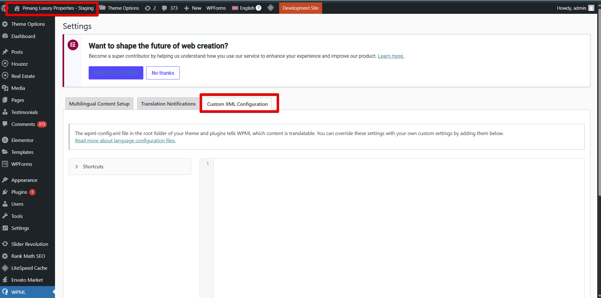

August 28, 2025 at 7:08 am #17353512
teng-huatN
FYI, I have another new website staging.penangluxuryproperties.com which I set up the wpml. This site also uses Houzez.
The custom xml config page is able to load.
August 28, 2025 at 7:18 am #17353562
teng-huatN
I also tested by changing to a different theme.
With the new theme Twenty Twenty Five, the Custom XML Config page was OK.
When I activated back the Houzez theme, it did not work.
