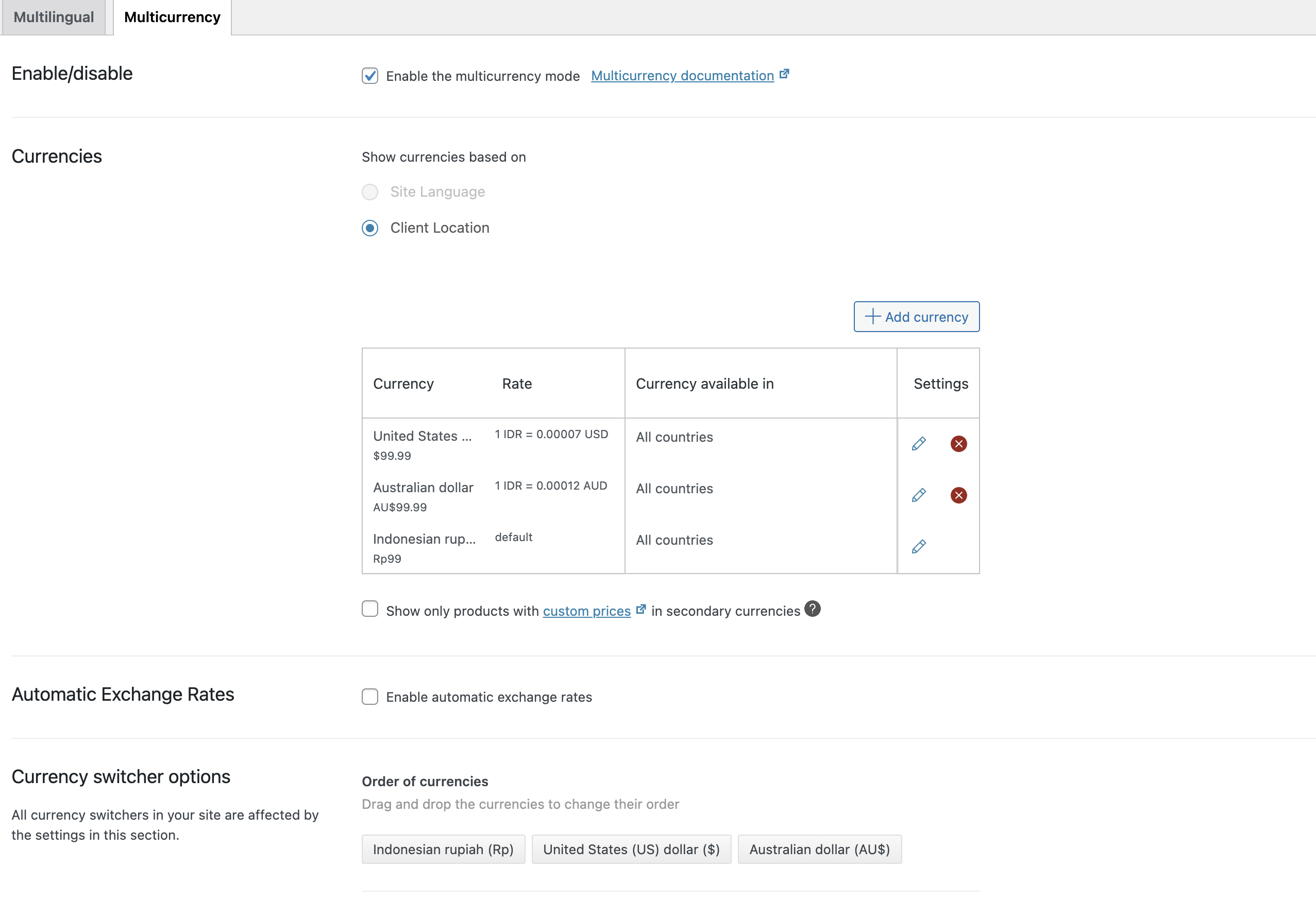

Another issue Im running into is that the default currency for someone who visits my site for the first time is always USD. It doesnt matter if I use an incognito browser or a normal browser.
How can I force the use of my base currency IDR for first visitors at all times. Then if they want to change the currency to smt else thats fine.
Can you explain why it always uses USD.
I have my woocommerce setting now changed instead of geolocation to shop region/country, but that didnt change it. Also I dont see an option in the WCML settings to force IDR to be the default currency.
I have also tried adding some php code that forces the wcml_client_currency cookie to be set to IDR, but that doesnt work on first pageload, only when navigating to the next page the currency changes into IDR instead of USD.
Weird behaviour, how would I be able to fix this?

Can you please provide me with a screenshot of your multicurrency settings?
July 24, 2025 at 7:53 am #17266292
kasperv-6
Sure

Can you provide me with a link to check? I don't see the currency listed if I go to hidden link which is the site you provided debug info for.

I tried to reproduce the issue hidden link, but it works fine.
Could you please check if I'm missing something? If not, it might be related to your site's configuration, possibly still to cache if it's fixed on 2nd pageloads.
