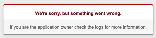

Edited the translation, pressed save, then got this error (see screenshot)
Checked server logs and ATE Error Logs and nothing recorded
Tried again with the translation and experienced the same - the updated version didn't display.

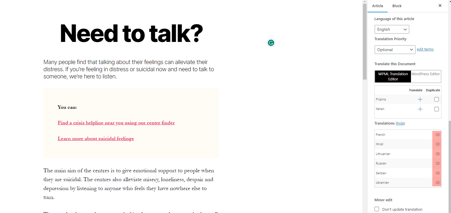

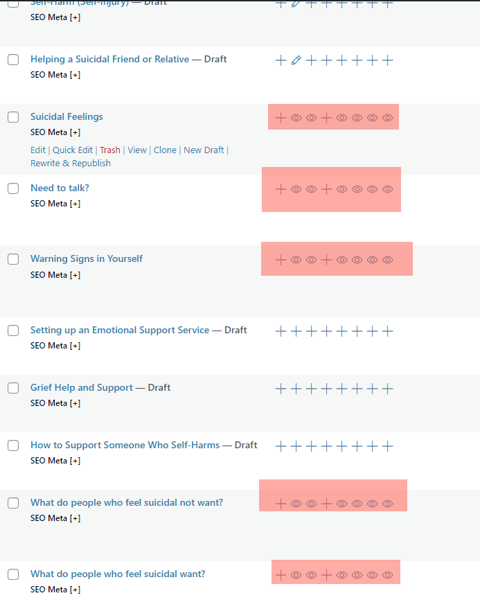

Thank you for the details. I had a few rounds of testing on your staging site. Please check the attached images. Most of the post translations are in review mode, including the following one.
So as part of testing, I created the following post and updated the translations(French & Serbian) a few times. It works fine for me.
