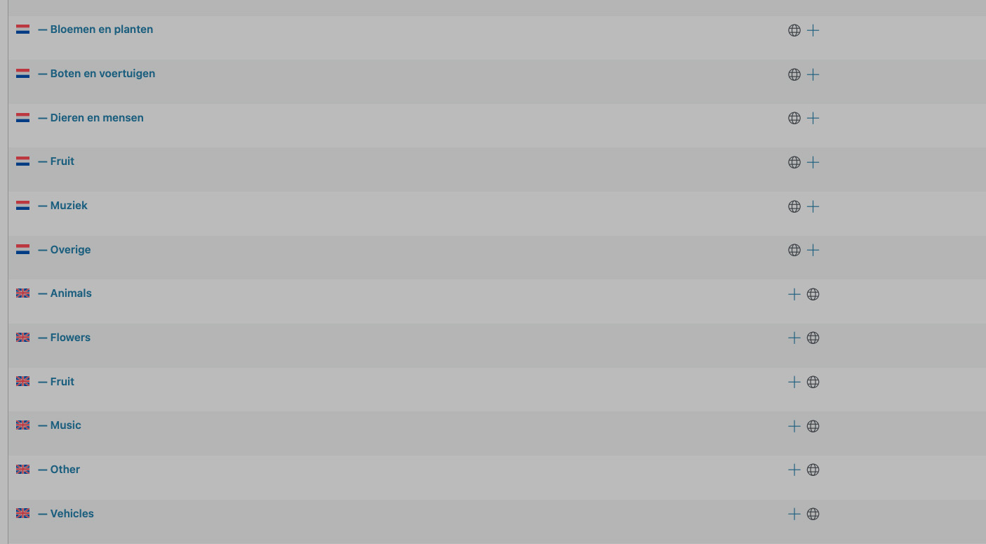

I have transfered a webshop to a testserver, back to a new one. Now What I found out later is that some taxonomies seem to have their base in English. This should have been Dutch. Because of this I have disconnected taxonomies that actually should be connected, but now cannot.
In the screenshot you see the issue. They are not connected. How do I solve this?
Seperately they work fine, but the language switcher does not work as you can imagine.
Can you help me out?

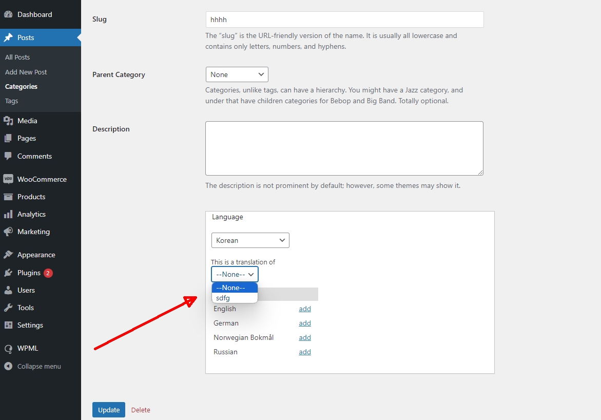

Did try by opening taxonomies and then use "This is a translation of"?
Bruno Kos
February 25, 2024 at 1:33 pm #15341393
boyv-3
Yes this helped!
