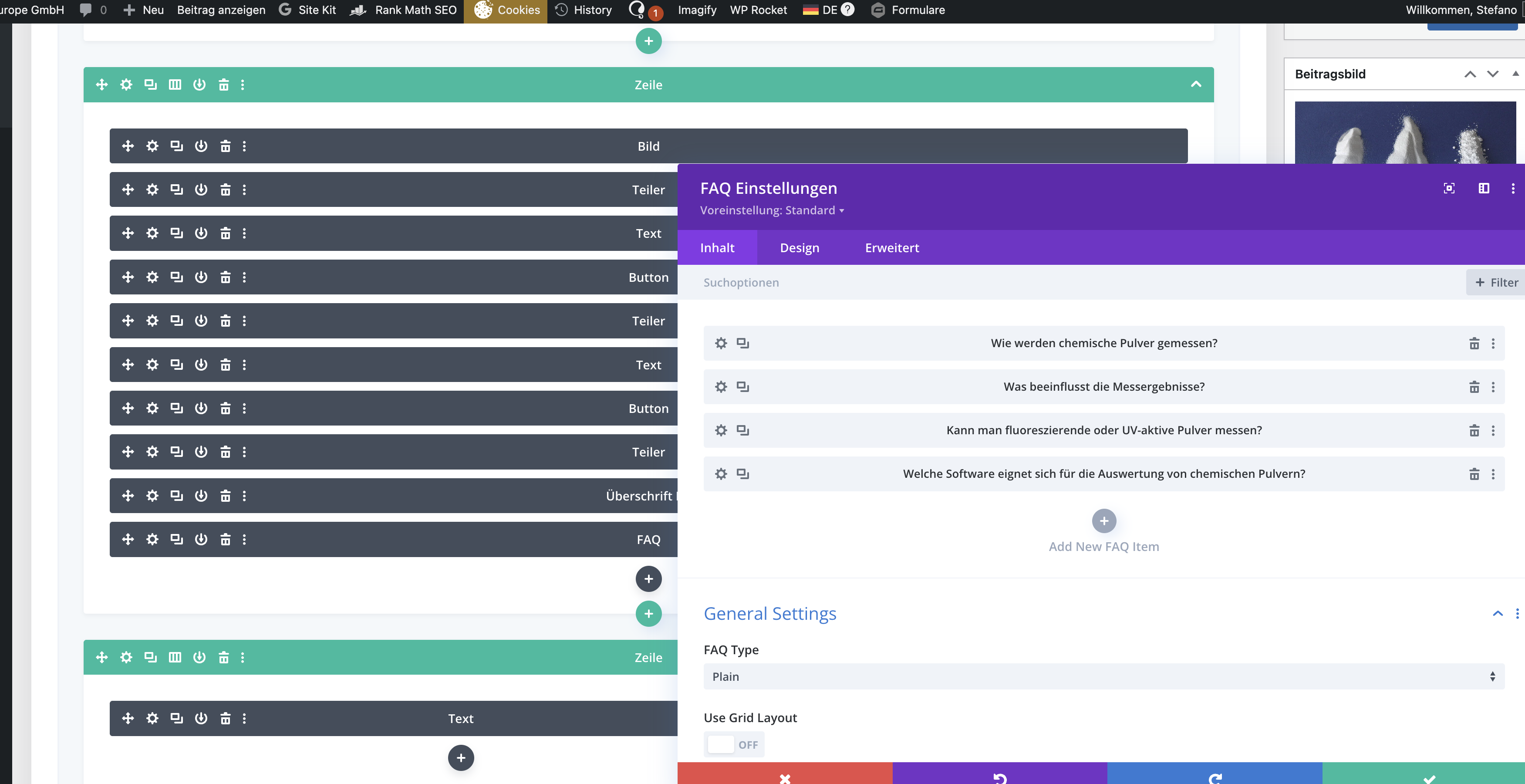

I am trying to use WPML (Pro) with Divi and the Diviflash plugin, specifically the FAQ Module (difl_faq / difl_faqitem). I want the FAQ titles (questions) to be recognized by the WPML Translation Editor. I have already tried defining the modules in the Custom XML Configuration. The issue can be seen on this page: hidden link

The FAQ answers are correctly detected by the WPML Translation Editor, but the FAQ titles (<h3 class="faq_question_title">…</h3>) are missing.
Why are the FAQ titles not showing up for translation in the WPML Translation Editor?
How can I ensure that the FAQ titles are recognized by the WPML Translation Editor?
