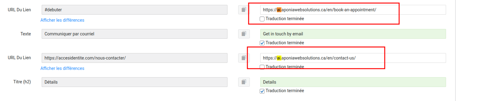

We moved ai.aponiawebsolutions.ca to a new domain as it is now ready to launch. The website is now on accesidentite.com However, when we update translations, the old domain is still showing up. We did a database search and replace, cleared the cache in troubleshooting, and regenerated the mo files as well to no avail.

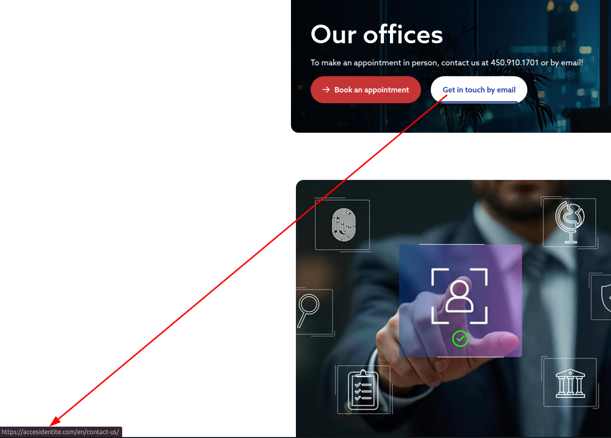

I've added 3 screenshots, to show you what happens, in order. In 1.jpg, we can see that the translated page has the correct link. In 2.png we go to update the translation of that page. In 3.png, we see the domain is now hidden link for the same link i nstead of hidden link.
It's as if the translation has some memory that is not in the DB. Does it remember the license was activated on the old website? That would be weird as we reactivated the license on the new website as well.

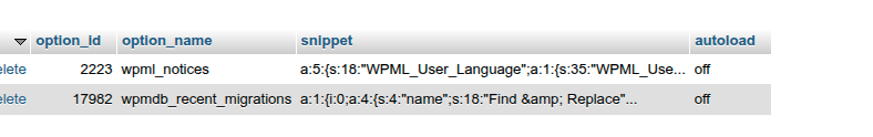

Unfortunately did not work. I tried a few kinds of Search queries but none of them returned results for "aponiawebsolutions", only 2 in wp_options (Serialized data for notices from WPML from when the website was on the web server), and 2 others in an SEO plugin.
