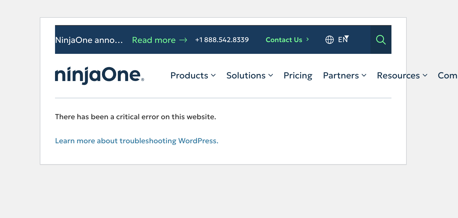

I was trying to update WPML to version 4.7.4, but after the update, we encountered a PHP Fatal Error. We experienced this error with Elementor version 3.27.6 and Elementor version 3.28.4. We have a private environment where the error can be seen. If you'd like access, please let us know. Link to a page where the issue can be seen: hidden link. PHP Fatal error: Uncaught TypeError: Cannot access offset of type string on string in /wp-content/plugins/sitepress-multilingual-cms/addons/wpml-page-builders/classes/Integrations/Elementor/Hooks/DisplayConditions.php:138
After updating WPML to version 4.7.4, we observed a PHP Fatal Error: 'PHP Fatal error: Uncaught TypeError: Cannot access offset of type string on string in /wp-content/plugins/sitepress-multilingual-cms/addons/wpml-page-builders/classes/Integrations/Elementor/Hooks/DisplayConditions.php:138'. The full stack trace was provided.
How can we resolve the PHP Fatal Error after updating WPML to version 4.7.4?
Is there a compatibility issue between WPML version 4.7.4 and Elementor versions 3.27.6 and 3.28.4?
