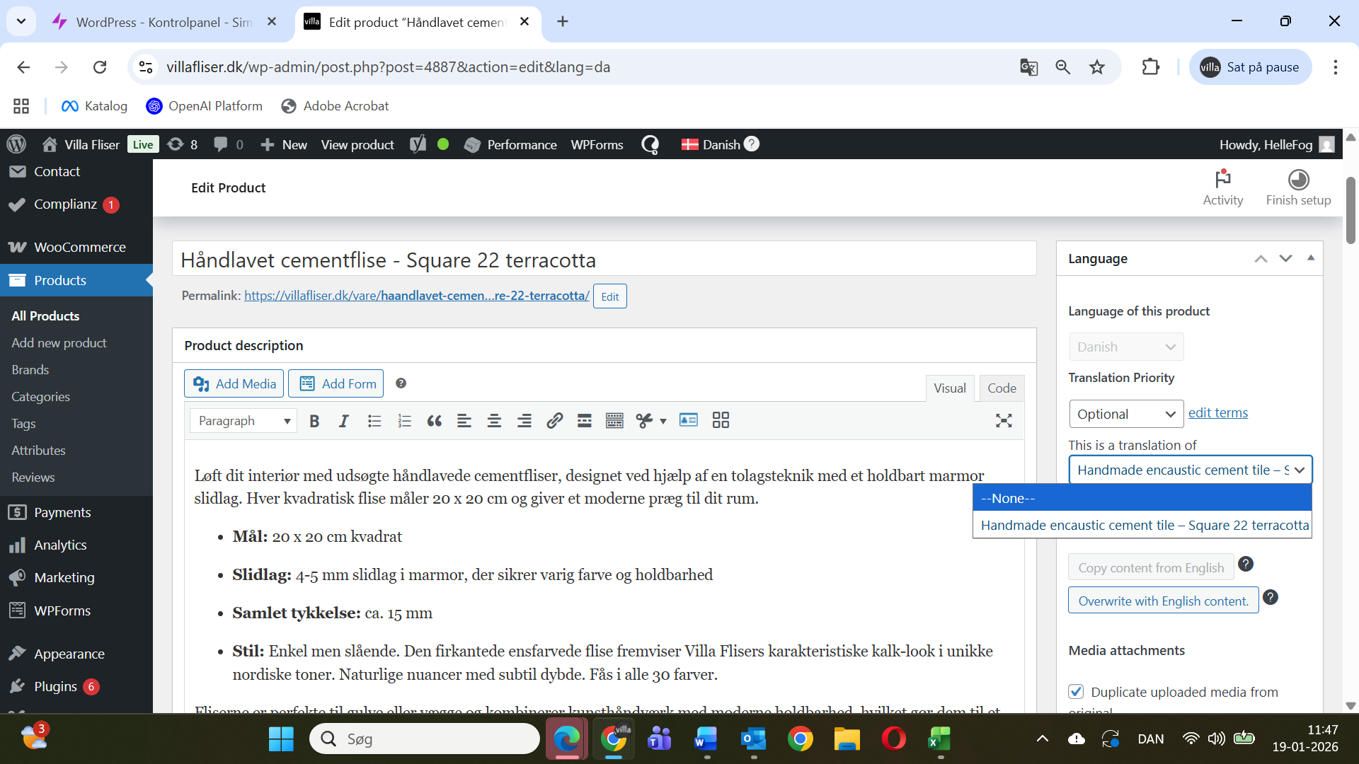

When I made the mistake to disconnect the relationship between EN and DA - I used the settings panel on the right site within products - where it says "this is a translation of" - here you can choose "none". That was what I did - and you can find a screenprint attached.
Well, after some time waiting for your response, I chose to try some things out to undo this "none" setting. I chose "connect to a translation" (or similar) in the same panel (right side in products) - at the top. I found the English products - and as it seemed to work, I chose to do this for all 148 products. That works - the prices are ok again on the danish site and the translations have not changed - it seems.

I was able to better understand the issue now - thanks for clarifying. First and foremost, please ensure to create backups regularly, specially after making progress just like you did.
I understand this process can be confusing. Again, please ensure to have a backup before proceeding.
"Can I disconnect them again with setting to "none" and then connect them again. Or am I just creating a bigger problem? "
Yes, that's the best solution here. Disconnect them, so you can reconnect them to the correct default language product.
The consequences of setting to "none" are actually simple. Since WPML allows you to create products in any language (default or secondaries), the products set to be the translation of none, are stand alone products on your secondary language. That only means that they're not set as a translation of another product.
