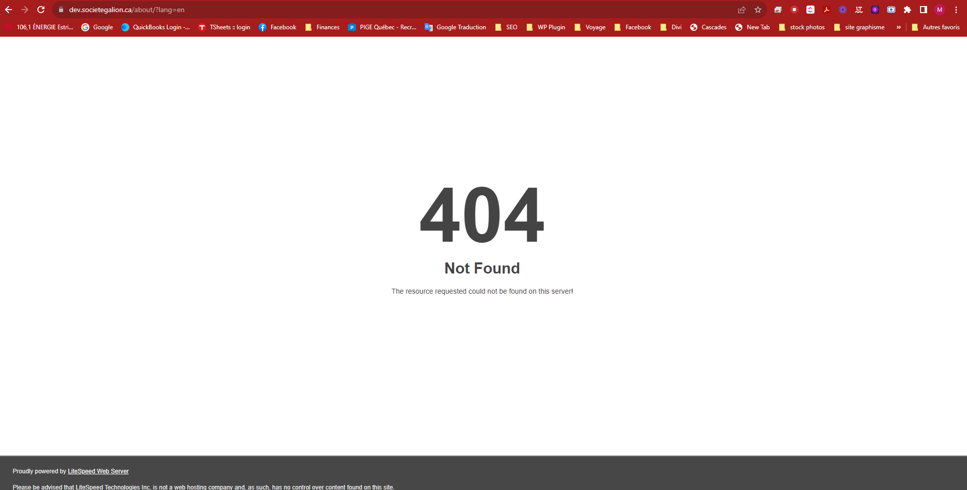

Can you see the problem ? If you go on this link, we get a 404 : hidden link
These are my error log :
2023-08-30 03:30:53.924511 [INFO] [2231] [T0] [3.232.50.116:14891#APVH_www.dev.societegalion.ca:443] [RECAPTCHA] Reason: WP Protection.
2023-08-30 09:13:46.615846 [INFO] [2231] [T0] [108.171.94.126:63099-H3:451EA46E20FCBDA7-148#APVH_www.dev.societegalion.ca:443] File not found [/home/societegalion/domains/dev.societegalion.ca/private_html/en/index.php]
2023-08-30 09:13:46.616006 [INFO] [2231] [T0] [108.171.94.126:63099-H3:451EA46E20FCBDA7-148#APVH_www.dev.societegalion.ca:443] File not found [/home/societegalion/domains/dev.societegalion.ca/private_html/404.shtml]

September 5, 2023 at 10:38 am #14343101
marie-hélène Archambault
Yes, I have to go in the admin everytime, save permalink again and it work back. No, I don't know what's making this error. I only see the error log like this.

September 5, 2023 at 12:35 pm #14344309
Once the issue occurs again, please connect to the server and have a look at the htaccess file in order to verify if this is the issue that is affecting your site:
https://wpml.org/errata/htaccess-is-rewritten-with-language-folder/
If you can confirm that Rewrite Base is overwritten with the language folder "/en" instead of simply "/" then you should apply the workaround from the errata.
