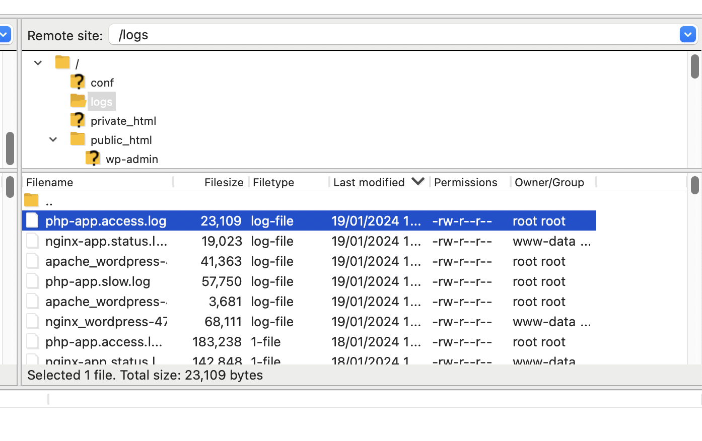

January 19, 2024 at 9:34 pm #15206400
cedricP-6
Hello Bruno,
Is it possible to extract it by yourself if I provide you the SFTP access please?
If not, which log file out of the 2 dozens I attach to this message do I need to provide you with?...
Let me know, thanks.
January 22, 2024 at 7:16 am #15209549
Bruno Kos
Is there a file called error.log or the one with "error.log" within the name, as that would be typical name for Nginx and Apache error logs?

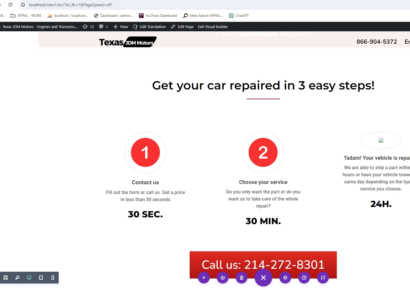

January 24, 2024 at 2:09 pm #15222244
Bruno Kos
I was able to get his working on my localhost after completely disabling Redis as I got:
[24-Jan-2024 09:22:10 UTC] objectcache.critical: Failed to initialize object cache: The `WP_REDIS_CONFIG` constant has not been defined. If it was defined, try moving it closer to the beginning of the `wp-config.php` file. For more information see: <em><u>hidden link</u></em>
[24-Jan-2024 09:22:10 UTC] objectcache.warning: Failing over to in-memory object cache
Can you disable Redis (or clear it) on your site and try then?
