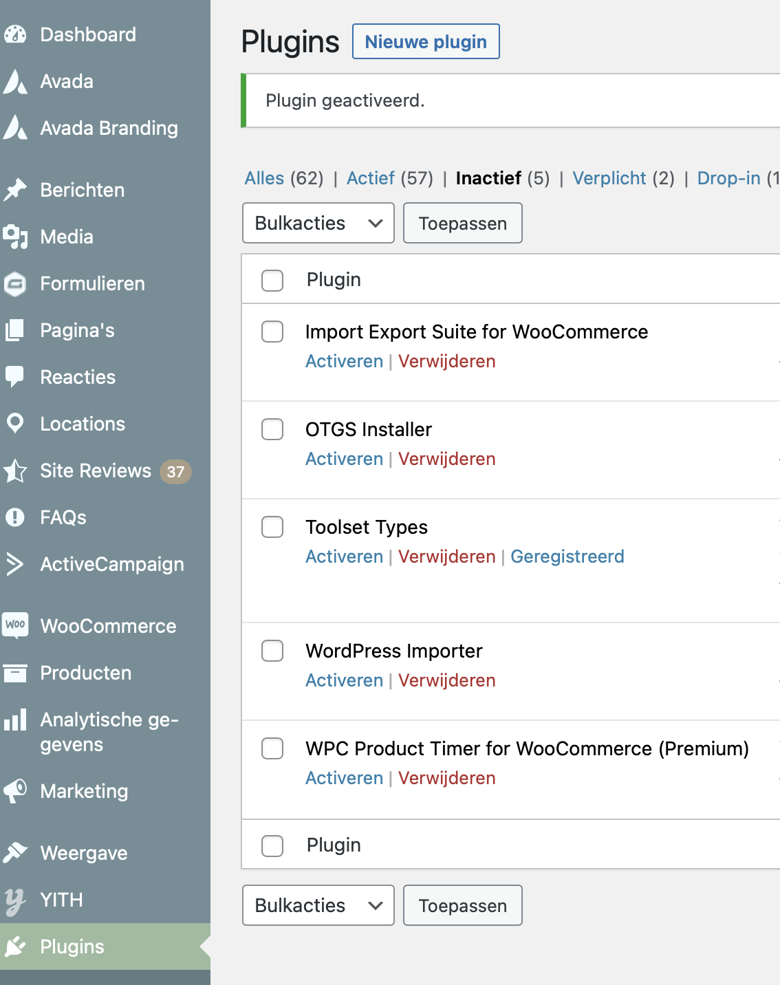

In the production website I deleted Yoast premium (free Yoast still running). It does not solve the activation issue of your plugin (see screenshot attached).

1) no getting OTGS plugin activated.
OTGS is working fine when I checked and there is no need to upload the OTGS plugin again. Check out this link hidden link

1) working with the sandbox website required you to do some tricks with Yoast. This is not an issue in the production website. Solved.
2) installing OTGS installer not needed - although activation is an issue still. Since I directly download from WMPL there's no direct issue - although it indicates a conflict somewhere in the database. Solved.
