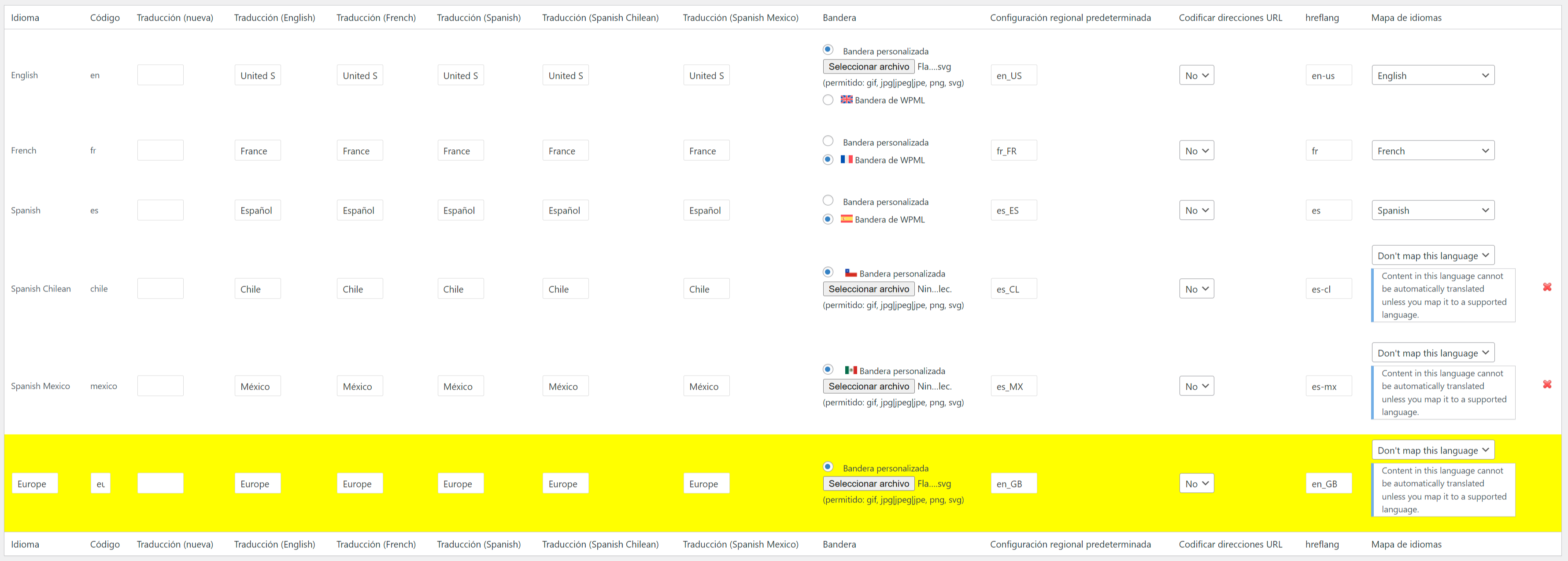

Im trying to add a new custom language (Europe). I have US English, so I'm following this guide https://wpml.org/errata/how-to-add-english-united-states-as-a-custom-language-to-use-as-default-or-translation-language/
When I try to create it, it shows me "Error adding a new language". Here you can see a screenshot of my custom language config before hitting "Save".
Either setting hreflang and regional config to "en" wont work.
Regards

1) Could you please tell me what is the code that you are using for the language you want to add, as I am not able to check it properly from the screenshot?

I used "europe" as code. I thought it didn't have to be ISO 639-1 related codes.
I will check part 2 tomorrow.
