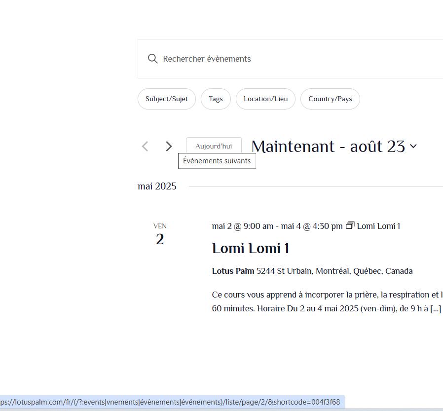

I am trying to resolve an issue on the event calendar on the French side of my site. When we do a query, search, or change the date on the calendar in French, the calendar gets stuck in a loop: hidden link. However, changing the date on the calendar view in English works fine: hidden link.
I see JS errors in the console on the French side. I suspect that WPML is translating a URL for a script (maybe adding a /fr). The calendar in french can't load content once you make a query (search, use pager, change the dates).

This is possibly the same issue as
https://wpml.org/errata/the-events-calendar-incorrect-link-format-with-custom-slug-translations/
Can you try this workaround? Because I see the same wrong pattern in the URL, so the filter wants to use that invalid URL, causing the issue.
