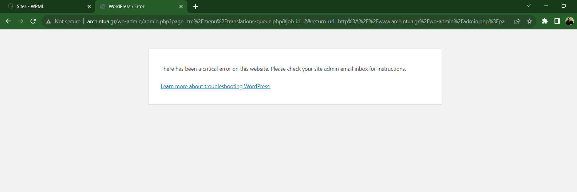

New update:
With only WPML installed, I finished the WPML configuration (added English as 2nd language to my site - the main language is Greek), chose manual translation and added my account as the translator.
I tried to translate the Main Page, but when I pressed the "Translate" button I got the error you can see in the grab below

Thank you for the update. If you want to translate the ACF Fields, you will need the String Translation plugin.
However, to understand what caused the Fatal error while activating string translation and translating a page, I checked the debug log and found that the mb_ereg_replace_callback() function is undefined. It means that a PHP Extension, which is MBString[ hidden link ] is also not active on your server.
As mentioned here[ https://wpml.org/home/minimum-requirements/ ], the Multibyte String extension is required to make the String Translation plugin work. So, kindly activate this extension on your server. I hope the issue will be solved after that.
Please let me know the update. I will be happy to help if you need further assistance in this matter.

Hello Prosenjit,
I installed the required php extension and the Translate button now works!

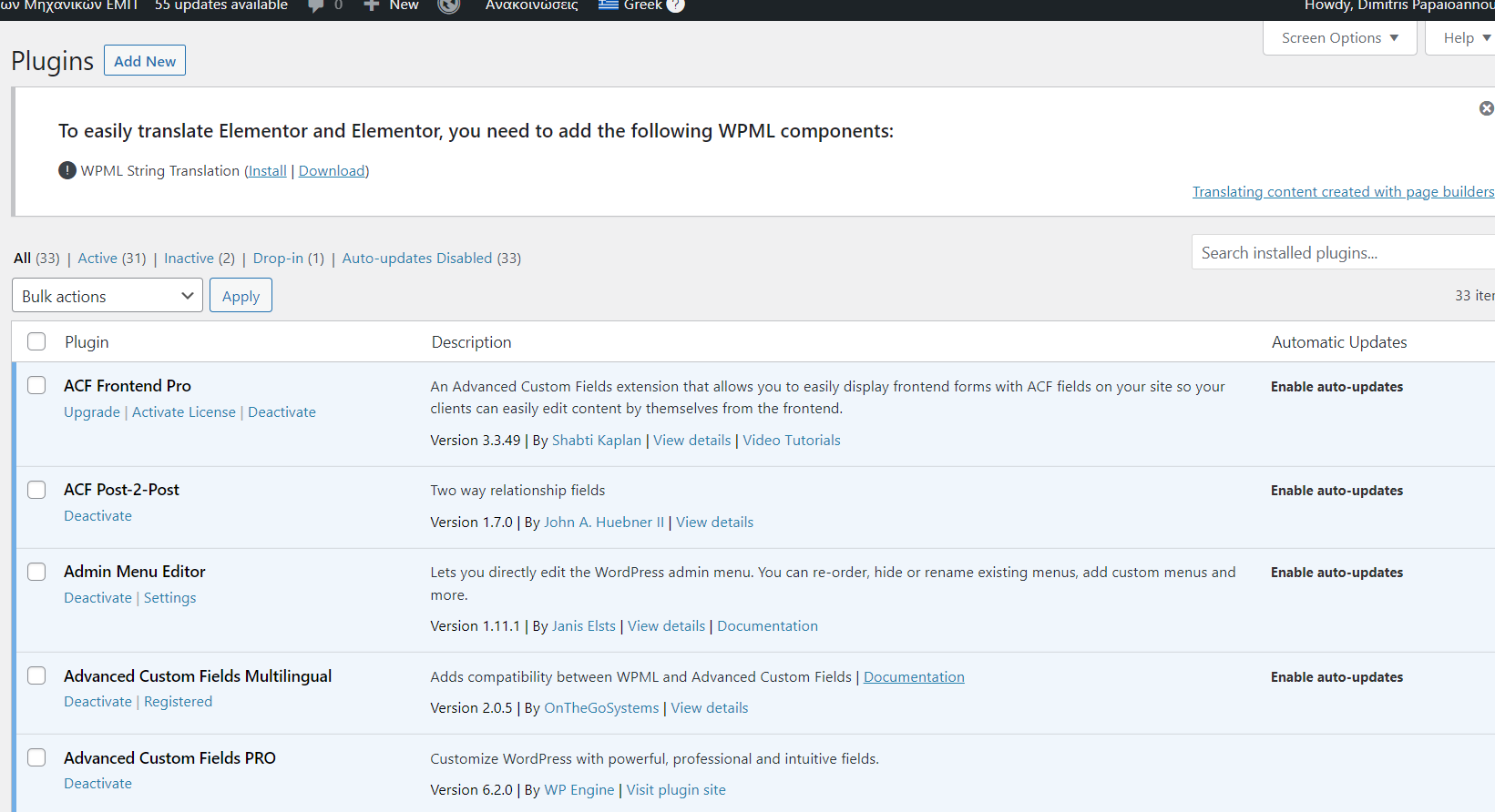

Latest update:
There might be something wrong with the string-translate plugin, as it is activated, but there is a message at the top saying that I need to install it!!!
I did not try to do anything, please make sure everyning is OK.
Dimitris

Regarding the issue with String Translation- I rechecked your site properly but couldn't find the message to activate the string translation plugin in the Plugin section or any other part of the dashboard. Since the string translation is active on your site, the message you noticed might be a result of caching issues. If any server-level caching, especially, object caching is enabled for your site, please clear them and check again.
If the String translation plugin working correctly, you can simply ignore this message by clicking on the close icon on top of the message.
