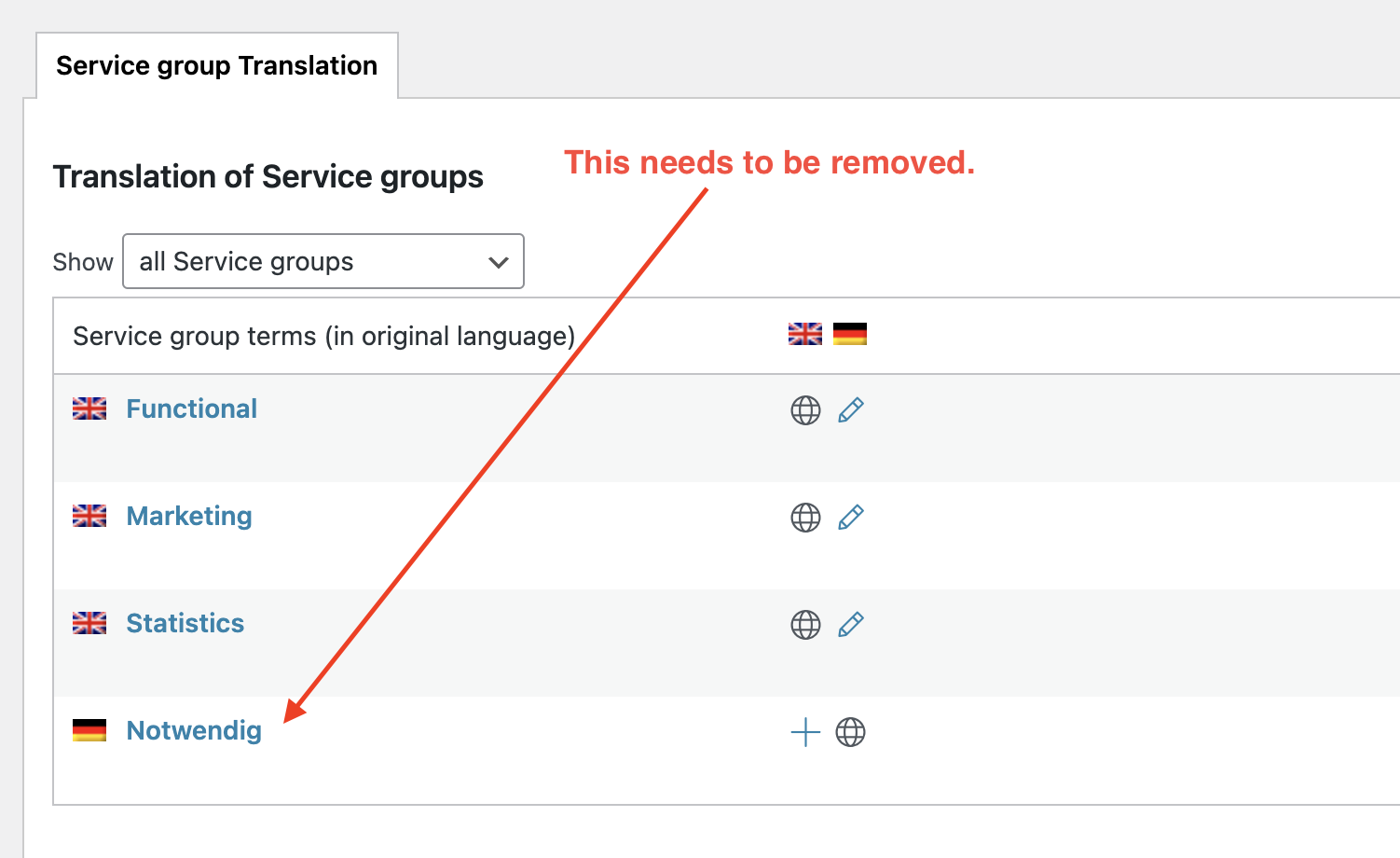

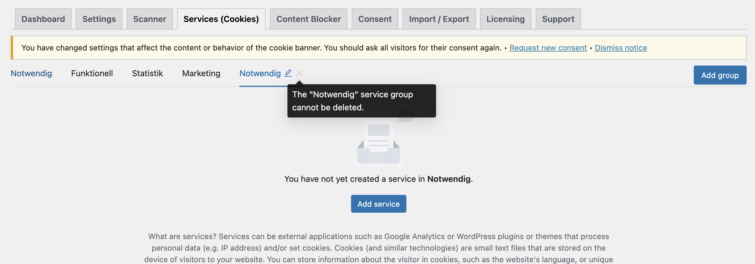

Yes, I am now able to translate the essential term shown in WPML -> Taxonomy Translations. However the old Notwendig (translation of essential) still remains. And, there is no option to delete the old Notwendig.
I was able to set up new German translation for the English Essential category and the respective services within it. But I need to delete the old Notwendig. Please see the screenshot below

Lauren
You may need to ask the plugin author how to best remove the essential term, because the plugin does not allow the essential term to be deleted. The same thing shows in English. However, you can try removing it manually from the database if you have access. Just be sure you have a full backup of your site before removing or making changes. THen, you could run a search on your database for the term and the one with the lower element ID should be the first one that you created manually.
