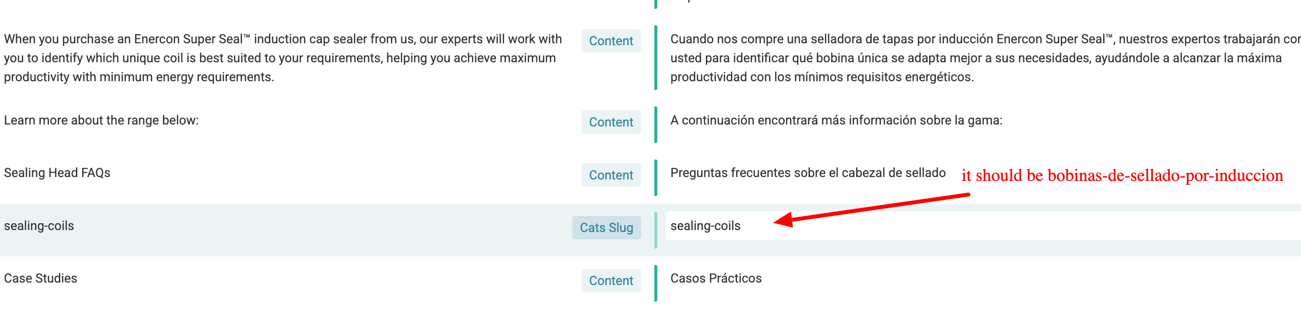

February 13, 2026 at 12:13 pm #17820437
Andrey
WPML Supporter since 06/2013
Yes, it's the same issue. The Spanish slug should be bobinas-de-sellado-por-induccion. I have attached the screenshot.
You can check the FAQ → FAQ Categories to take the correct slugs and insert them into the page translations.
