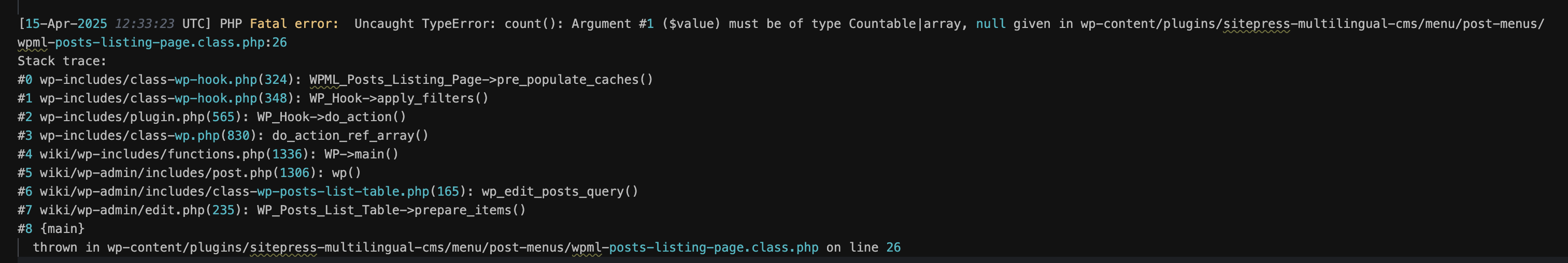

I am trying to enable Redis Object Cache on my WordPress site. When Redis Object Cache is active, count() is called on a null value in WPML_Posts_Listing_Page::pre_populate_caches(), resulting in a fatal error in PHP 8+. I followed these steps: 1. Enable Redis Object Cache. 2. Go to /wp-admin/edit.php (Posts/Pages screen). A fatal error may occur unpredictably due to a cache miss. The error occurs in wp-content/plugins/sitepress-multilingual-cms/menu/post-menus/wpml-posts-listing-page.class.php on line 26. The root cause is that under object caching (e.g., Redis), $wp_query->posts may be null due to a cache miss. Calling count(null) causes a fatal error in PHP 8+. Suggested fix: Please wrap the count() call in a type check: if ( empty( $wp_query->posts ) || ! is_array( $wp_query->posts ) ) { return; } This makes the method safe and compatible with any object cache implementation.
Fatal error: count(): Argument #1 ($value) must be of type Countable|array, null given in wp-content/plugins/sitepress-multilingual-cms/menu/post-menus/wpml-posts-listing-page.class.php on line 26.

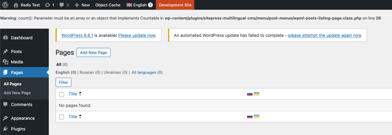

I think the key difference in my case is the absence of pages. We use post_type=post, but don’t use post_type=page at all.
My guess is that the fatal error happens on edit.php?post_type=page when there are no pages in the database, and count() can’t handle that. It’s possible that result might get cached and later affects other screens, including edit.php?post_type=post. That said, on the clean test setup, I wasn’t able to reproduce the issue on edit.php?post_type=post.
However, after removing the pages you had created, I could reproduce this error again on edit.php?post_type=page, though only after refreshing the page a few times. On the current PHP version, it shows as a warning instead of a fatal error.
Thanks.

A quick update: I upgraded the production site to WordPress 6.8.1 and WPML Multilingual CMS 4.7.4 today.
The critical error still occurs on /edit.php?post_type=page when no pages exist.
However, creating a single page (even a draft) prevents the error from appearing.
That said, this feels more like a workaround than a proper fix.
