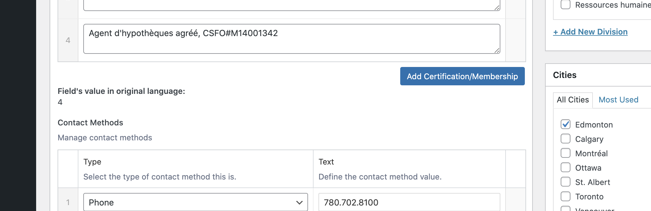

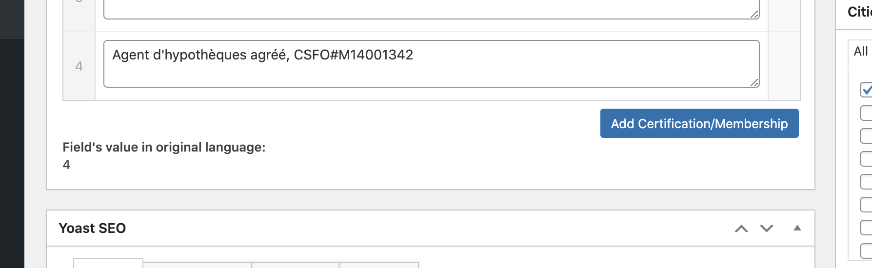

overhaulM
It also does not error, but it somehow hides the display of those fields on load. I need to catch it as it flashes by onload.

June 13, 2023 at 6:02 pm #13819771
Bobby
WPML Supporter since 04/2015
Most likely it is because now the Debug Display is activated and with PHP 7.4 it is a warning instead of a Fatal Error.
