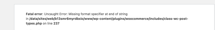

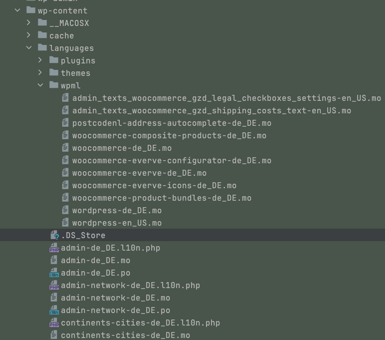

I need to update the site server from PHP 7.4 to 8.1. I have the same error as described in the documentation here: https://wpml.org/errata/wpml-string-translation-3-2-10-fatal-error-due-to-format-specifier/. However, I can't find the /missing/ folder on my server. When I deactivate the WPML plugin, the website works.
<b>Symptoms: </b>
Fatal error: Uncaught Error: Missing format specifier at end of string
<b>Questions: </b>
How can I resolve the fatal error related to the format specifier?
Why can't I find the /missing/ folder on my server?
Is there a specific step I need to follow to update the server to PHP 8.1 without encountering this error?

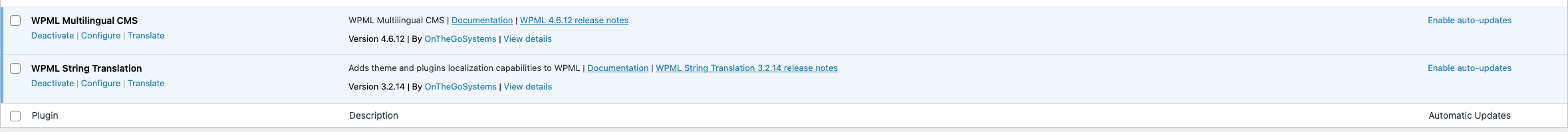

Downloaded the WPML String Translation add-on from your link, installed/activated, everything was fine working. Then switched back to PHP 8.1 the same error.

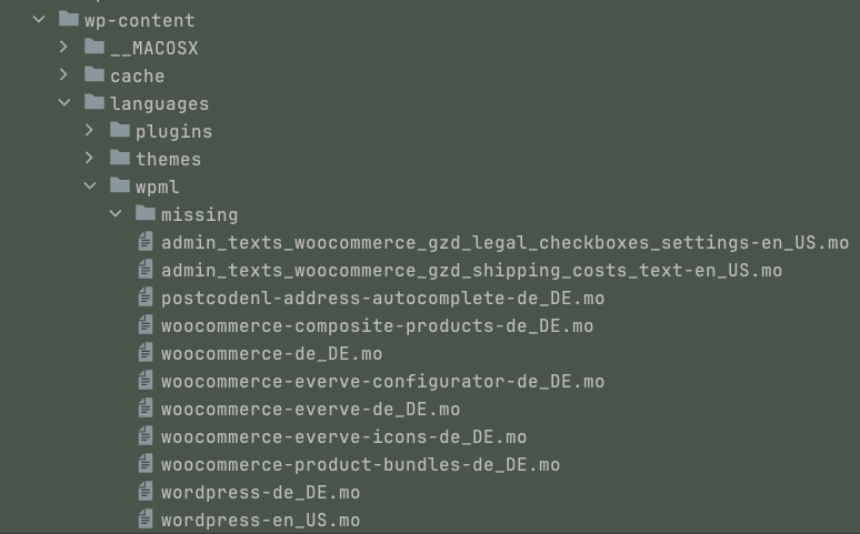

Then back to 7.4 added the "missing" folder at "wp-content/languages/wpml", and back to 8.1 and again the same error. Actually nothing helped.
