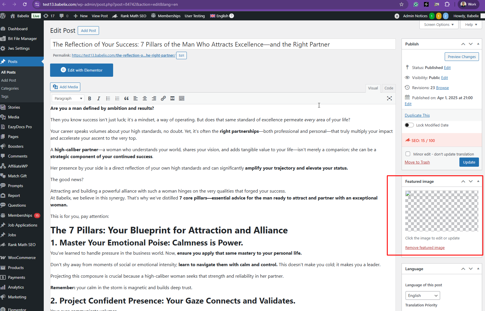

Thanks for your patience. While checking on the staging site you provided, I noticed that the posts "Featured Images" are all broken as shown in the attached screenshot. Could you correct it so that our 2nd Tier Support can check on this?

Thanks for your reply. Could you let me know what changes you made? When I checked, the featured image on the translated posts is now showing the correct picture.
