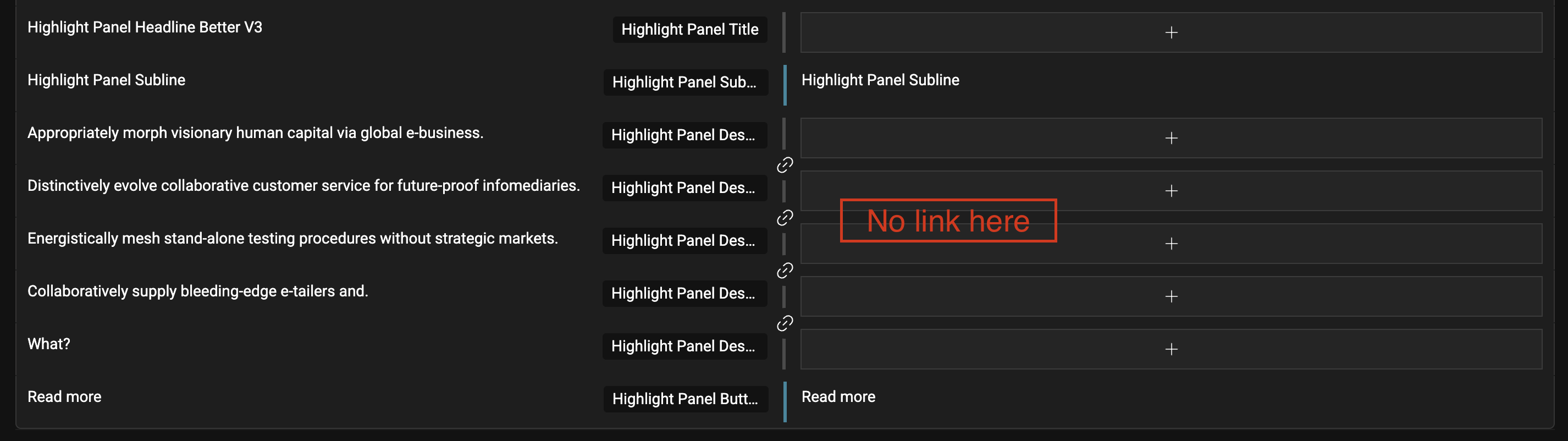

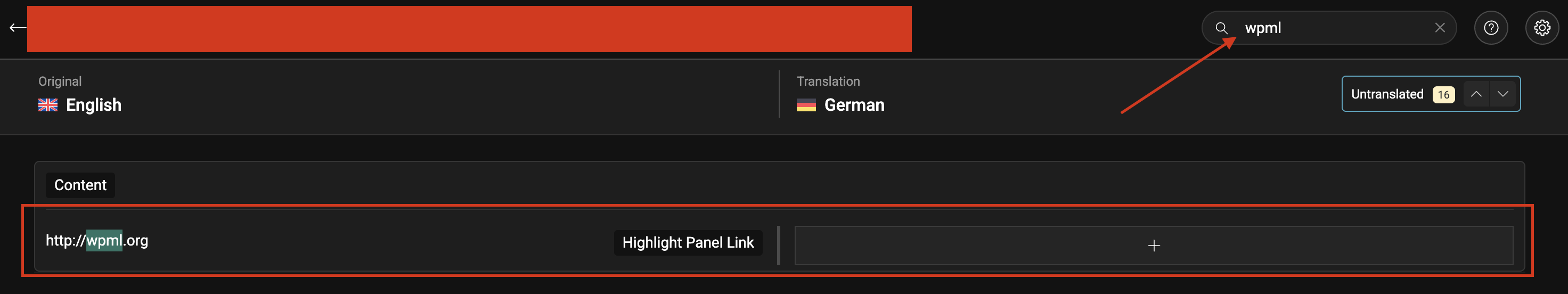

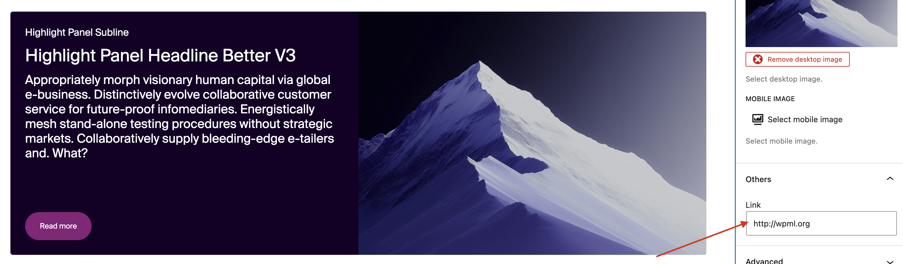

I'm trying to translate my custom buttons URLs, provided from the inspector controls of the custom block. Sometimes they appear, sometimes they not. If not, I can still access them, but only when I search for them. I want them to be always visible in the Advanced Translation Editor (ATE).
Fields that are URLs are not consistently showing in the Advanced Translation Editor.
How can I ensure that custom button URLs are always visible in the Advanced Translation Editor?

As per my discussion with the team, the links within the text are visible, while links in separate fields are usually hidden and can be searched. On top of that, in the past we fixed this for some page builder elements where separate links (in fields) were also made visible by default, as they were relevant and needed for the usability purposes.
