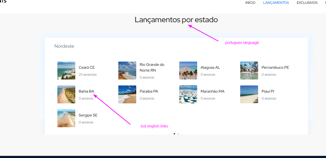

Links do not work on the translated site. Properties, cities, or states are not found in another language, and it opens blank and jumps to the English version.
How can I get links to work on the translated site?
Why are properties, cities, or states not found in another language?

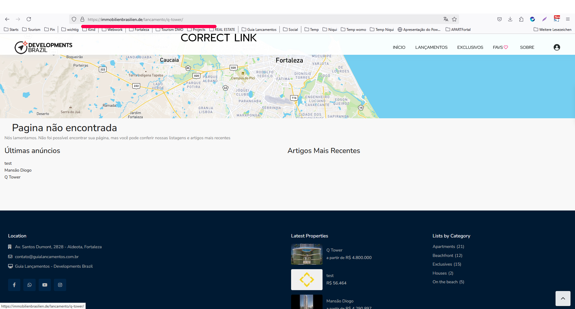

This...is not working, as I have each language for a different domain !
hidden link .
the portugues domain I used at this moment immobilienbrasilien.de
also /pt-br/city-municipality/fortaleza-ce/
is wrong because it's not translated in portugues, it should be there /cidade-municipio/fortaleza-ce/
I switched it again to 2 domains, but this links still not working

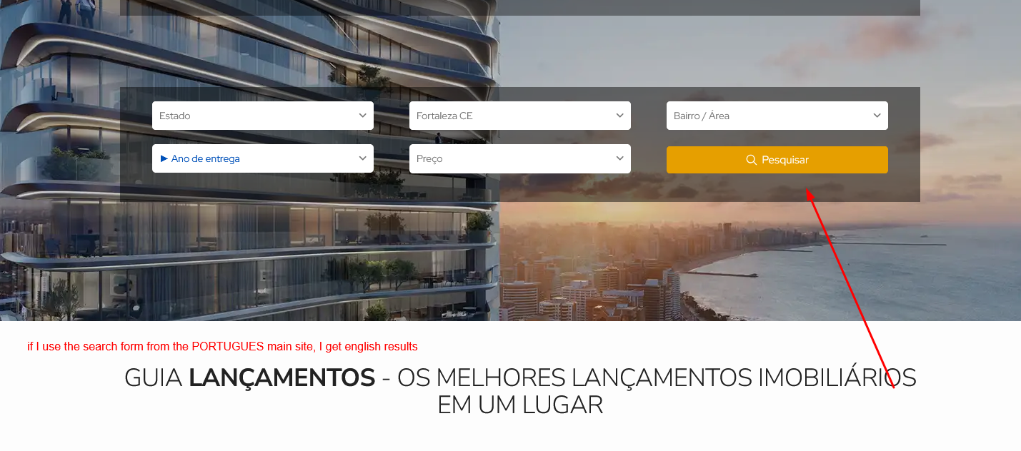

Also when I use search form at the main site (see screenshot) I got english results even in portugues language

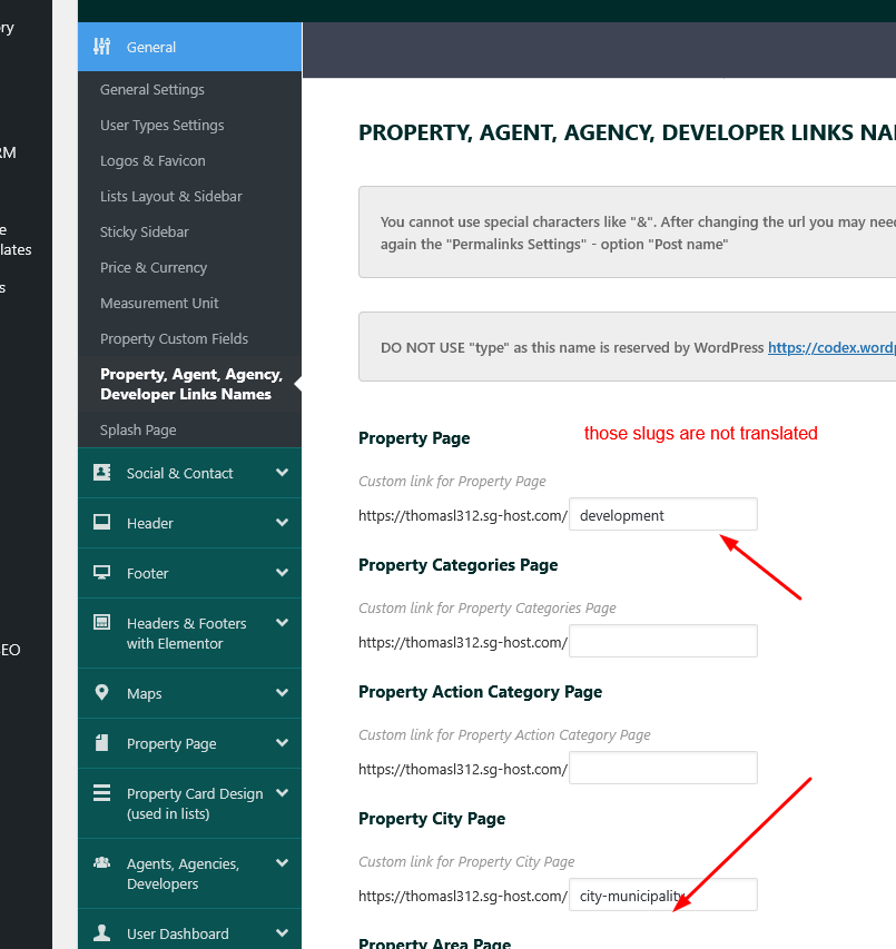

Also the properties have the slug hidden link
which is not translated , it would be hidden link
probably some slugs like on screenshot 292 are not translated

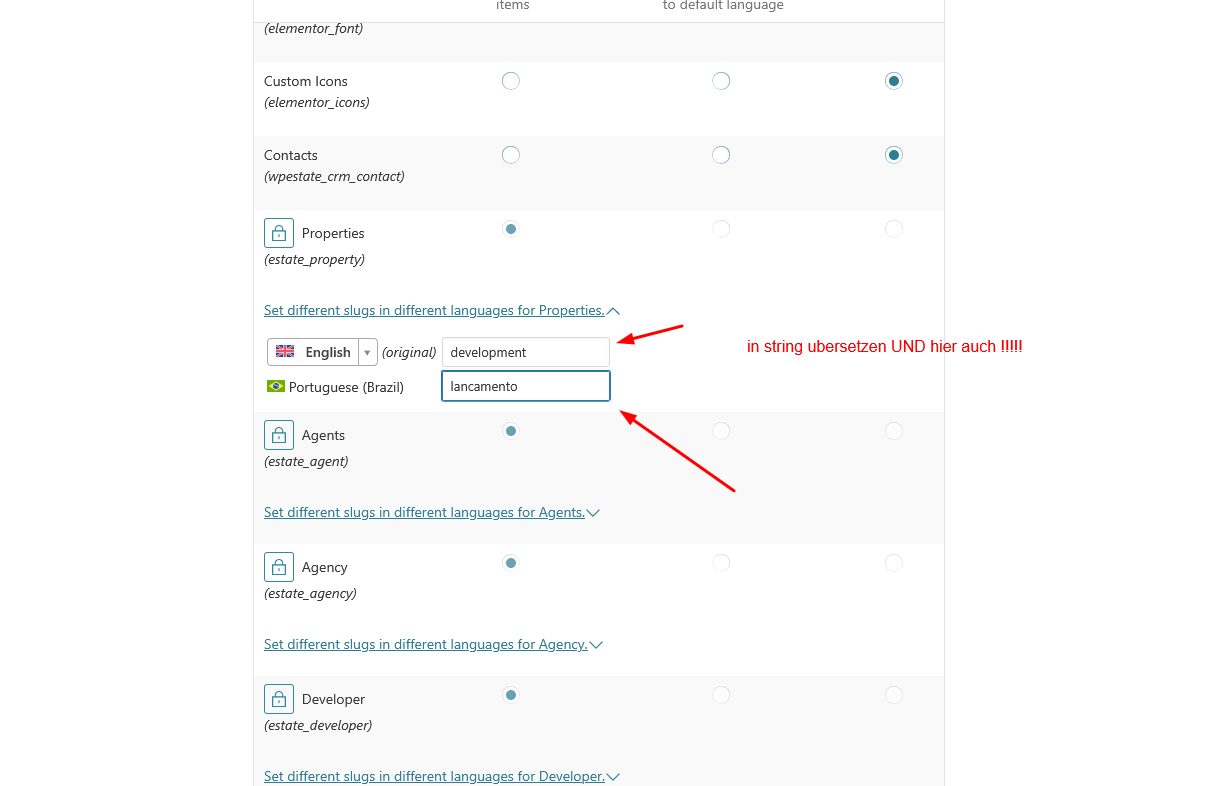

The taxonomy slug should be translated via this link: hidden link and/or under WPML > Settings > Taxonomies Translation. Additionally, you’ll need to remove the taxonomies translation for the admin strings from String Translation.

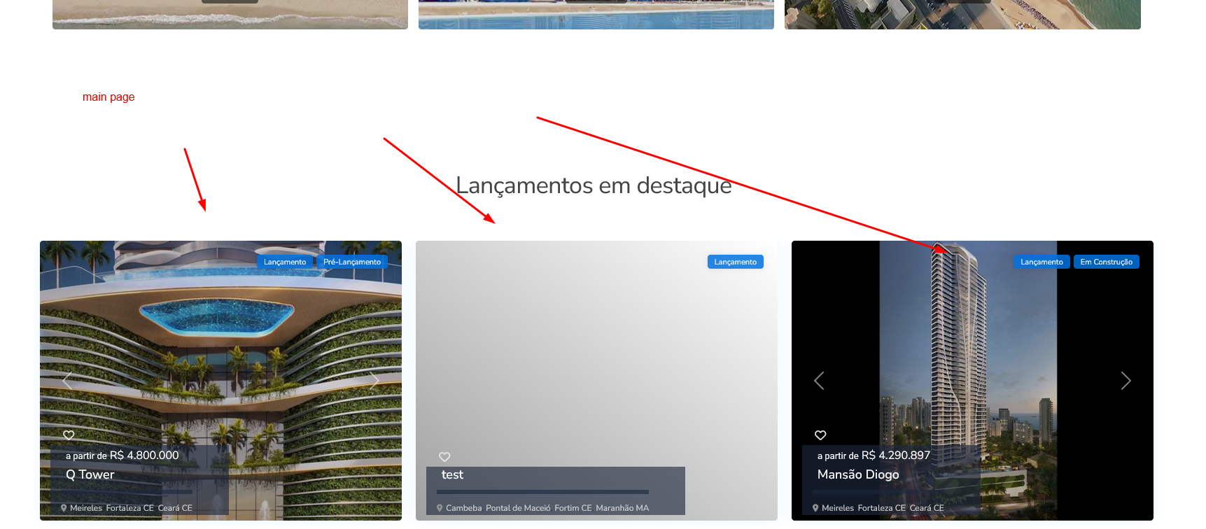

Hi Kor,
I got it translated, Problem is still, that on correct links, the site is not finding the posts (properties), even translated. screenshots post_link01 and 02

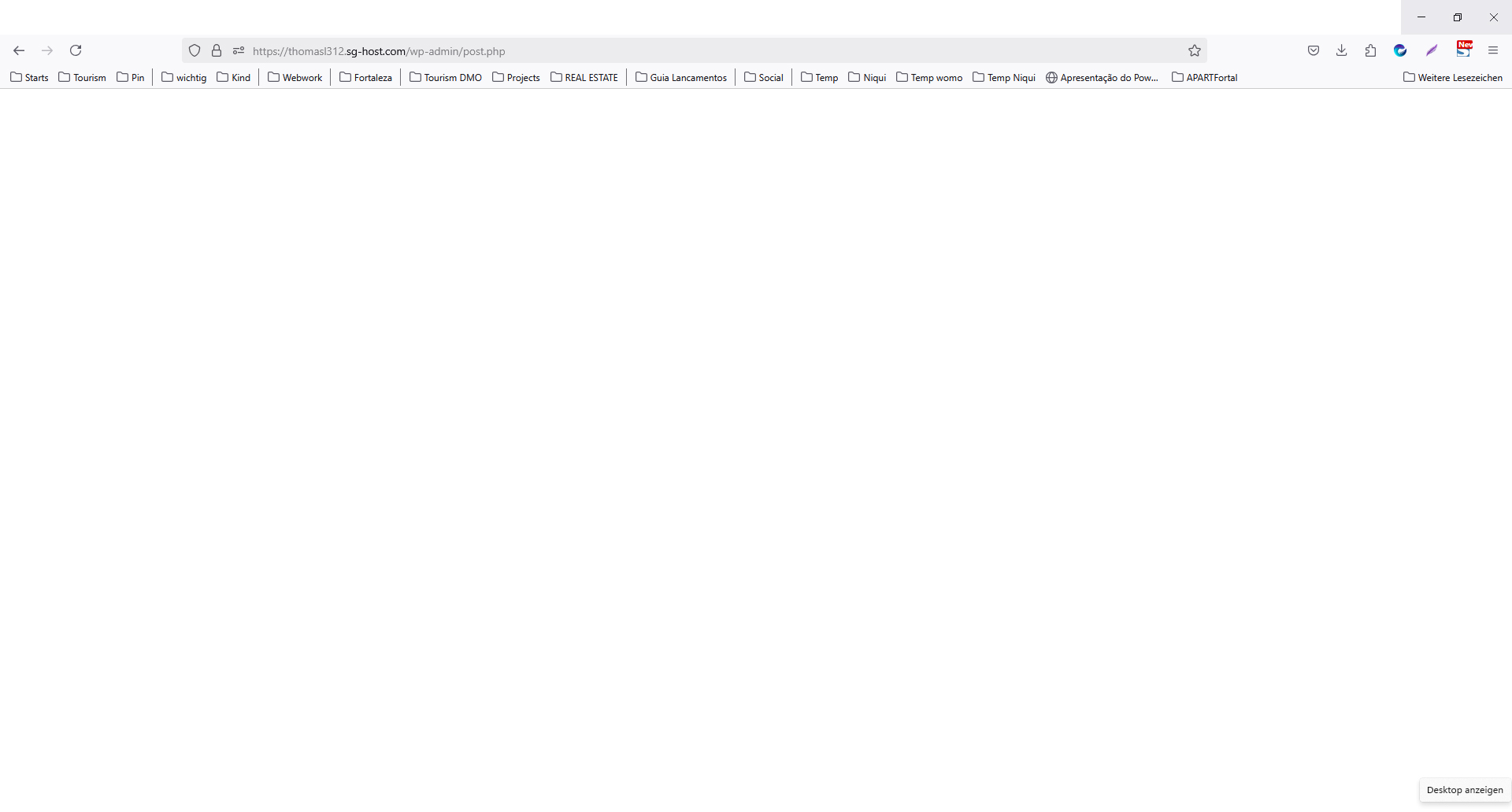

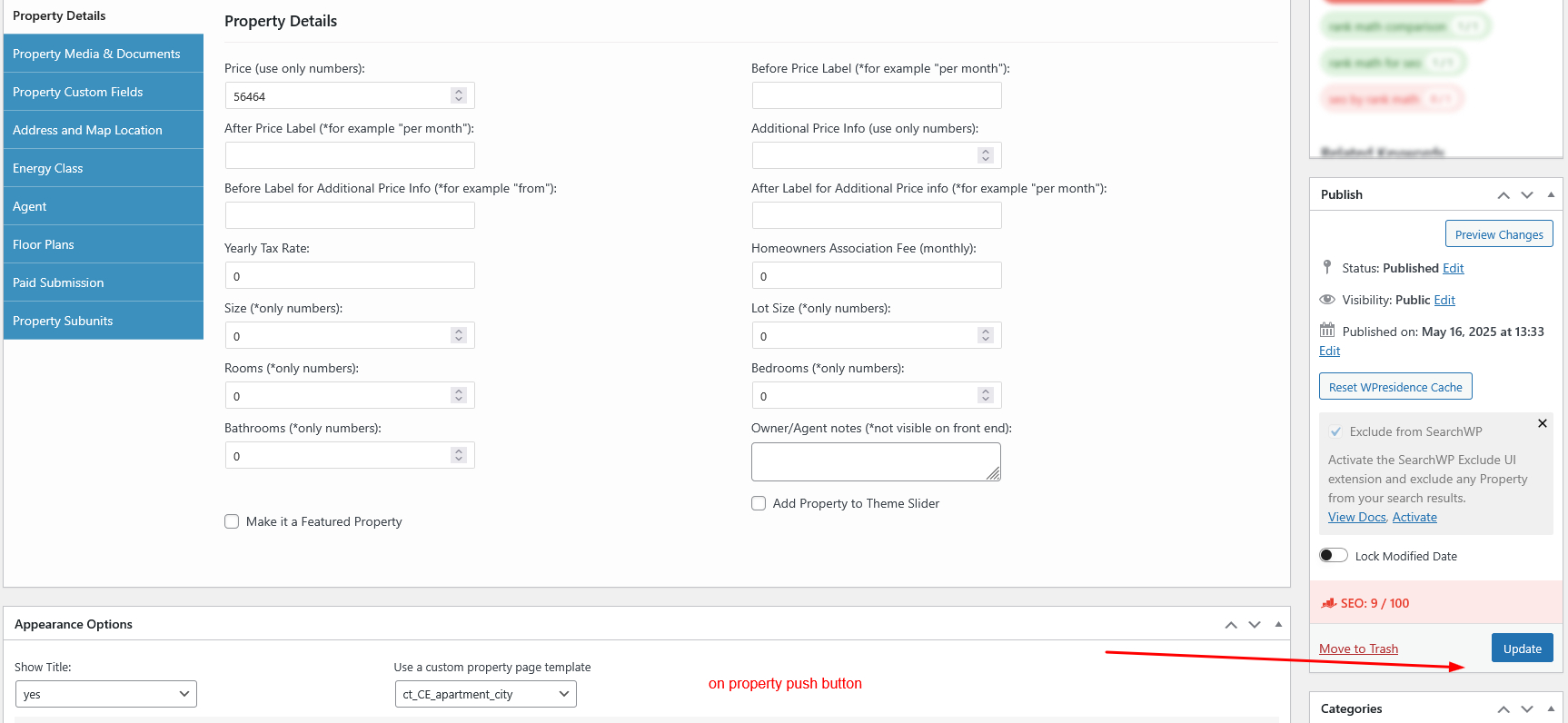

Another big problem occured now, when I modificate a post (in my theme are posts properties) and press update, I get a white screen from wordpress.
I disabled all the plugins and the problem is in WPML Multilingual CMS.
screenshots white_screen01 and 02
