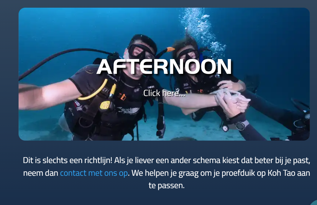

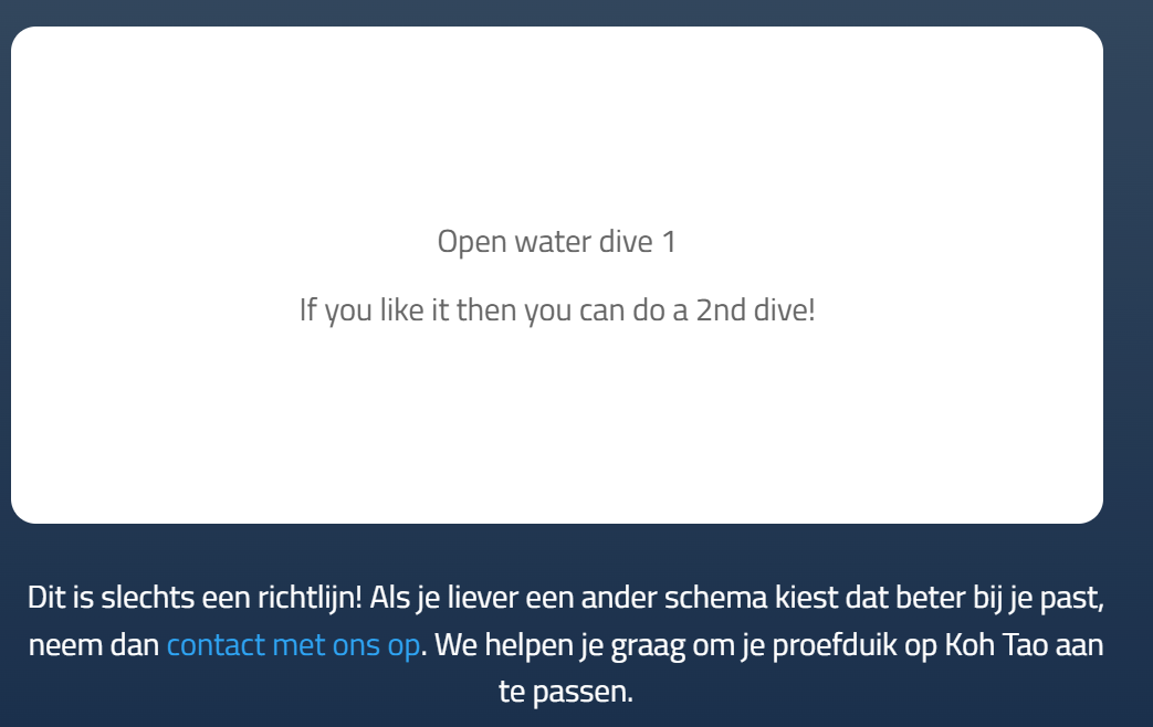

I am trying to translate the English page into Dutch using WPML. The issue can be seen on this page: hidden link.
The Flip Card module is not showing in the Advanced Translation Editor (ATE). All content is available for translation except the flip cards. The ATE lists the translation as 100% complete, but the flip cards are missing.
Why are the flip cards missing from the translation?
How can I ensure all modules, including flip cards, are available for translation?

Unfortunately the "Divi Flip Cards" plugin isn't WPML compatible, however, this is a common case where plugins offer such page builder widgets/modules which need registering with WPML before these can be translated.
Please check our guide on registering Divi modules. All you need to try the following:
- Find the Divi module's (Flip Card) shortcode and its attributes.
- Go to WPML -> Settings -> Custom XML Conifguration.
- Add it there as per the guide and save.
- Open the page having the module, resave it without making any change.
- Update translation and you should see the content from the module in ATE.
