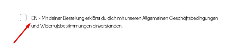

I am working on a site under development and trying to translate Germanized Strings using WPML.
Germanized Free String translation does not work.
Why are the Germanized Free Strings not translating?

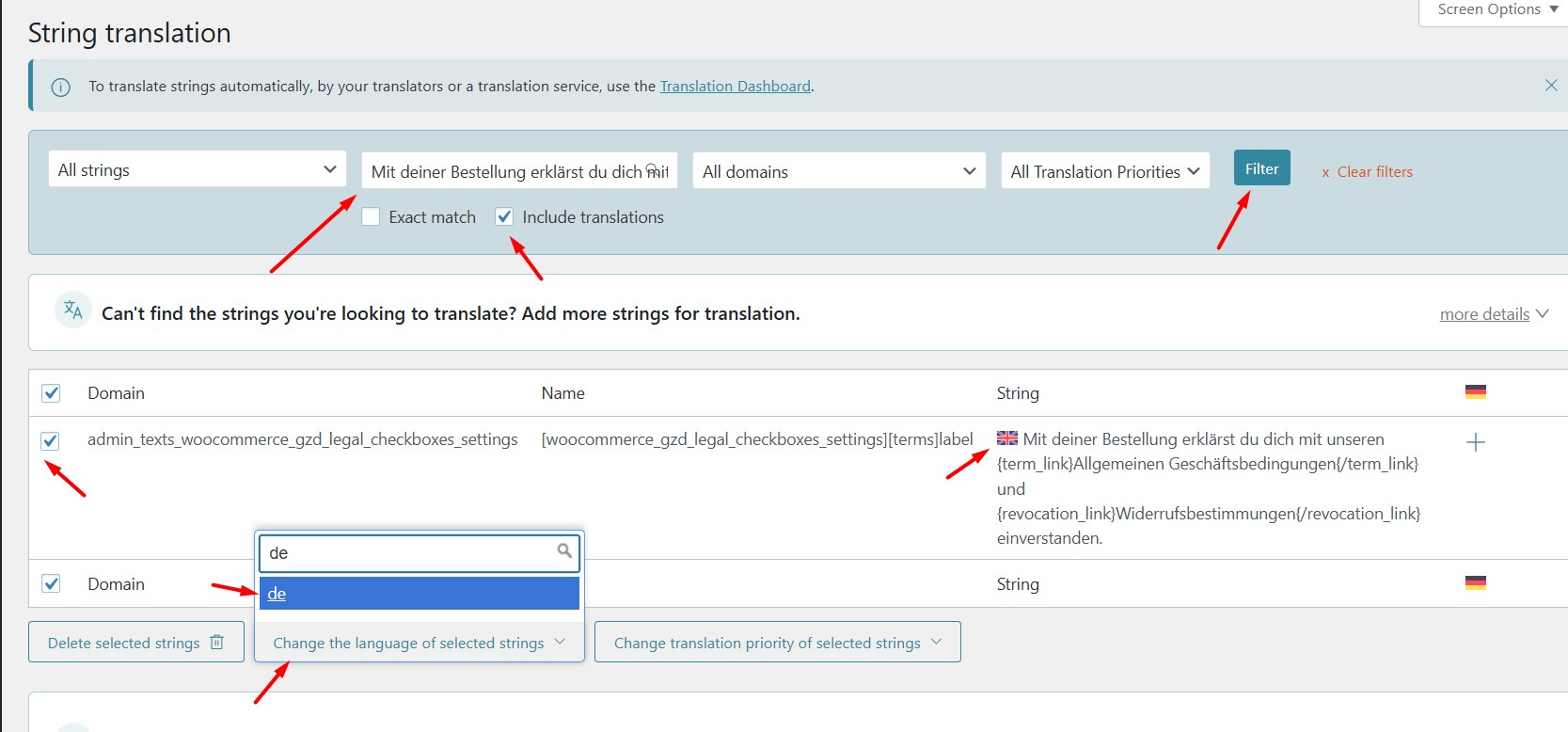

2. Went to the WPML >> String Translation page, searched for the checkbox text.

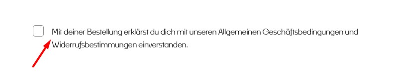

3. I noticed that the English language was assigned to the German string, so I Selected that string, and assigned the German language using the “Change the language of selected strings” dropdown as you can see in the attached screenshot.
4. Added the test translation and now it seems to be shown correctly.
You should be able to update the translation from here: hidden link
Could you please check and confirm?
