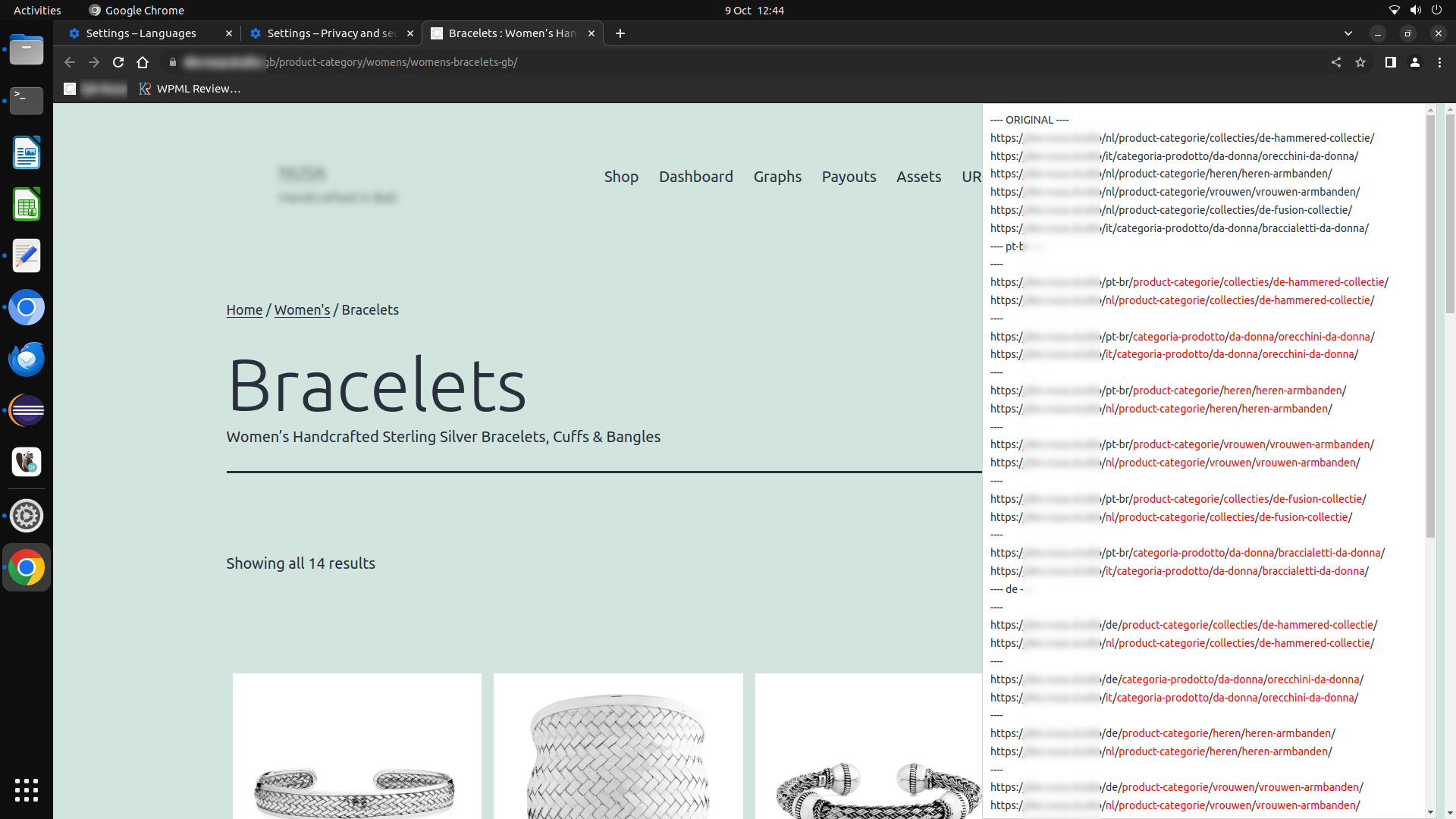

We had an issue some time ago and found a work around, now after an update, it's bitten us again. This has been an ongoing issue for almost 2 years now.
I'm trying to get the URL in a specific language given any site URL. Ie; URL in language A returns URL in language B. I've had some success using the wpml_permalink filter, but it doesn't work for all URLs.
I've tried tracing through the code to see how sitepress-multilingual-cms determines the URLs for each language in the language switcher, but it's convoluted and there doesn't seem to be something as simple as a function call to get the URL for a given language.
Why isn't the wpml_permalink filter working for all URLs? And is there a function I can call passing a URL and target language to get back the correct URL?
I've deactivated all but essential plugins and changed the theme to Twenty Twenty-One. In the header.php for the theme, I've added some basic code to get the converted URL for a sample of site URLs in several languages. I've tried both with an without the $full_resolution flag set. I've cleared the WPML cache and cleared all transients. Using a browser that has had all cache cleared, I've navigated to a product category page. The result is that none of the URLs are correctly converted for any language.
wpml_permalink is clearly broken. The URLs in the language switcher are correct, but it doesn't use the wpml_permalink filter.

As detailed in my post; I have created a minimal instance. I've removed all non-essential plugins, cleared all caching, and switched to a core theme.
The only code added is the code required to test the problem.
I've done some more testing and there are several URLs which for some languages do translate correctly, so I'm tending to think that it's a combination of the hook not working properly (given that the language switcher has the correct URLs), and the state of the data.
I've looked at the icl_translations table and termmeta, and there's nothing obviously wrong. Can someone who knows how the hook works confirm if there are any DB queries with inner joins to other tables that could be causing dropped rows?
