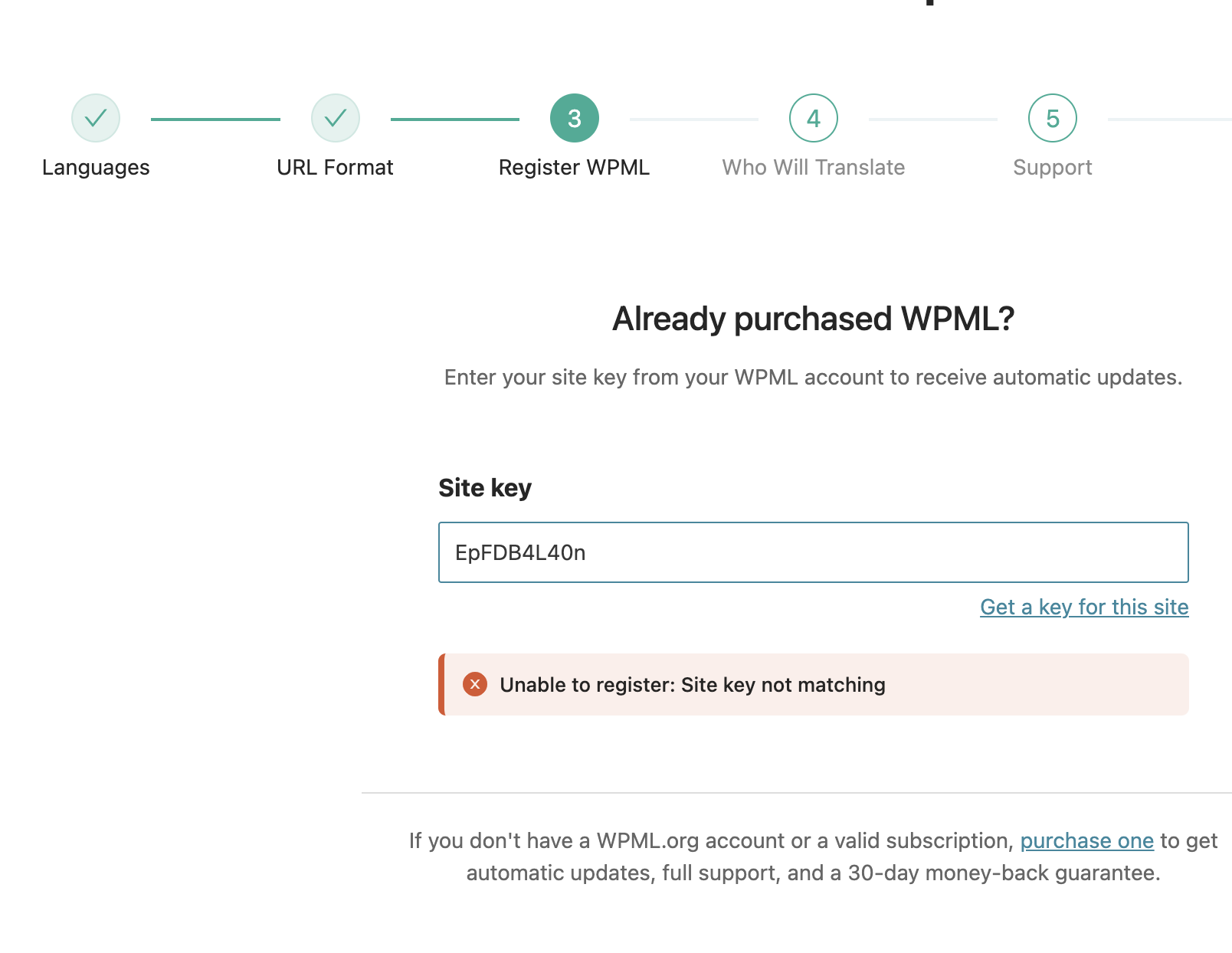

kaitlinG
I am trying to get WPML working in our developers' local environments. We are using a WordPress VIP local environment created by setting up Docker containers for nginx, PHP, MySQL, etc. The proxy endpoint is exposed to us, and we created a site key for it.
When trying to register WPML for our local dev environments, it errors out and says the site key doesn't match.
How can I register WPML for a local development environment?
Why does the site key not match when registering WPML in a local environment?

Bruno Kos
If the URL is different, you need a different key as well:
https://wpml.org/faq/how-to-remove-the-this-site-is-registered-on-wpml-org-as-a-development-site-notice/#what-if-the-notice-still-appears-after-moving-to-production
So you need to follow this to re-register a key for the new URL.
You can also check this:
https://wpml.org/faq/automatic-wpml-registration-using-php-for-easy-moves-between-production-development-and-staging/
Maybe that would fit your setup.
