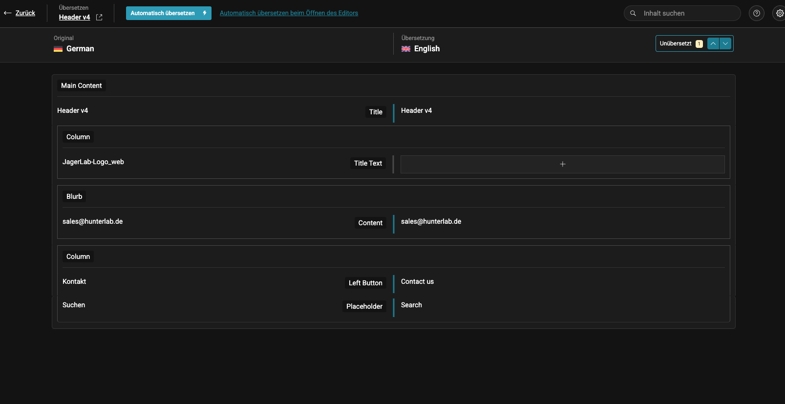

I tried to translate the content through the link provided but as you can see in attachment the phone number is not showing...
Am I missing something?
Stefano

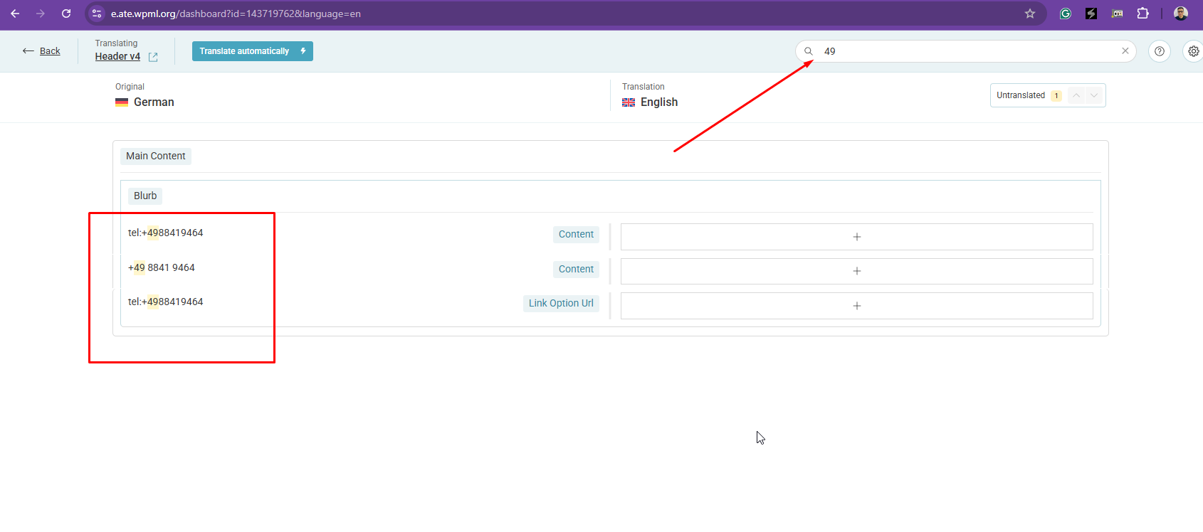

May 22, 2025 at 3:35 pm #17062804
WPML Supporter since 08/2022
Thanks for your reply. You need to type some similar numbers on the Advanced Translation Editor search form as shown in the attached screenshot. Could you try?
