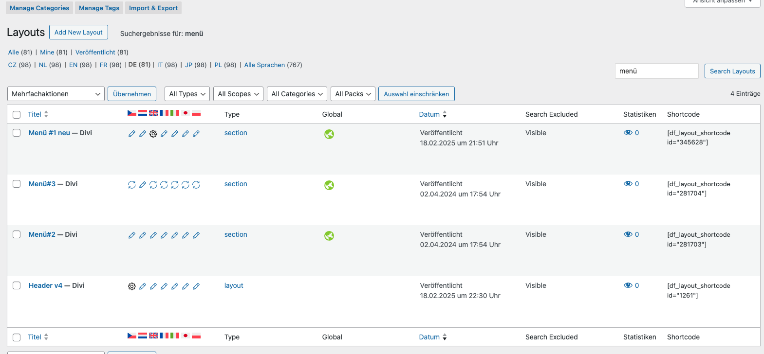

June 4, 2025 at 4:37 pm #17107584
stefanoM-53
Hi Kor,
thanks for your reply!
The addressed topics are very interesting and please let me know how can we fix them on the live website.
Meanwhile I could solve the problem with the phone numbers in the header.
Under DIVI Layouts we have 3 Global Sections (Menü 1, Menü 2 and Menü 3). These 3 sections are all part of the header and I think they overwrite what we edit in the header.
I followed your previous instructions and opened for example Menü 1 and searched for "+". All of a sudden the phone numbers appeared!
Let me know anyway how it develops further for the topics above.
Thanks for your help!
Stefano
June 5, 2025 at 7:30 pm #17112073
Thanks for your reply. I'm not sure if I'm getting this. I've checked your menu layouts below, and are you saying that you're able to translate the header phone number when you try to translate the menu layouts?
June 6, 2025 at 3:07 pm #17114423
stefanoM-53
Hi Kor,
exactly,
I had to open the Menü #1 in the Advanced Translation Modus (hidden link) and then search with "+". Suddenly the phone numbers started appearing 🙂
