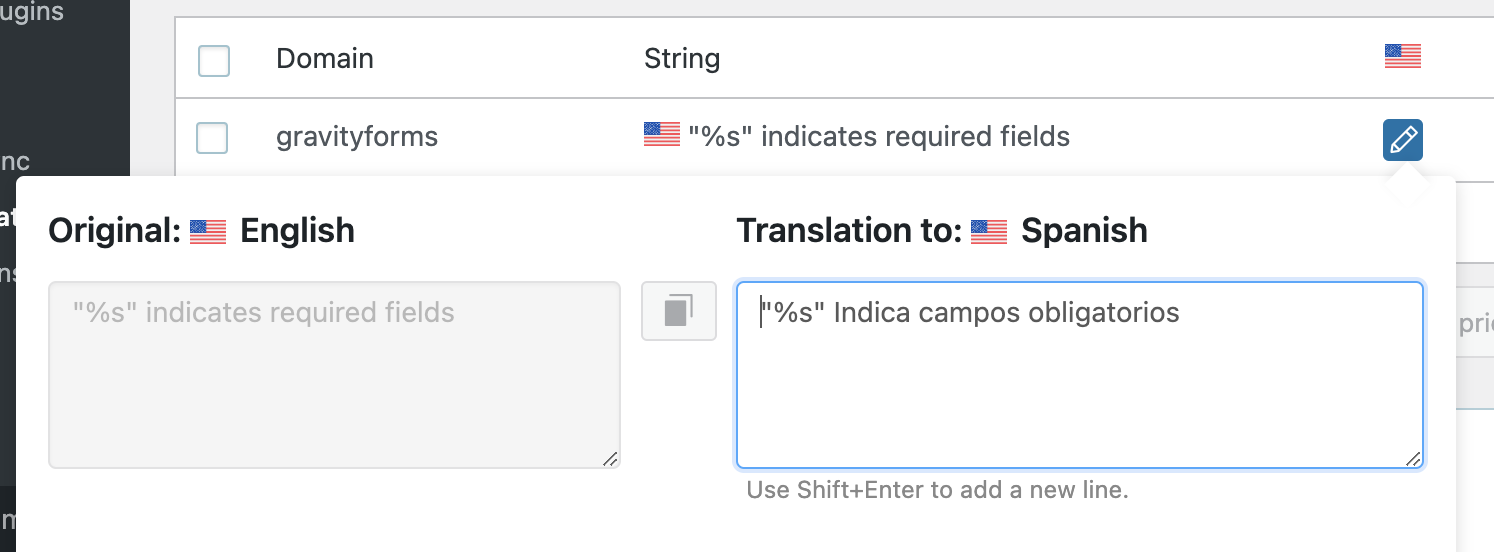

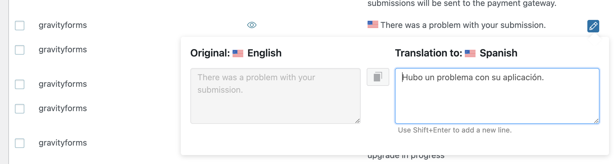

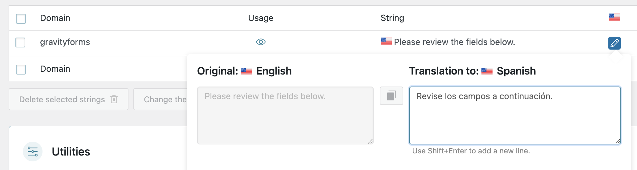

I am trying to translate the text in the String Translations for the Gravity Form error message, including '* indicates required fields'. I have attempted to clear the cache, but it is still not translating. The issue can be seen on this page: hidden link
The GravityForm String Translation is not working. I expected to see the text in Spanish, but instead, I got it in English.
Why is the GravityForm String Translation not working?
How can I ensure the translated text appears correctly on the page?

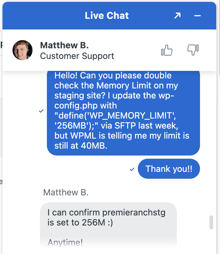

I already increased the WP Memory Limit to 256M (and verified the limit was increased with WP Engine - see attached screenshot) and installed Gravity Forms Multilingual plugin last Friday 3/28/25. I didn't see a way to translate the form errors via the GF Multilingual plugin. Please let me know what else I can do resolve the form errors translation issue.
Thank you
