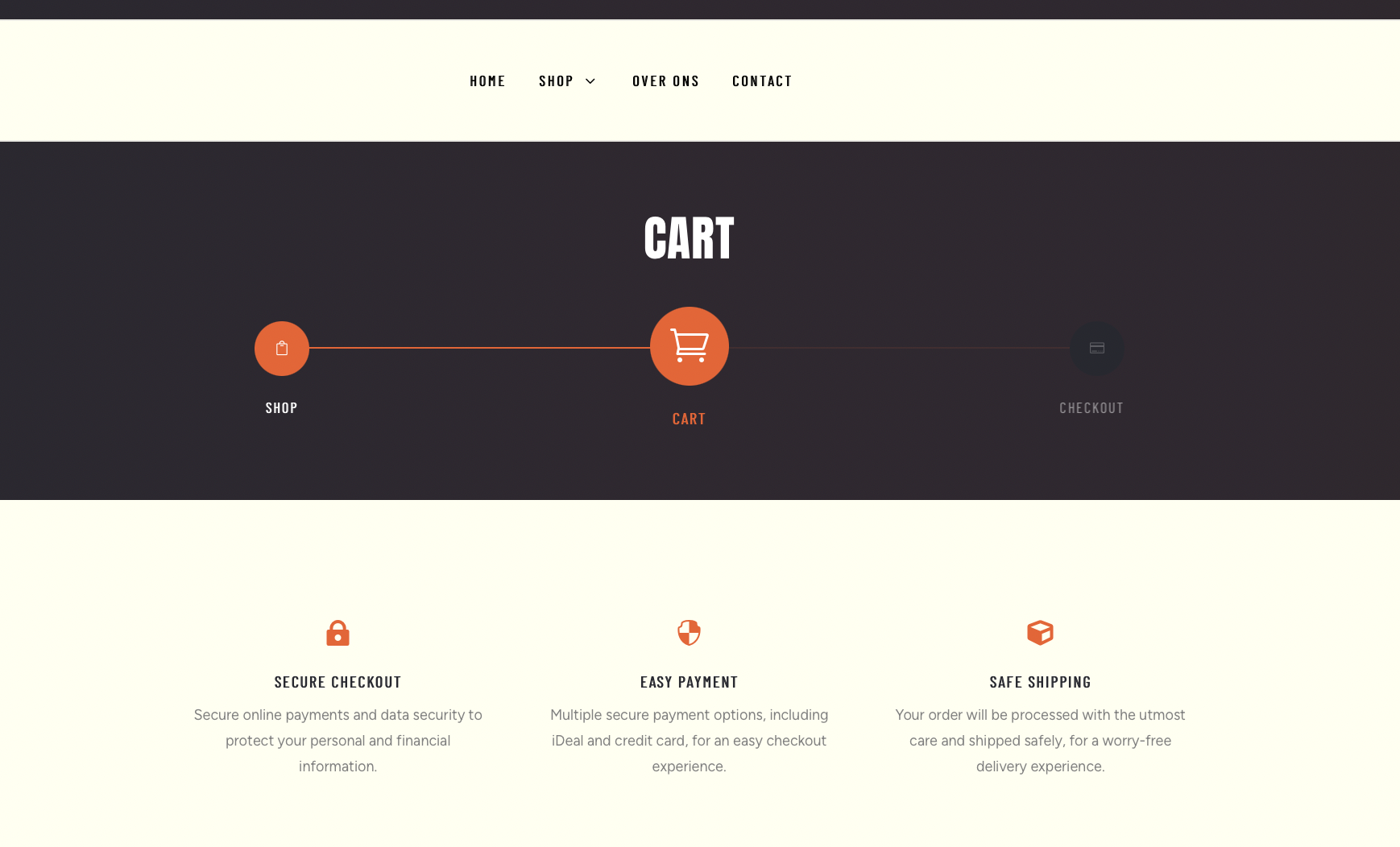

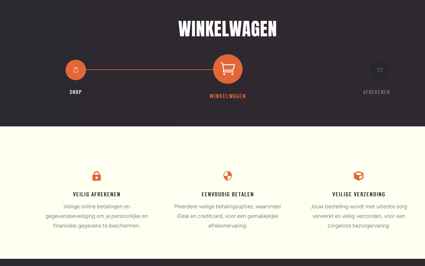

April 2, 2024 at 10:35 pm #15475353
Mihai Apetrei
WPML Supporter since 03/2018
Timezone: Europe/Bucharest (GMT+02:00)
Thank you for your amazing patience, Simon!
Indeed, it seems that the issue was related to NOT using the WCML plugin.
But I also updated the WPML plugins (main and WPML ST) to the latest version, too.
I'm attaching some screenshots, too.
- hidden link
- hidden link
So, the template shows correctly for me now.
Can you also please take a look and confirm if things look good on your end, too?
Thank you!
Mihai
