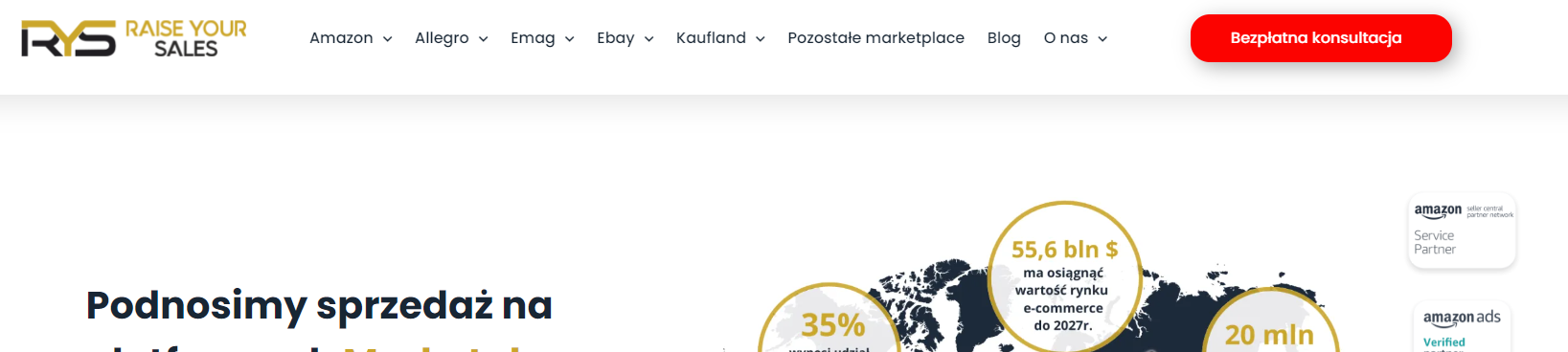

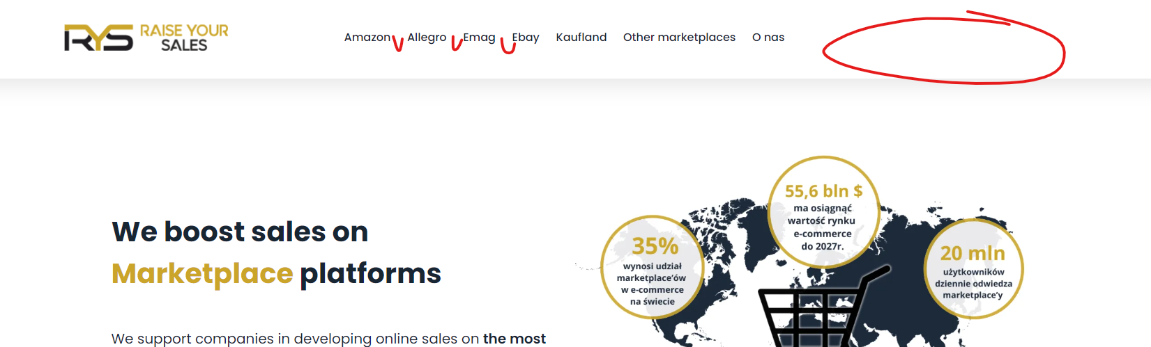

I am trying to have my site raiseyoursales.pl (default) and its translations raiseyoursales.de and raiseyoursales.co.uk display correctly. I published translations, and everything works on .de, but on .co.uk I am unable to see the translated sites in the header and button. In elementor editor everything show fine but in incognito mode, there is no menu and button.
I tried purging cache, but it does not work. If I turn off the Litespeed cache plugin, everything seems to work fine. Link to a page where the issue can be seen: hidden link.
The header is not showing the button and translated sites in the menu on the .co.uk site. The issue resolves when the Litespeed cache plugin is turned off.

I just found out that .de is not working properly either.

Problem also appeared on .pl and .de, they are not working properly also.
