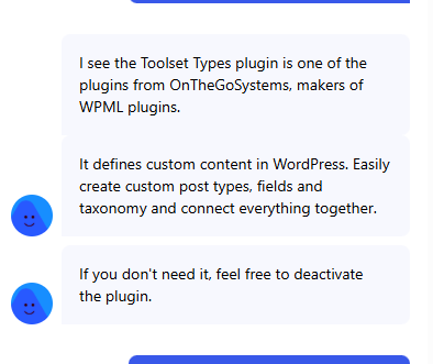

also please check this video

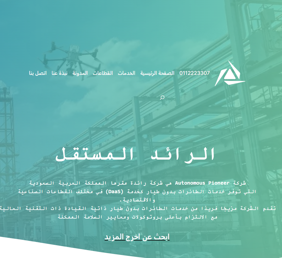

there is an issue when trying to render or navigate to another page on the site, the navigation menus show up differently for a moment and then it shows ok as expected.
when i asked wordpress about it they said this, please check the screenshot
so i wanted to make sure is this needed or can i deactivate it?

The following plugins are not needed for WPML to work and since you are not using them I have also deactivated them and it's safe for you to delete.
Toolset
Contact Form 7 Multilingual
WPML CMS Nav
WPForms Multilingual
WPML ElasticPress
WPML GraphQL
WPML Sticky Links
Advanced Custom Fields Multilingual
Ninja Forms Multilingual
MailChimp for WordPress Multilingual
I also deactivated WPML main plugin temporarily to see if that is what is causing the menu load issue and it's still happening even without WPML.

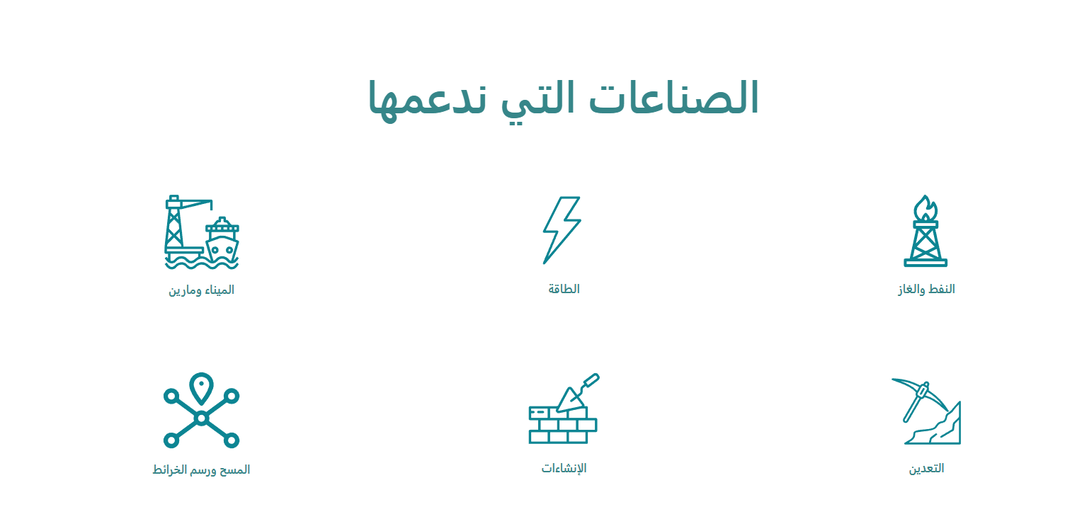

1. For industries --> The string "Industries we support" is used on the English version so it's correctly translated, however, if you examine the EN version you can't find this string there either.
This is part of the template, therefore you will need to edit that in the template and not the page

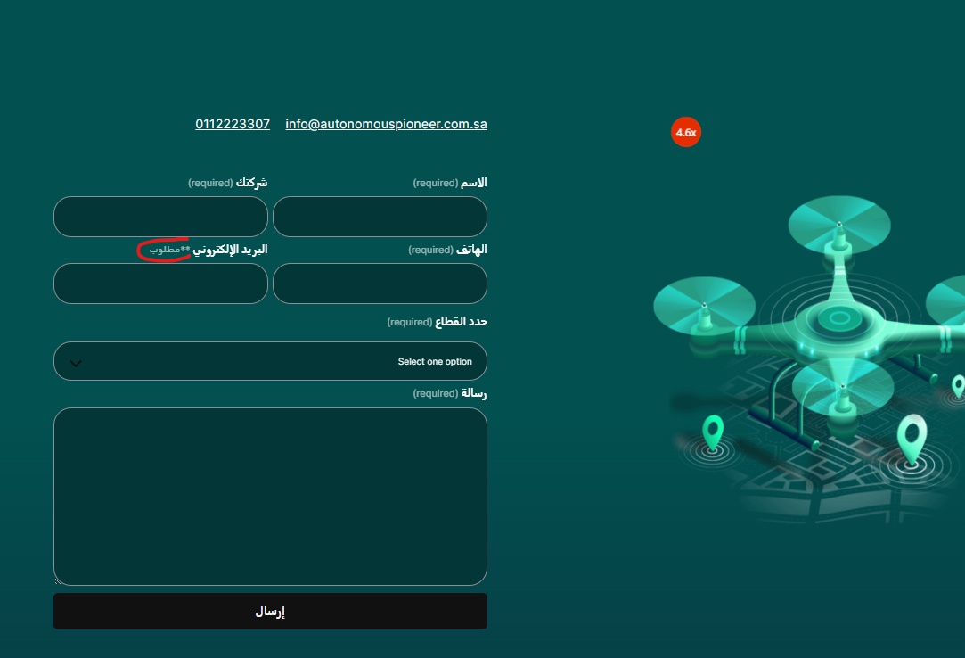

2. For the contact form --- when I examine the HTML in the front end there is a <br> tag which does not exist in the EN version
it's nearly impossible to edit this content with the white background so I am checking the code editor instead and I found the BR tag encoded
"there is a <br> tag in this code — but it's encoded as \u003cbr\u003e, which is the Unicode escape for <br>"
I have removed it and it should be resolved now.
3. The navigation menus -- the URL is also hardcoded to use the EN version which is why this problem is happening when you use the AR version of the menu.
I resent them to translation via WPML->Translation Management->Assigned to me and manually adjusted the URL.

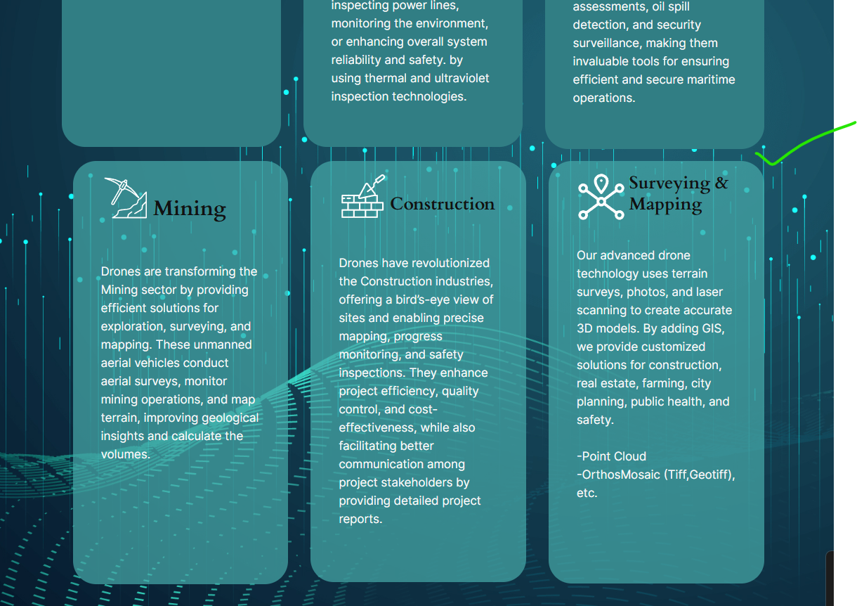

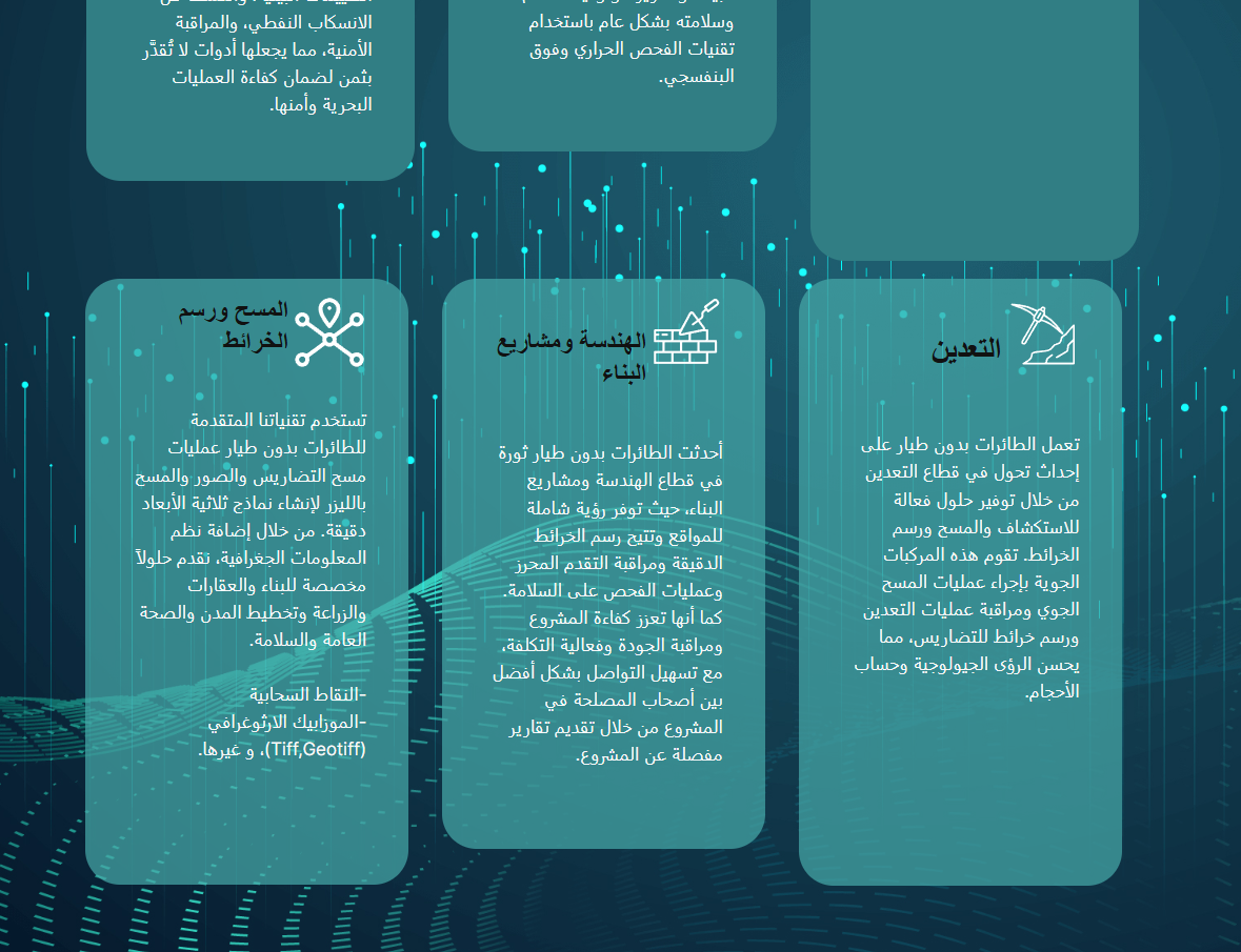

-as for this part "This is part of the template, therefore you will need to edit that in the template and not the page "could u please share with me a video of how to do it?
-also for the contact us page its weird that the only of the (required) is translated and the others not
-and for the industries page the boxes spaces is all good in english version but when change it to arabic it get messed up even though i manually added the spaces in the arabic version but it didnt work

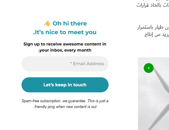

also there is more thing please check this video, whenevr i try to translate the blog posts im facing this marker issue thing
even inside the blog posts there is a newsletter sign up is not translated

1. please navigate to the FSE editor and the template is located there, then you can also go to WPML->translation management and from there send that template part for translation.
2. You will need to translate those manually, the one is translated because I had done it manually earlier when we reviewed it.
3. For those spaces please make sure you are using the HTML editor to review the HTML and see if there are any extra spaces possibly?
Regarding the new issue with the blogs if possible please open a new thread as we do try to keep each ticket to one issue.
