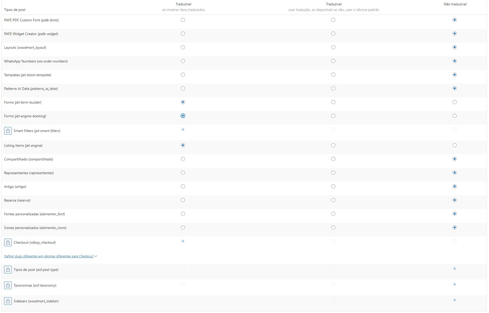

I am developing a site and having trouble using JetFormBuilder's translated forms. I noticed that the forms aren't translated like other pages and plugins. I saw that it's only possible by duplicating the form, but even after duplicating it through WPML and setting the language, the form isn't changed when I visit the page and change the language. I used Elementor to add the JetForm widget, and on the page where the form is located, no information related to the inserted form appears.
The translated forms created by duplicating through WPML do not change when the page language is switched. Additionally, no information related to the inserted form appears on the page.
Why aren't the translated forms changing when I switch the page language?
Does Elementor interfere with the JetForm widget's functionality?
Is there an option that needs to be activated for the form information to appear on the page?

First, you need to set the JetEngine Form post type to "Translatable", then you'll be able to create the translation.
So please go to WPML > Settings > Post Types Translation, find the form post type and set it to Translatable.
According to JetEngine's docs, you can translate the form after following the above steps by duplicating it and then editing the duplicate to add your translation which you already mentioned that you did.

The information you gave me refers to the 'Jet Engine' and not to the JetFormBuilder.
But I still think you didn't understand my problem.
I duplicated the forms and defined the language, and there were 2 forms, one in the default language and the other in the configured language, so far so good.
The page where the original form is also has the translated version.
My problem is that when I visit the translated page, the form doesn't change. It should identify the translated form and change.
As I mentioned before, this page was created with Elementor and the form was added by the 'JetForm' widget.
When I try to translate the page where the form is, nothing appears regarding this widget.
Did you manage to understand my problem?

I understand you did the copying part correct, abut the reason it does not show on the translated page as translated is because you need to set the post type of that as translatable.
Here is what to do:
If the issue persists, I'd appreciate it if you could give me the URL/User/Pass of your WordPress dashboard after you make sure that you have a backup of your website.
Also please give me the information below:
- The form name
- Where to see it in the menus
- The page that the form is used.
I also suggest that you test without Elementor and by adding a test page and use normal WordPress block and add it there. See if it works that way or not.
I will need the answer to that to know where to look for an answer.

All these settings have already been made, the JetFormBuilder post type has already been configured as translatable (I tested both options).
I did a test as requested by adding the form without using Elementor, just using the WordPress block and it didn't work either.
When editing the page in the other language, nothing related to the form appears on the page that is being translated.
The site I am implementing is not in production, if you can't help me I will have to upload a published test site for analysis.
If there is anything else I can do I would be grateful.
