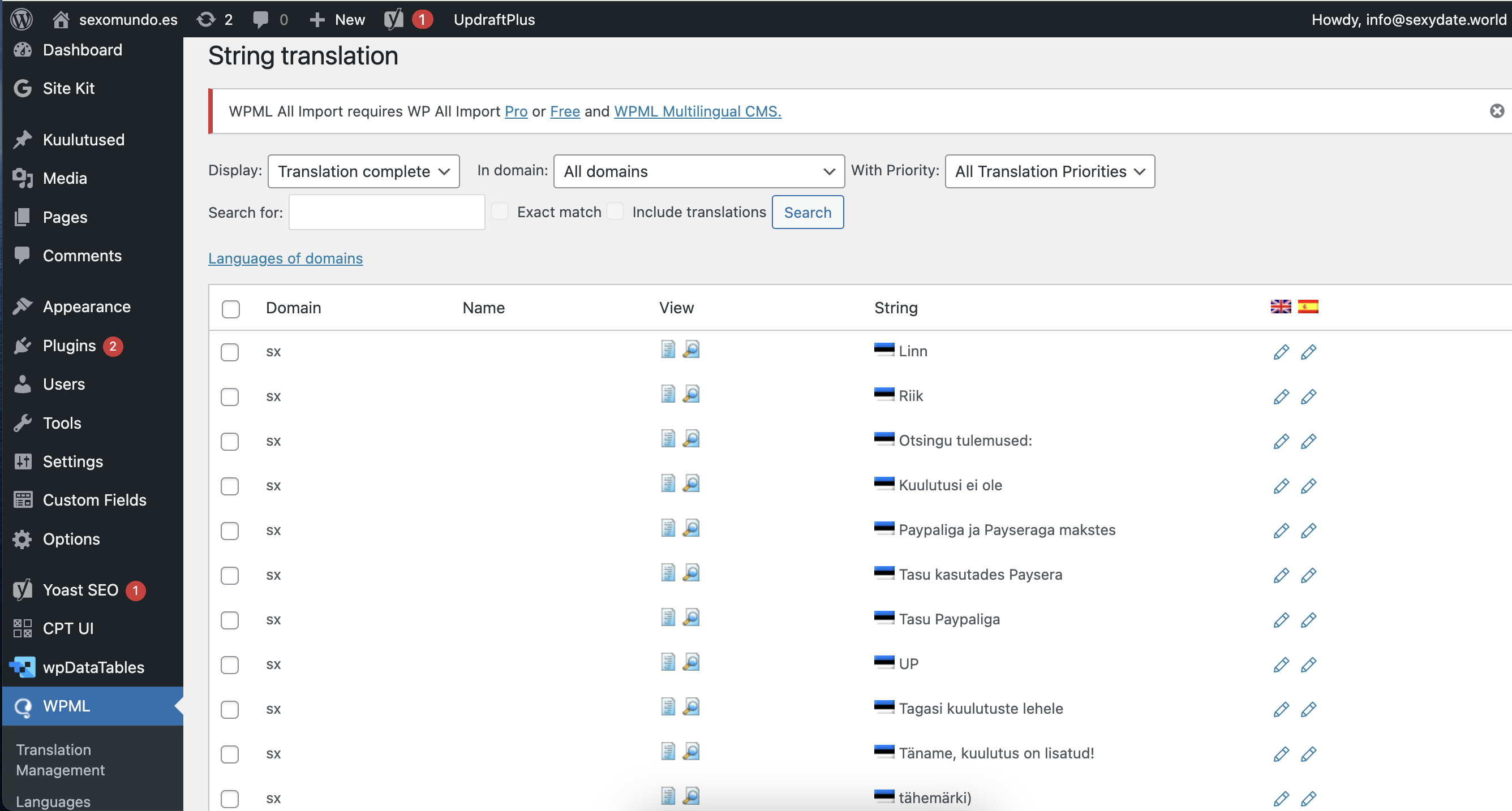

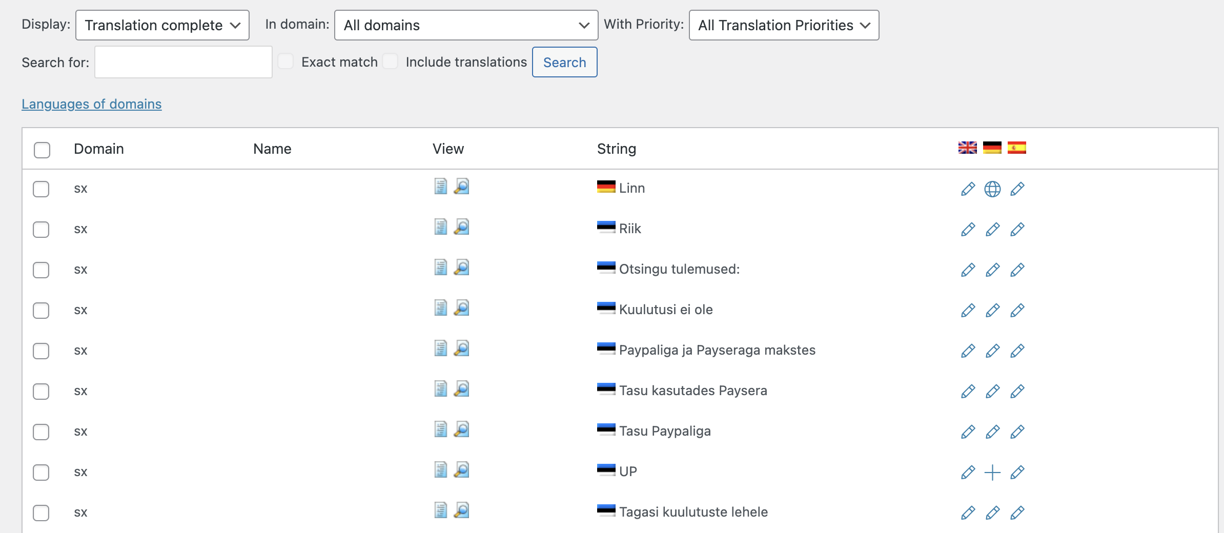

If you go in WordPress to WPML - string translation - translation complete, then you see the language structure of the site. The original language of the site is at the moment Estonian and the Spanish and English are translated. How to change the original language to English?

I did it. The default language is changed, but the result is not what I wanted. At the moment changed ony the language when the site is opened. At the moment if you go to the site then it is automatically in English - although it should be (and was earlier) automatically in Spanish. But in the section of string translation nothing changed, there still the original language is Estonian - but this is what we wanted to have in English! Did we do smt. wrong?

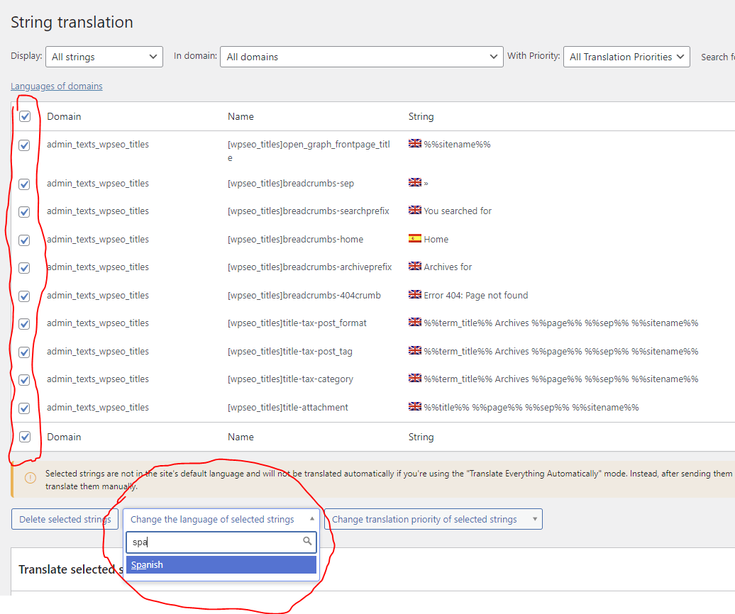

To change the original language for the strings, please follow these steps:
- Go to WPML > String Translation.
- Select the string(s) you want to change the original language for by - using the checkbox to the left of the string(s).
- Scroll down to the bottom of the strings list.
- Find the button "Change language of selected strings".
- Change the language of the string(s) to the language you want.
Please check the attached image (ex: in my case, I was switching from English to Spanish).
You can find some more info in this link: https://wpml.org/documentation/getting-started-guide/string-translation/how-to-change-the-source-language-of-strings/
Let me know if this works out for you,
Marsel

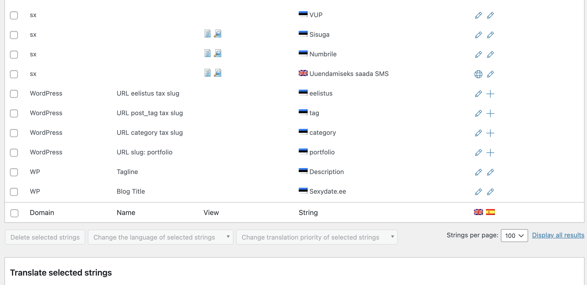

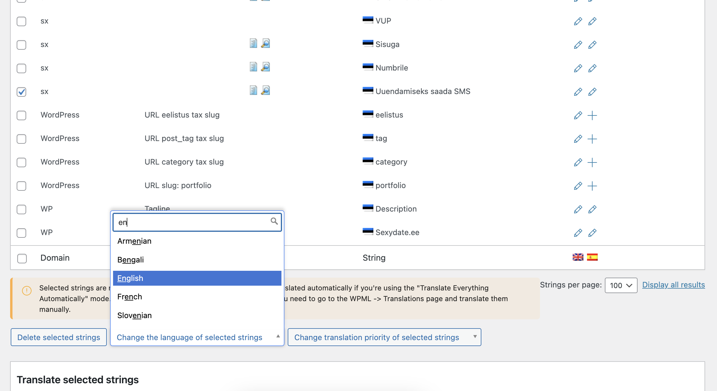

I tried to do it, and it changed the flag in front of the string, but the Estoninan word behind there I still can not change to English.
Here you see it in the attached screenshots.
How should I proceed to be able to change the word behind the flag as well to English?

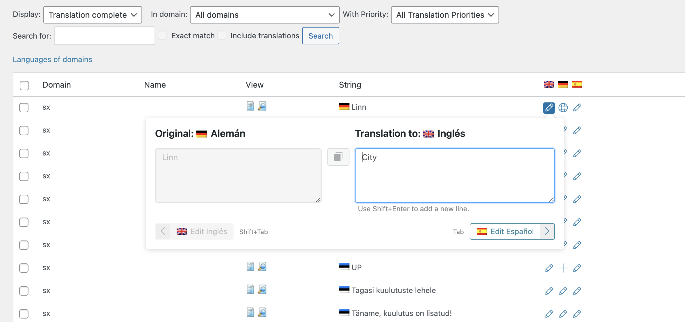

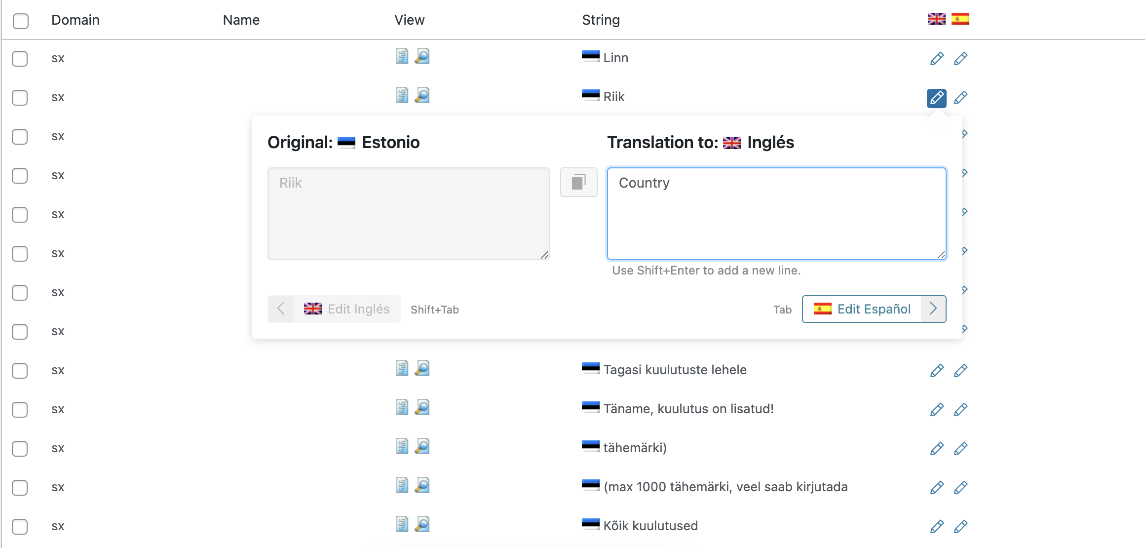

And the workaround is not working. I added the German language, then hidden it. And in the string translation still the word can not be changed. Like to see in the screenshots.

The idea of the workaround suggested, is to use the new added hidden language as a reference in order to give you to possibility to "translate/change" the original text from the theme/plugin. The newly added language will need to stay in order for this solution to work out as descibbed.
As I mentioned before WPML doesn't change the text of themes/plugins, that's why even in the new added language stays the same.
About you question related to changing the string source language on the theme, I would suggest you check with the theme author/documentation on how it was build and how you can achieved the string change.
