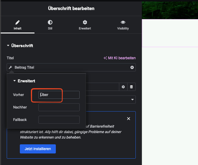

In Elementor im using dynamic "Post Title" field for displaying my post title in my templates. In the dynamic post title field i set an prefix "Über " - this prefix is not shown in ATE or in string translations, so currently i have no change to translate it in english which should be "About ". How to translate that? Check the screenshot vor better understanding what exactly i mean.
I already tried to search for the exact string in ATE and also in string translations but it does not appear

First, I double-checked on a local test site that this is working normally, that the prefix text is available for translation, and I can confirm that it is.
From the screenshots you can see I added a prefix "Aardvark" (I chose such an unusual word that it would be easy to locate if I had to search for it).
I then used the Translation Dashboard to send the Elementor template for translation (by me, manually).
When I opened the translation job in ATE, the prefix text was offered for translation.
So my first question would be about how you translated the template. Did you send it for translation via the Translation Dashboard? That is the recommended workflow for translating templates, and if followed it should work.
