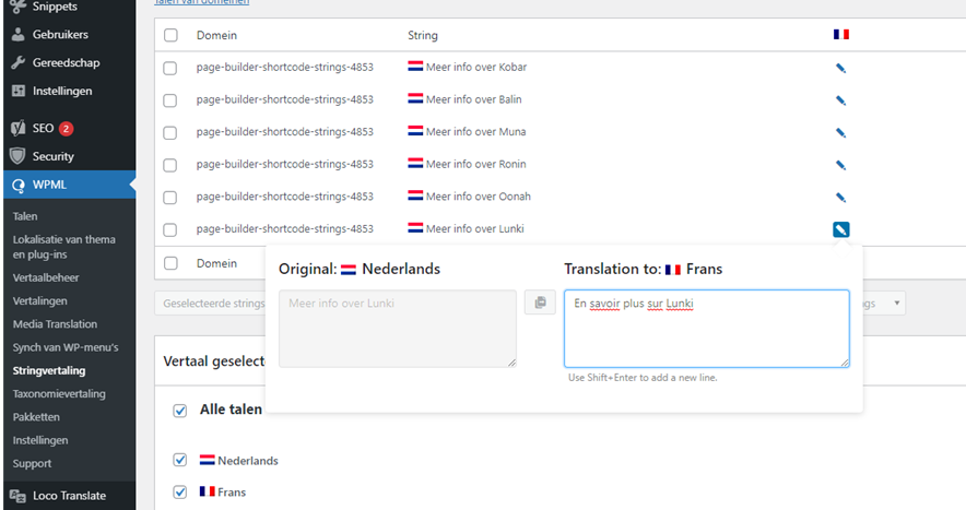

I'm trying to translate links from buttons made with Flatsome's UX Builder.
I can find those links in String Translation but as you can see in the picture attached I can only translate the text, not the url behind it.
How can I translate the link behind these buttons?
They look like this: [button text="Meer info over Lunki" style="outline" link="hidden link"]
November 1, 2021 at 4:07 am #9899885
Bigul
I hope you are following this tutorial for translating the pages/posts created using UX Builder - https://wpml.org/documentation/theme-compatibility/create-multilingual-websites-using-flatsome-and-wpml/
Please try with the following language configuration code and update the original language page & then its translation. After that check is there any difference in the results.
<wpml-config>
<shortcodes>
<shortcode>
<tag>button</tag>
<attributes>
<attribute>text</attribute>
<attribute type="link">link</attribute>
</attributes>
</shortcode>
</shortcodes>
</wpml-config>
Thanks!
