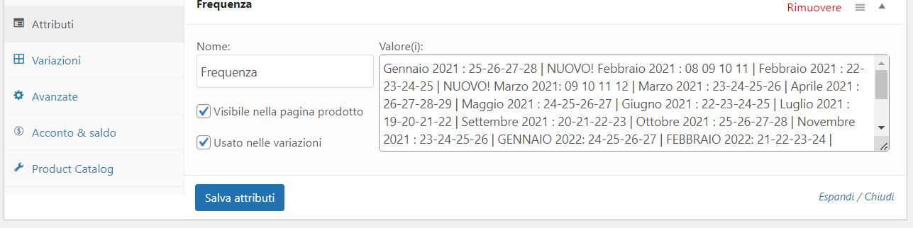

lorenzo
I don't find out how to translate the product attribute values.
I have already researched in your forum and in google, but without success.
They are not global attributes, but specific attribute for only one product.
I have already tried both the string tranlsation and the product management tool, but I dont find those variables.

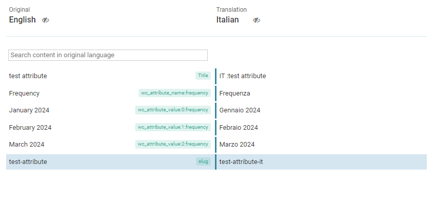

November 16, 2023 at 3:55 pm #14828555
Marsel Nikolli
Thank you for contacting WPML Support, I will be happy to help you today.
Can you please tell me how are you translating the products?
If you are using ATE you should be able to see the attributes on the editor (please check image attached).
Can you share any link of the product page, to better understand how/where those attributes are shown?
Kind regards,
Marsel

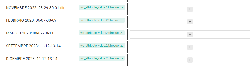

lorenzo
Yes you are right, I can see them if I open the product from the WooCommerce Multilingual & Multicurrency, but I have a doubt.
We did not use this tool to translate the products. We use to duplicate the page/ product from main language, then "translate it independently" and then use the page builder.
So now, opening the product from WooCommerce Multilingual & Multicurrency I can not see all my translation. And here the question. What if I translate only the variables and then I save them. Am I going to lose all the other translation?
thank you

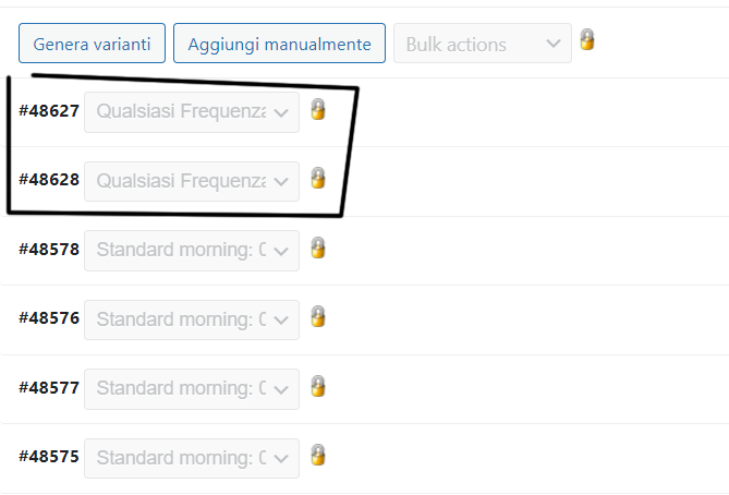

lorenzo
Hello, and thanks for replying.

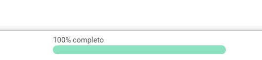

Even though for that product there is the gear, as you can see clicking it, the translation is 100% completed (see attachment).
And I think there is a bug in WPML because I discover this.

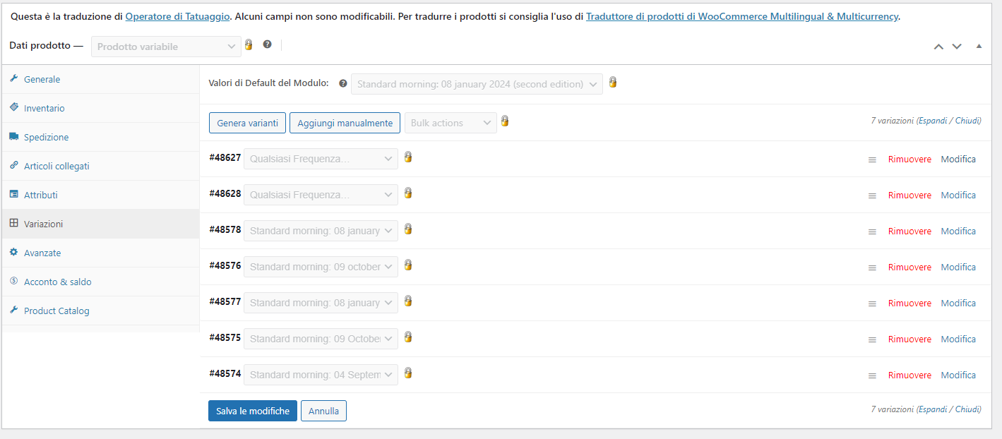

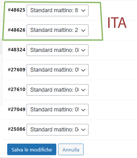

If you go inside the english product settings > Variation there are like always the locks, but notice that the first two variation are not assigned. I attached both the italian and the english screen.
thank you

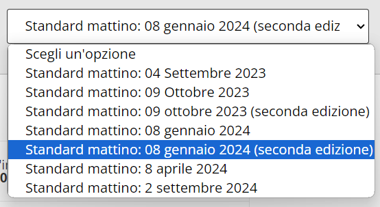

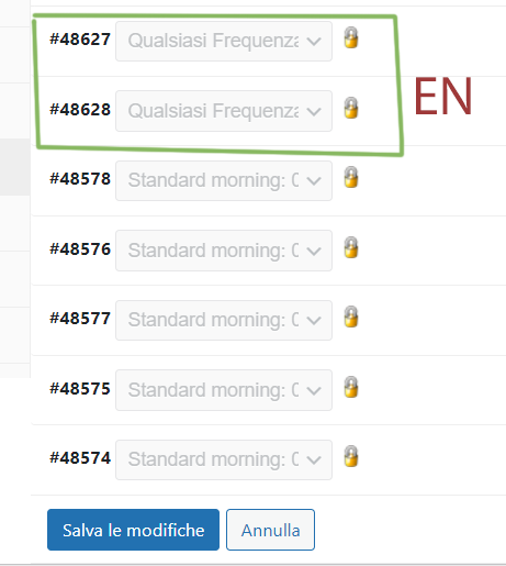

December 6, 2023 at 9:40 am #15005381
lorenzo

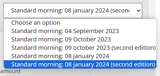

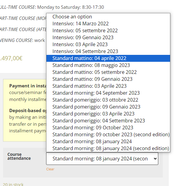

sory but I am still not seeing the two new dates of 8 april and 2 september on the english page, do you?. See attachment.
By the way the problem only occurs when variables are added to an already translated product. If it is a new product and the translation is done, the variables are all present.
My doubt is that looking at the backend of the English variables I see that they are not assigned. See attachment.
thanks
