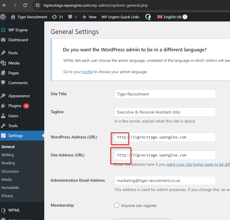

The client was experiencing an issue where the hreflang links were incorrectly using HTTP instead of HTTPS.
We recommended checking the WordPress Settings under Settings -> General to ensure that the WordPress Address (URL) and Site Address (URL) are both set to use HTTPS. We provided a screenshot to guide the client through this process. After making the necessary changes to use HTTPS, we asked the client to verify that the source code now reflects the correct protocol.

here's how you can see the problem:
go here, for example hidden link and view source
hreflang links are all like so: href="hidden link;
rather than: href="hidden link;

May 2, 2024 at 8:03 am #15586001
Osama Mersal
Thanks for your patience. The issue happens because the site URL is HTTP in Settings-> General. (Kindly check the attached screenshot)
I changed the URLs in the staging site. Please check the source code. (view-source:hidden link)

May 2, 2024 at 11:33 am #15586877
coralieF-3
Thanks Osama.
That's exactly what was causing the issue.
