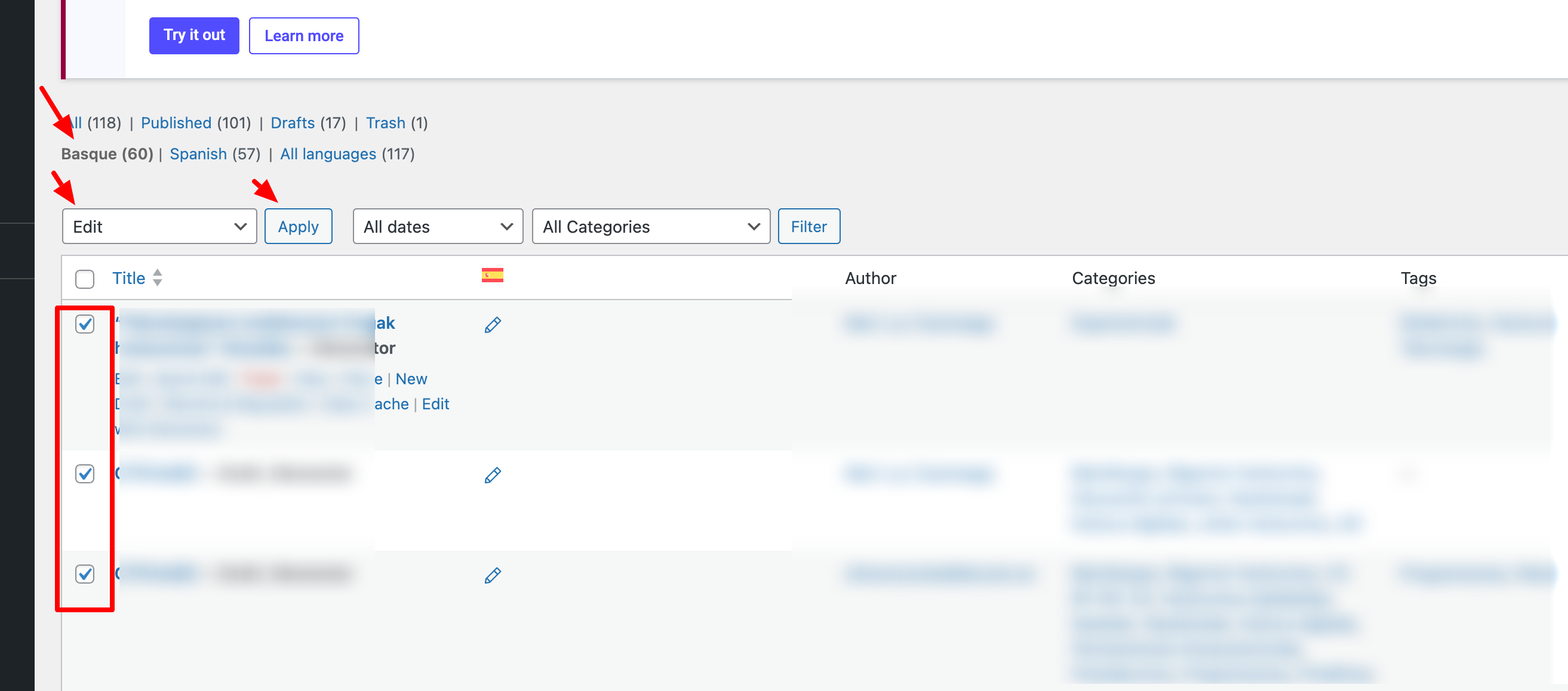

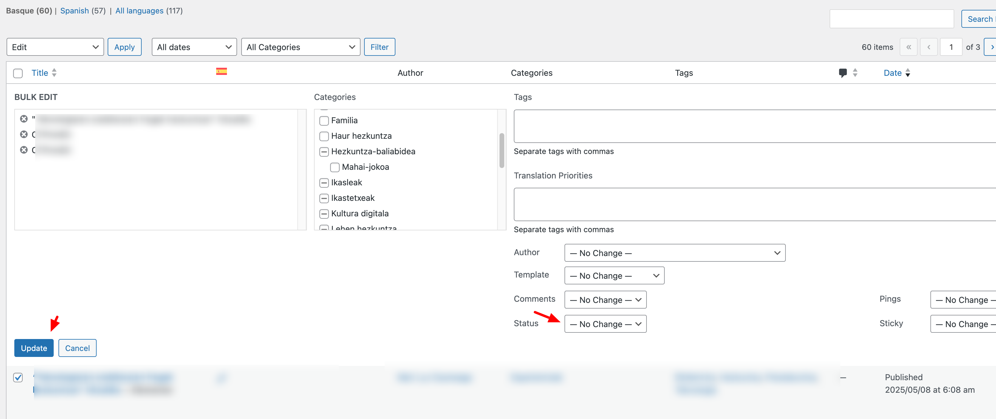

May 21, 2025 at 12:29 pm #17057143
Andrey
WPML Supporter since 06/2013
If all translated posts are in Draft status, you can try to choose them and edit them in bulk.
I have attached the screenshotы for your review.
