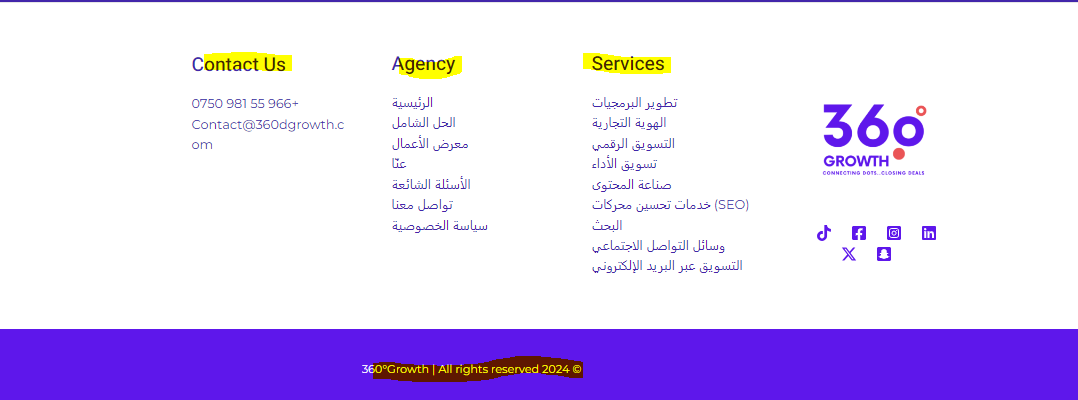

July 23, 2024 at 8:07 pm #15994369
Eslam Badr
I can't translate some headings in the footers section and copyrights section along with a CTA button in the headings. I tried to translate them from English to Arabic but when I do so it takes effect in both versions. The site is under development.
Translations for headings in the footers section, copyrights section, and a CTA button are not working correctly. Changes in one language affect both versions.
How can I translate headings in the footers section and copyrights section without affecting both language versions?
How can I translate a CTA button in the headings using WPML?

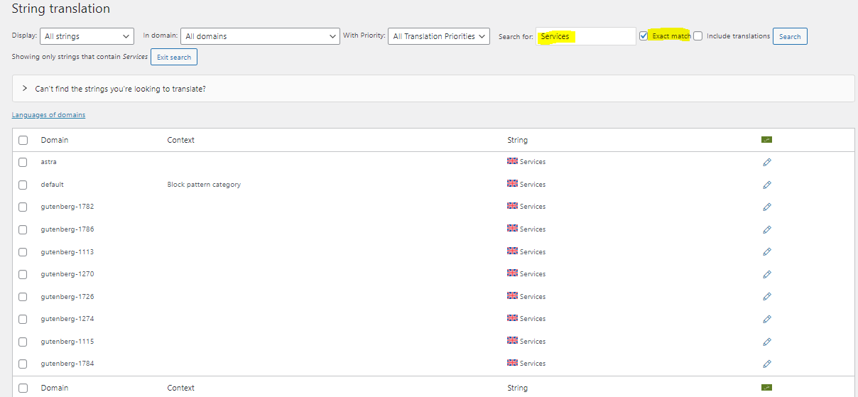

July 23, 2024 at 9:00 pm #15994809
Eslam Badr
Hi, Mihai,
Thanks for your reply. You're right it comes from a widget.

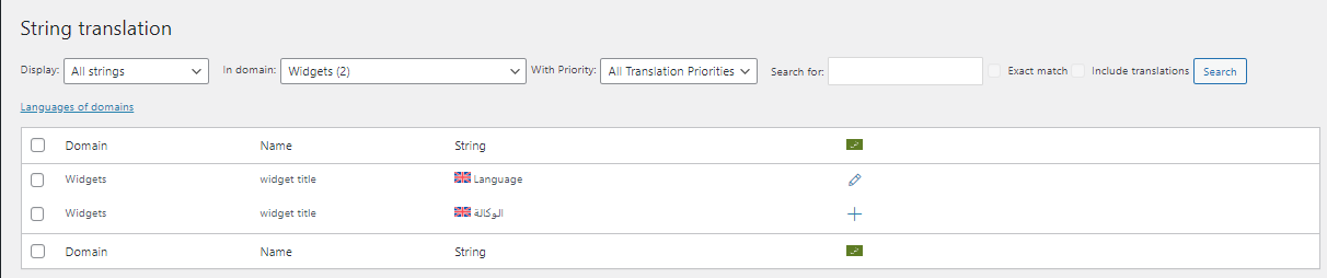

I searched for the word, For example, "services" like the screen with the exact match I got all of these words and I made sure all of them were translated but I still had the same issue.!
Please let me know if there an easy way to solve that.
Regards

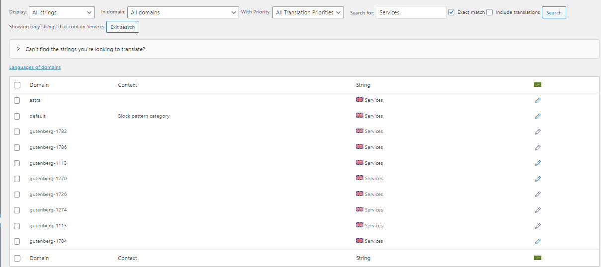

July 25, 2024 at 2:57 pm #16004293
Eslam Badr
Hi, Thanks for your reply.
I tried searching for it using the method you suggested but didn't find the header name that I needed to translate.
But, As I mentioned before I tried to search for the required word with an exact match and I found all the words and already made sure that I translated it.

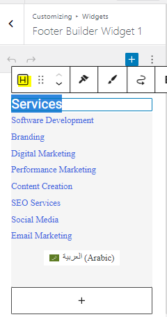

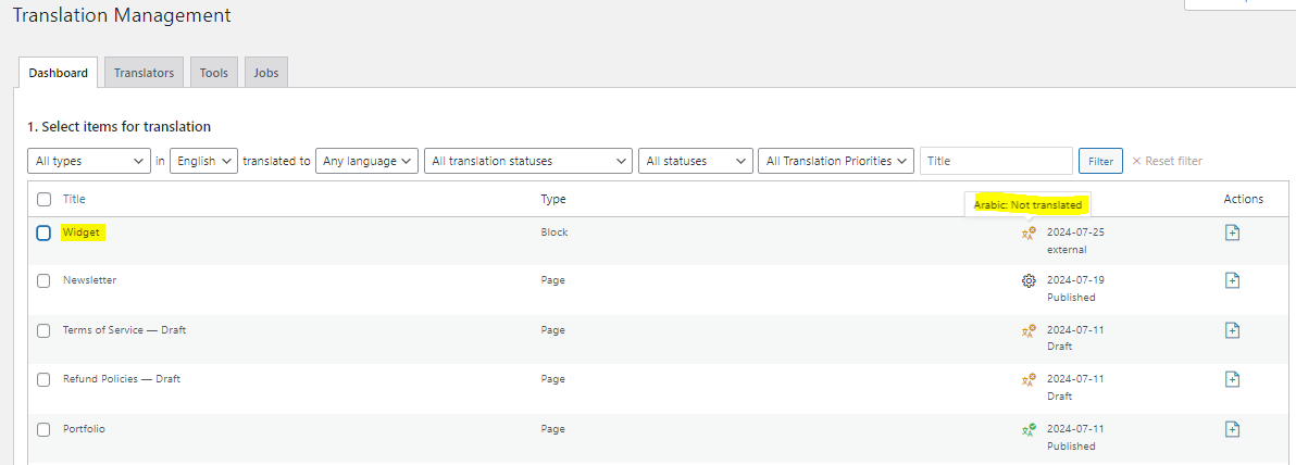

Just to confirm, The widget itself was already translated by the plugin but the heading of the widget is the one that I've an issue with. Please check the below screens.

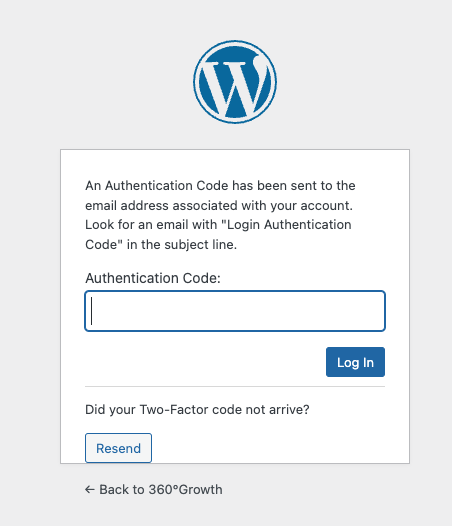

Unfortunately, I am not able to log into the site.
Also, that code might expire until I am able to see your reply so it would be great if we can disable that for this user or if we can find a way to disable that for now.

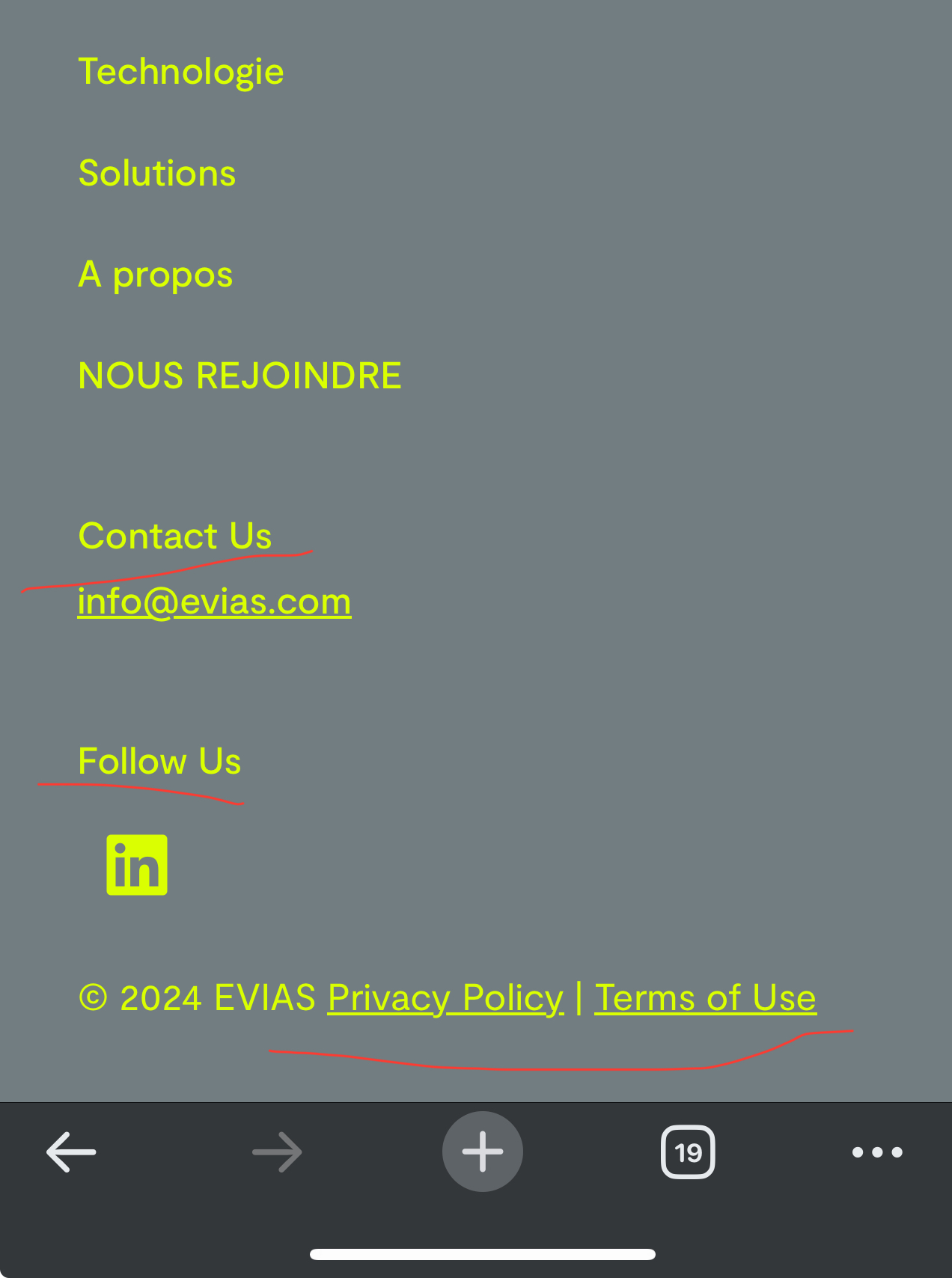

July 27, 2024 at 4:49 am #16010137
louisC-7
I am facing the same problem, my site is using theme called “twenty twenty four” and twentig plugin, I added french translations for the footer, but some parts not working.
I can find the the domain corresponding to wordings in “string translation”, i added french translate but still not working.

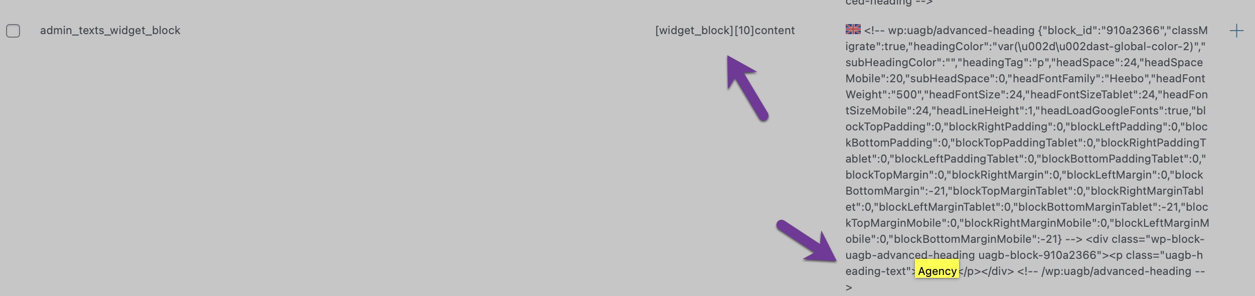

July 29, 2024 at 3:19 pm #16016877
Mihai Apetrei
WPML Supporter since 03/2018

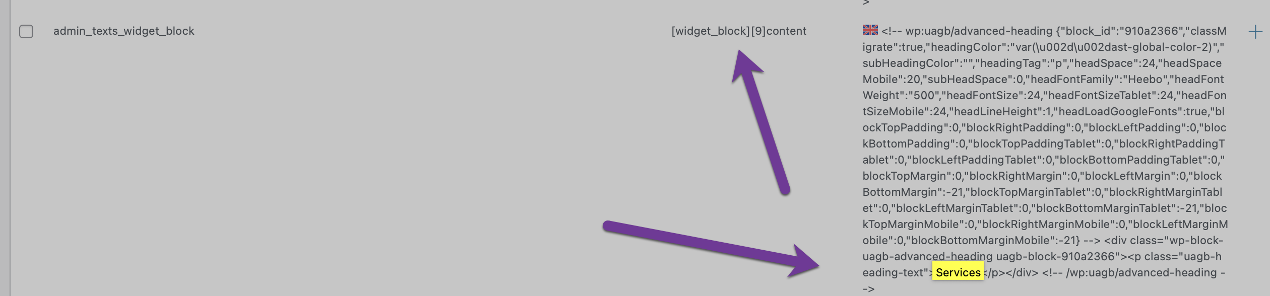

Hi Eslam, I'm back.

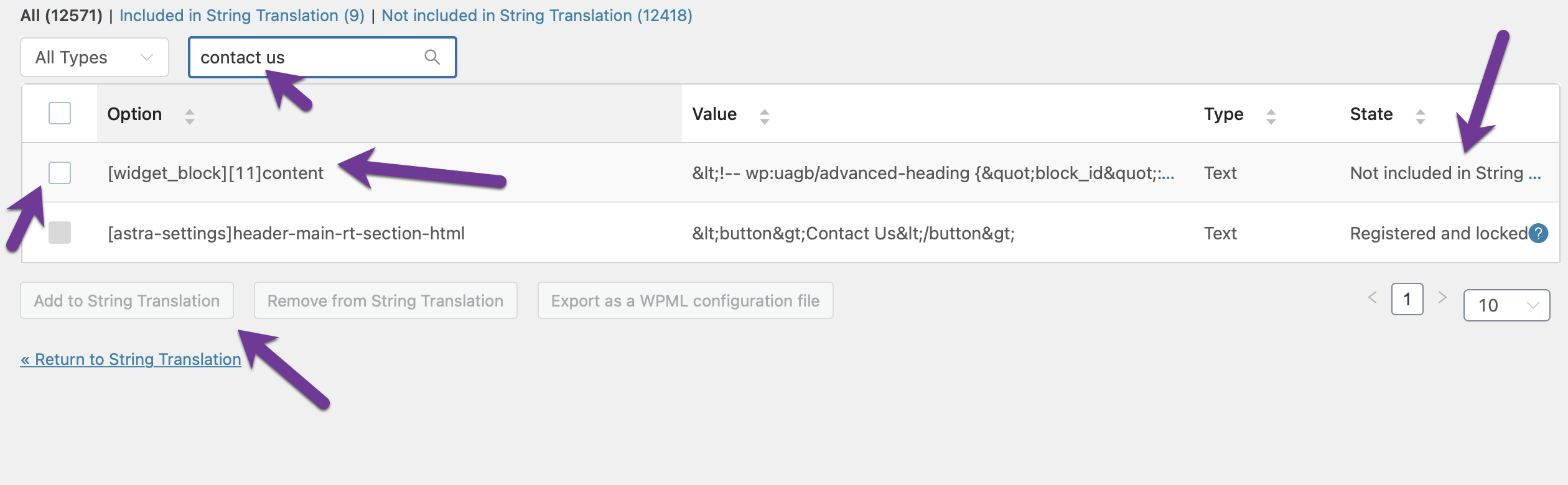

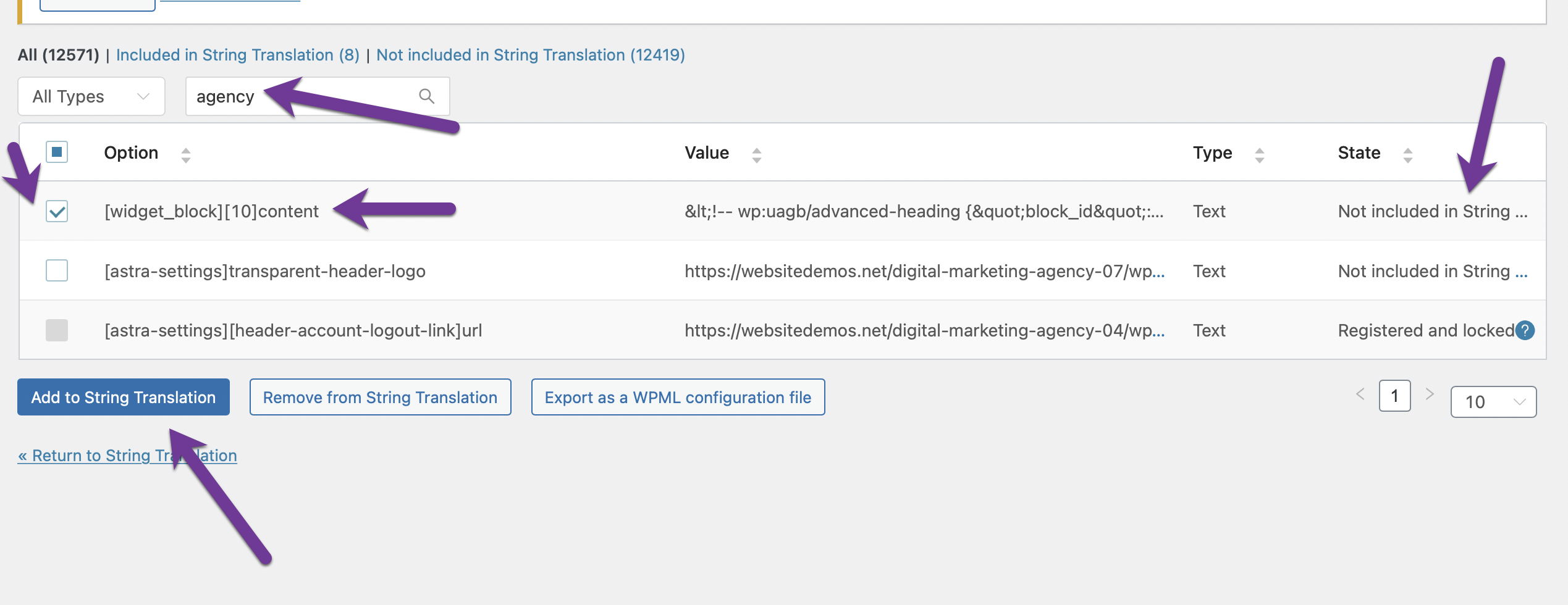

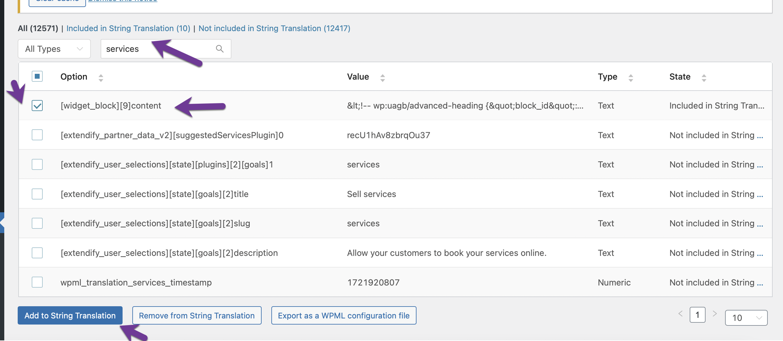

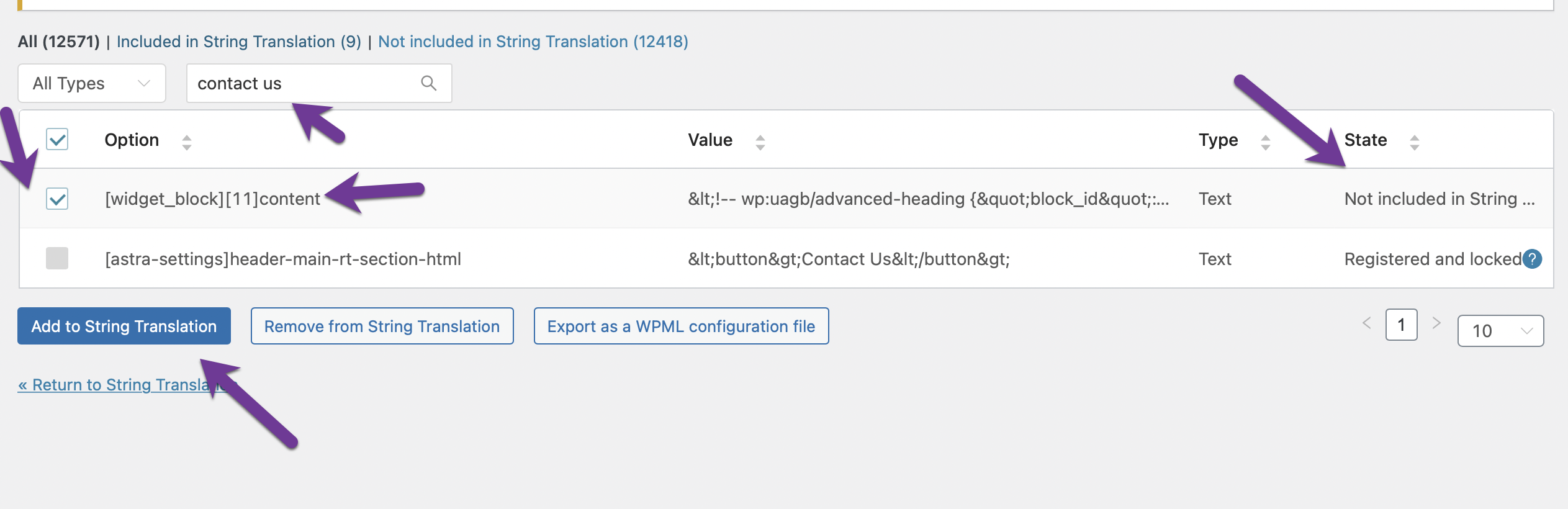

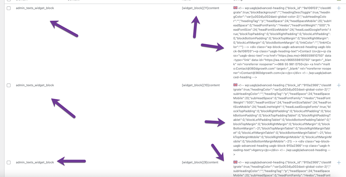

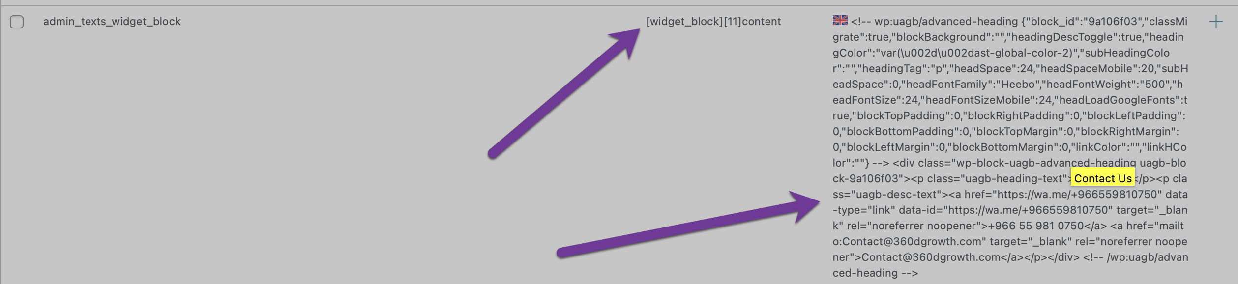

It seems that I was able to find the strings - I think those are the correct ones as they have the widget text domain:
They should show up at the top of that link now as I registered them by using method 2 that I shared here:
https://wpml.org/forums/topic/i-cant-translate-some-headings-in-footers-section-and-copyrights-section/#post-15994540
So you have to click +, then click the button in the middle so that you can copy all the code from the left area to the right area, and then you can translate only the word used in the title: Services, Agency, Contact Us
Please let me know how things go.

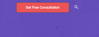

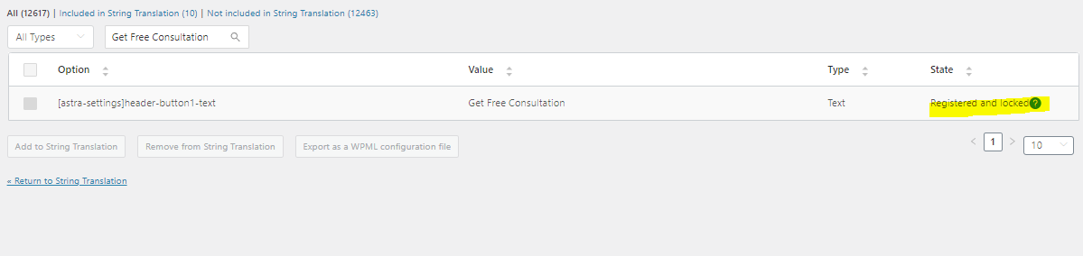

Just the last thing is the CTA button on the screen, I followed what you did and found that the string is locked. so can't add it to the string translation.
please check the screen.
