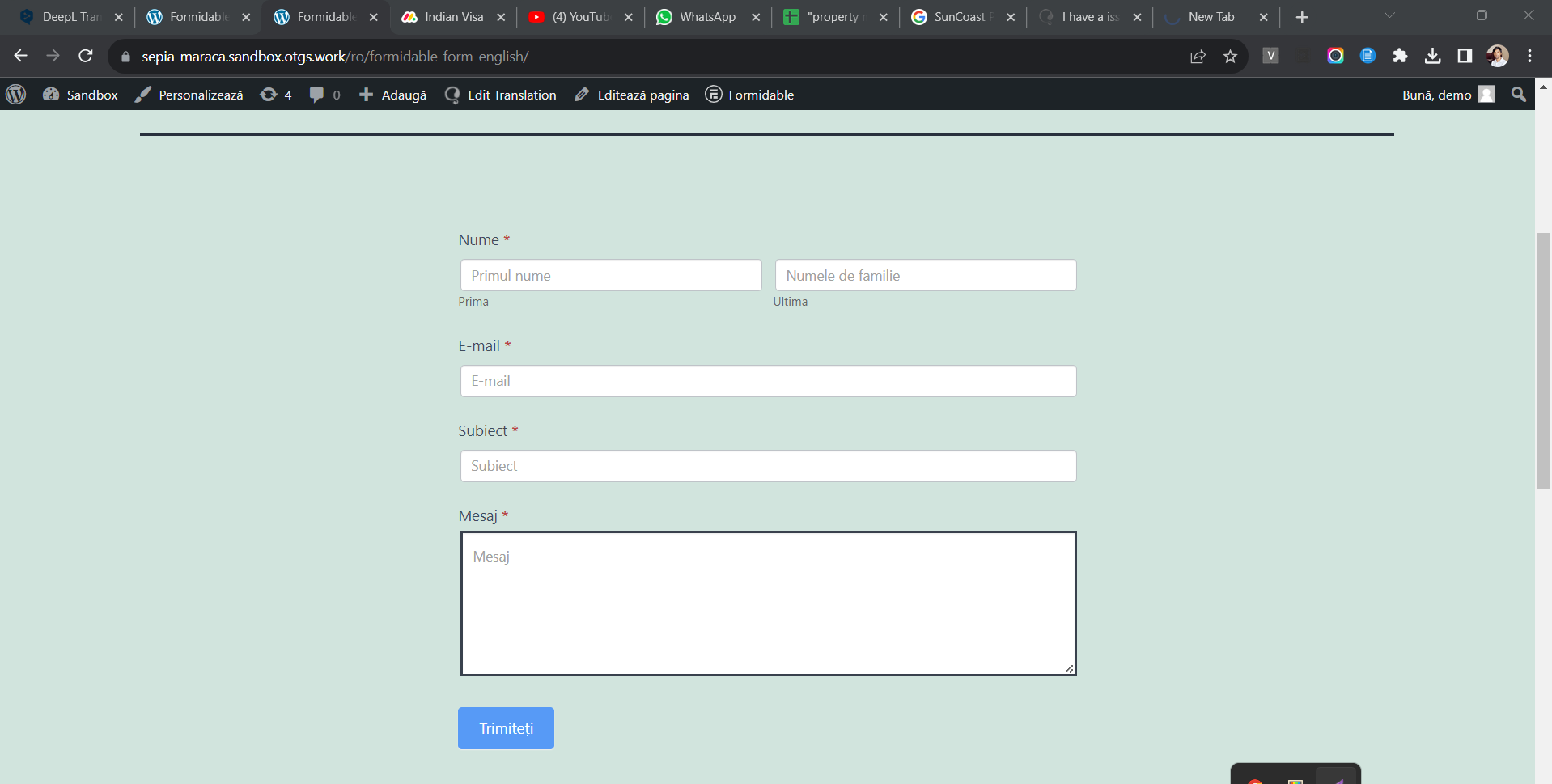

October 30, 2023 at 12:09 pm #14690773
noanL
I created a test formidable form on wpml server. It's work fine here.
Why not working for my site?
