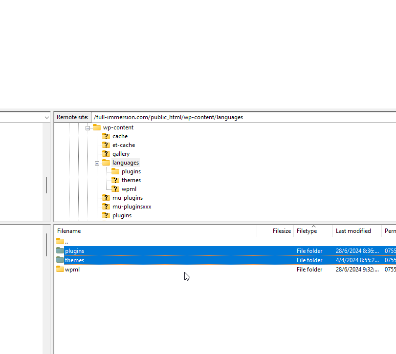

I hope you have a backup of the language files since we might need to restore it. Now, let's remove either one of the folders as shown in the attached screenshot. Remember to uncheck this option "Cerca le stringhe durante il rendering delle pagine"
June 28, 2024 at 3:31 pm #15853008
marcoG-31
Done, I deleted "Plugins", and deselected the option "Cerca le stringhe durante il rendering delle pagine". It now works fine on the frontend

Alright, it appears that there's a language file in the wp-content/languages/plugins folder causing this issue. To resolve this, you can restore the folder and gradually remove the language files one by one to pinpoint the problematic one.
June 28, 2024 at 3:39 pm #15853067
marcoG-31
I can't see your latest message here on the thread, only via email... I will reply here, the message says "Alright, it appears that there's a language file in the wp-content/languages/plugins folder causing this issue. To resolve this, you can restore the folder and gradually remove the language files one by one to pinpoint the problematic one.". The website is working fine without that folder, are you sure I need to restore and gradually test those 628 files one by one?
June 28, 2024 at 3:40 pm #15853069
If it's working fine, then, you can ignore it. have a nice weekend.
