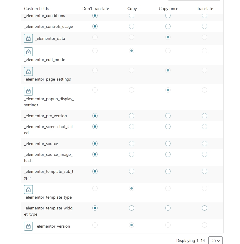

System fields such as _elementor_data should in general not be changed, as they can cause issues if translated or set differently as they are by default. I’m attaching a screenshot to show you how these are by default.
Also, type="link" will make internal links automatically point to the translated version of that post/page. Because of this, if you add these, they will not appear in the Translation Editor.

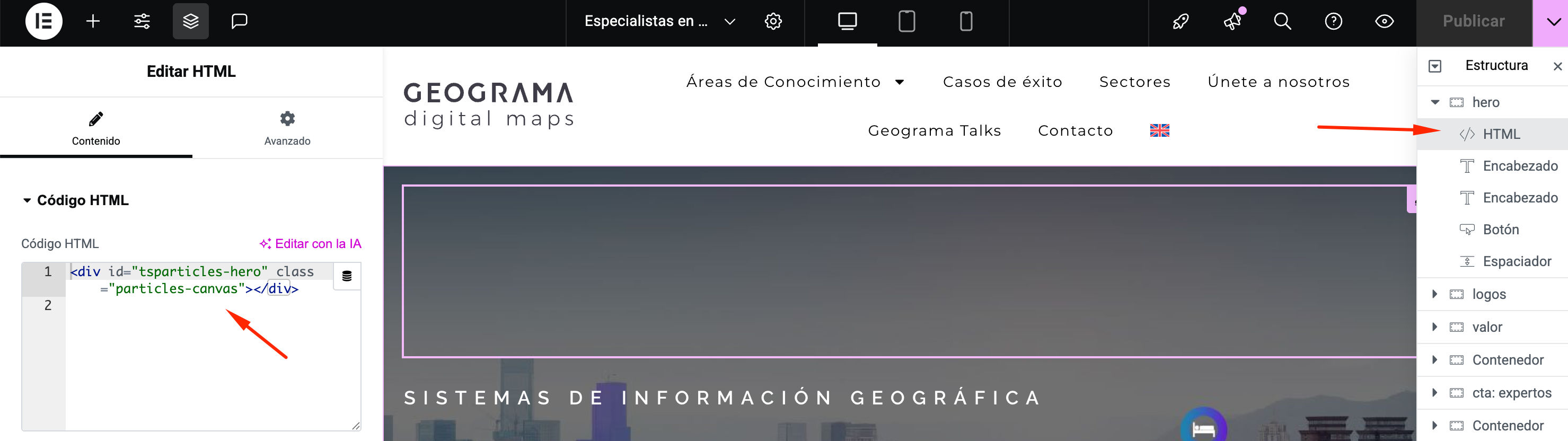

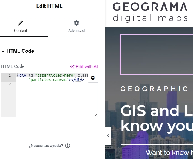

geogramaS
Yes, the HTML widget with <div id="tsparticles-hero"> is placed in the hero section of this page:
On the Spanish version you can see the particle animation in the hero, but if you switch to the English version it doesn’t appear.
Thanks,
Ellie 🙂

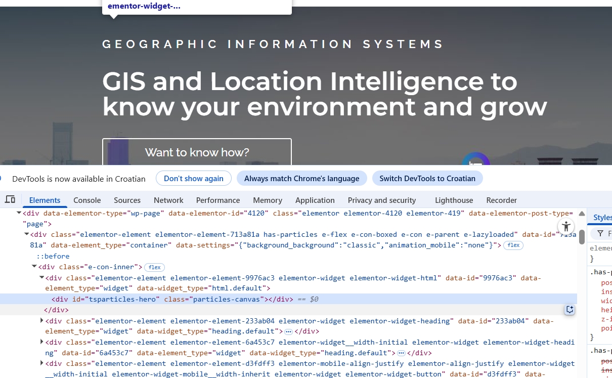

Bruno Kos
Can you tell me where the tsparticles-hero comes from? Is it part of a code package, a post, or maybe a template?
I noticed that the English page actually has it, but for some reason, it doesn’t render on the frontend. I also don’t see any errors in the browser console.
October 3, 2025 at 12:38 pm #17454425
geogramaS
Thank you for checking this in detail. I’ve just realized the issue was that my enqueue code in functions.php was limited to the Spanish page ID only (419). The English page has a different ID (4120), so the script wasn’t being loaded there.
I’ve updated the code to include both IDs, and now the particles are showing correctly on both versions.
Really appreciate your time and help in debugging this!
