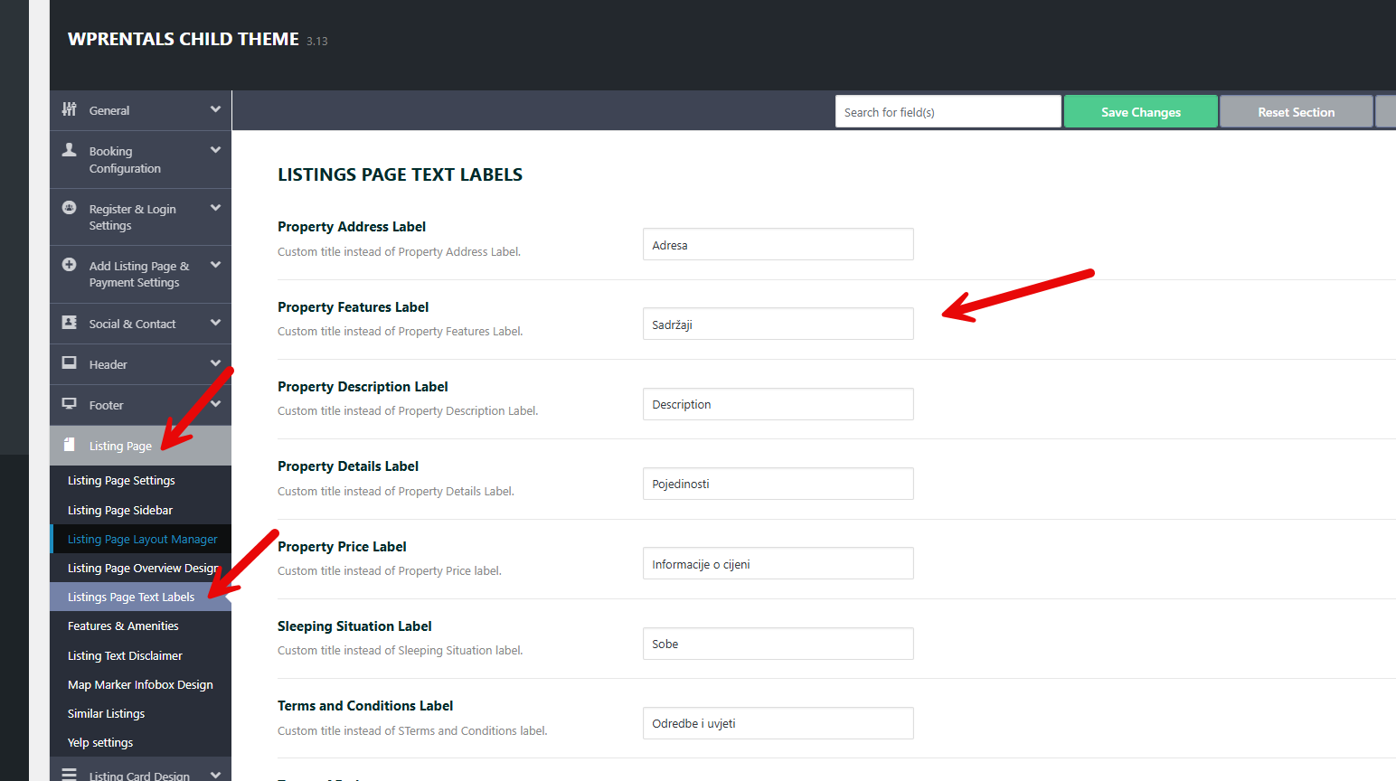

August 18, 2025 at 3:14 pm #17328409
vladimirM-19
Hi Kor,
Unfortunatelly we see it changed, now to Croatian, see image

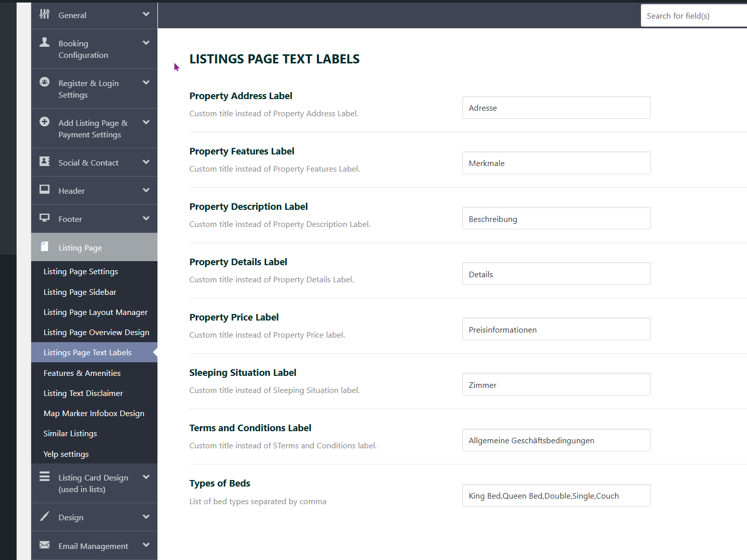

September 9, 2025 at 5:14 pm #17388322
vladimirM-19
Hi Kor,
Yes it updated again, you might also notice now its a mix of Croatian and German... :/

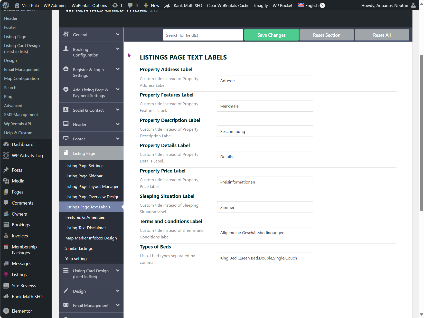

September 13, 2025 at 9:57 pm #17399549
vladimirM-19
Hi Kor,
Just checked, changed again. its German now.
