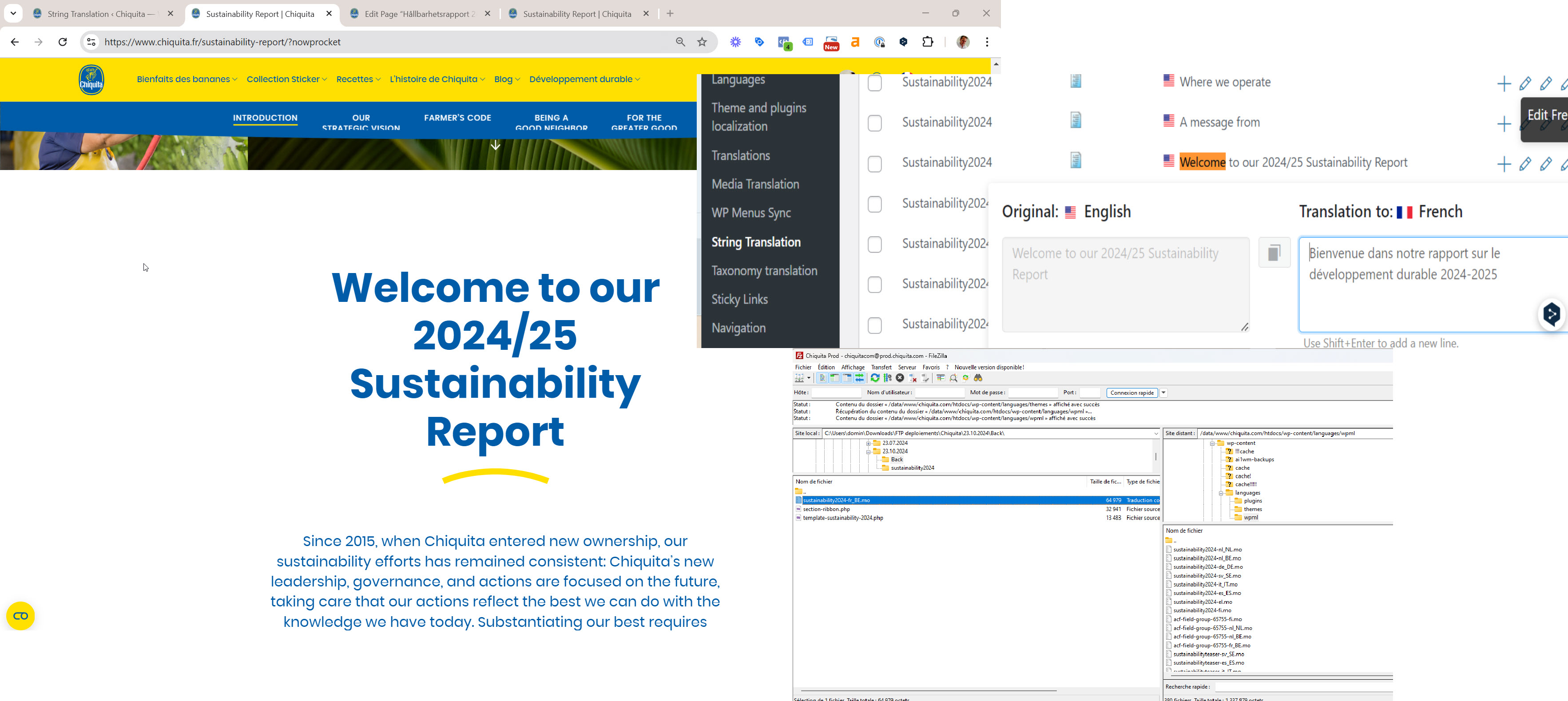

I use WPML string translation and have been using WPML for 8 years. I am trying to display the French translation of a string on the front end, but it does not appear. The string is translated in 9 languages and is visible in the WPML String Translation panel. I found an article that seems to describe the same issue: https://wpml.org/forums/topic/string-translations-not-working-for-one-language-despite-added-in-wpml-string/. I followed the process described there, but nothing changed. I removed the 'sustainability2024-fr_BE.mo' file from the folder root/htdocs/wp-content/languages/wpml, but the issue persists. The issue can be seen on this page: hidden link. I expected to see French text on this URL, but instead, I got English text, which is the default language.
The French translation of a string does not appear on the front end, and the English text appears by default.
Why does the French translation not appear on the front end?
What steps can I take to resolve this issue?

I reviewed the conversation you had with my colleague, Noman, and I understand the issue. To investigate further, could you please let us know which template file contains the text in question?
I also noticed something unusual: when switching to French and updating the slug of the French page, the change affects the English page, causing an error. It seems the French version is acting as a duplicate of the English page, so any changes made there impact the English version, and the French page continues to display in English. Could you please delete the existing French translation of the page from the site, including from the Trash, then re-translate the default page into French and check if the issue persists?

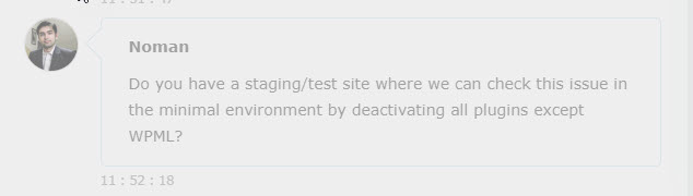

Additionally, I noticed that French is set up as a custom language on your site. Could you verify if the issue occurs with the default French language?
Since the site is live, it would be ideal to set up a staging environment where we can test and debug without affecting your production site.

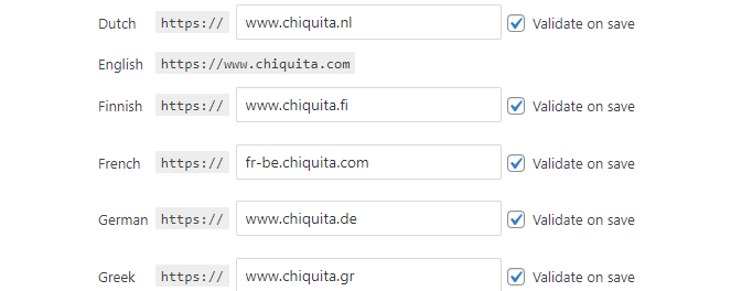

Thanks for your replay, from this morning, the FRENCH language (whole french) is not available on the website, we loose all the french content. Previously the french was in the position in the menu and now is on the last item, and we are not able to load every french we are redirect to the EN language, It worked yesterday, and we do nothing to change that.
May you revert your change please

So I updated back this change doing in FR website, and the french goes back.
